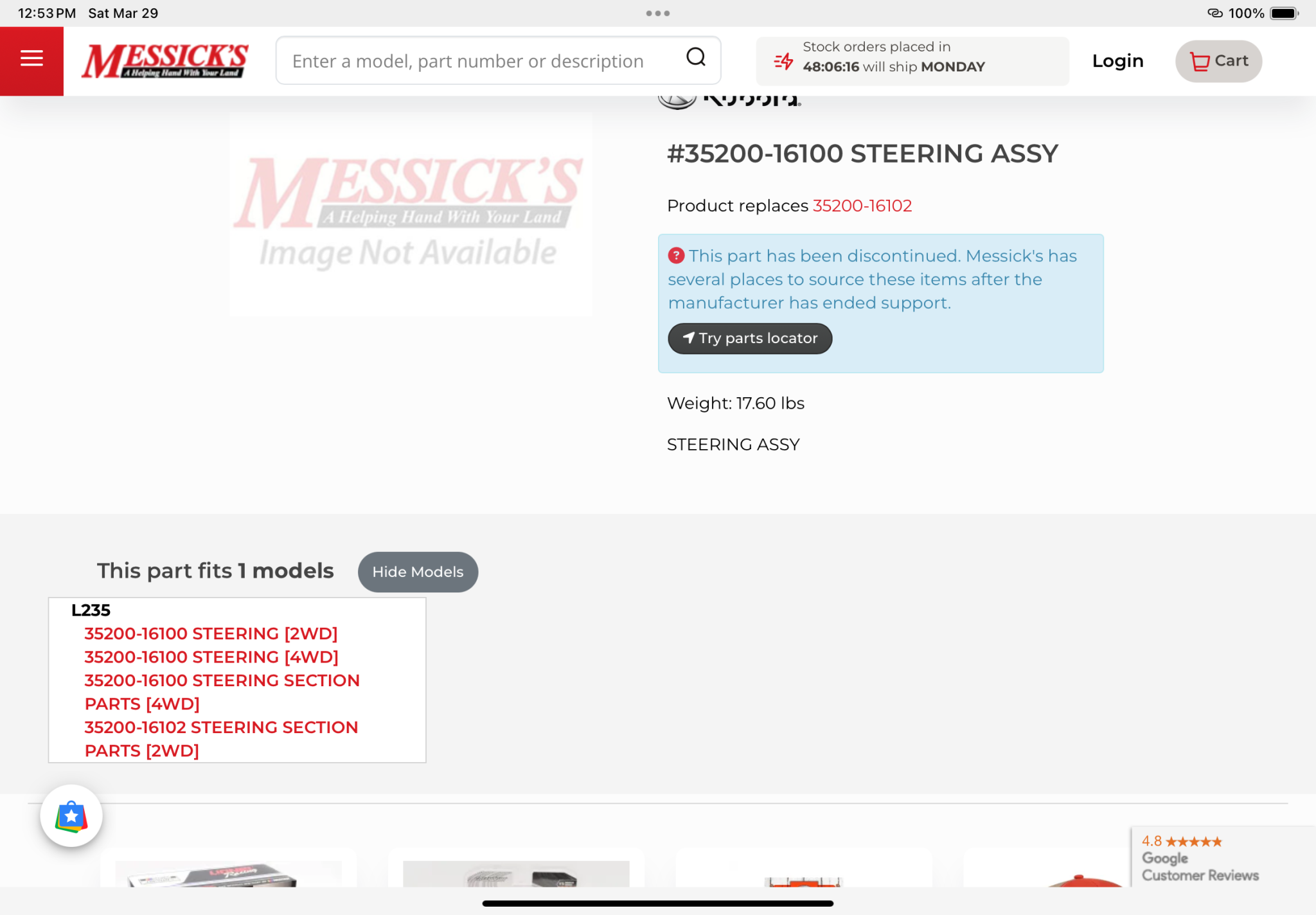

You don’t say if it is 2WD or 4WD so I assumed the 2WD version and looked at Messicks parts site
It appears that the assembly is discontinued and was only for the L235
You can try to contact @007kubotaguy to see if he has any assistance for you (used parts salvage) or see if these people can help

Did you look at Messicks to see? There are manual and power steering and bot fit a few other models (according to my 5 minutes of research)
