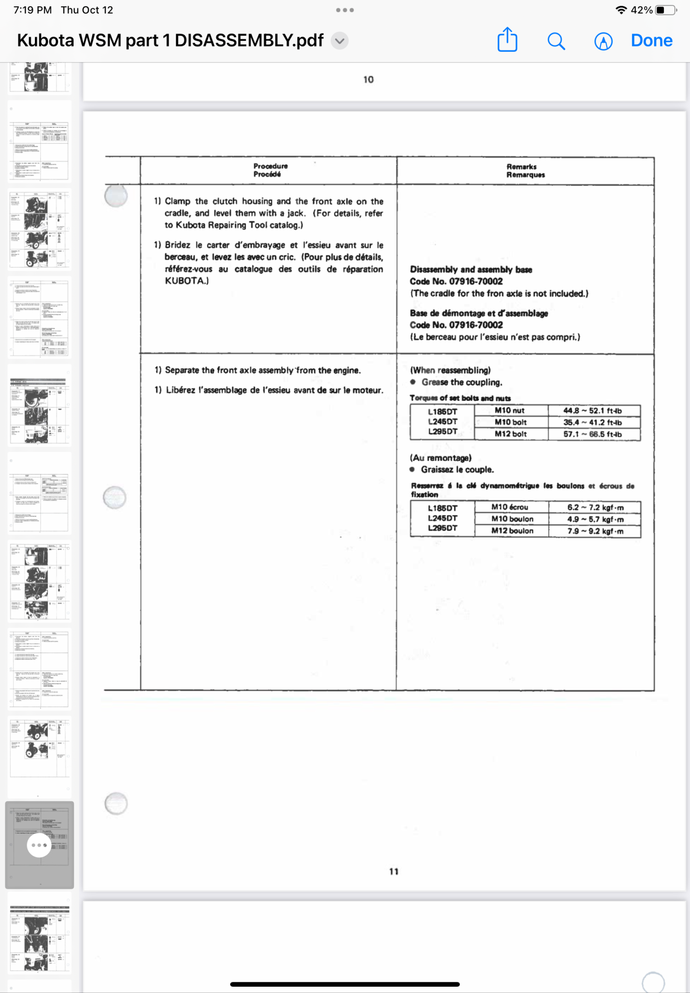

i had to remove the front frame from my Kubota L225DT to do some repair work and am looking for the torque specs in reinstalling the 3 bolts and 2 studs that hold that front frame to the engine block. Appreciate any input.
