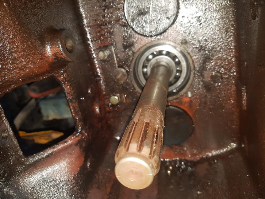

Hi all i gave a l1500dt when i bought it it started crunching gears the clutch adjustment was screwed all the way out so iv split the box the clutch doesent look to bad itself there was also some oil in the belhousing looks like box oil i think so the seal must be leaking but i also found a hand full of ball bearings in there i cant work out where they came from also can anybody tell me what gearbox oil and also hydraulic oil i need for it cheers

Did they come out of the release bearing?

Just by looking at that picture, your missing a seal.
Where are the rest of the parts for the clutch and throw-out bearing?

Nah there not out of thrust bearing and the plate with seal i have taken off to change seal also anybody in aus know where i can get clutch parts in australia or shipped over at a good price cheers
