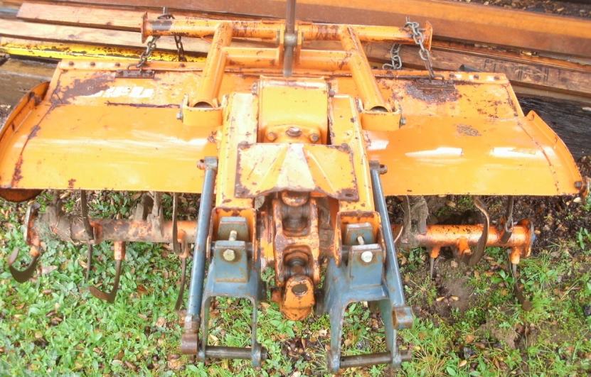

Hi, Bill.
I have tiller, mower, and blade that came with tractor when I bought.
I am try to find out about tiller model and availability to buy some parts.
It was working condition and all connecting devise are intact and previous owner wrote 1501 number on the top of tiller
But in later discovered one side shift is missing and leaking oil from shift. Other than that it is good condition and usable.
I was not interested to repair the tiller because I have small garden and having BCS 715 tiller that is enough to tilling my garden.
But whenever I saw the poor tiller lay down on the ground It makes me sad :(:(
Hopefully, I can fix then sell to person who needed
Thank you
John

Perhaps someone here on OTT can help I have not a clue about
grey market tillers :confused:
Sorry can not help on that one.
No problem Bill.
Thank you for reply anyway. will forget the tiller.

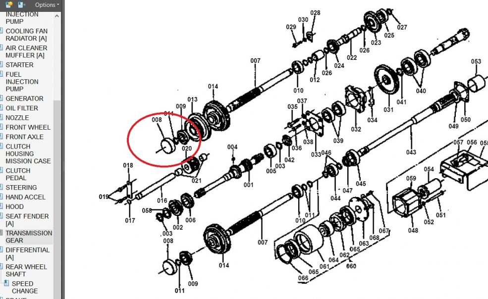

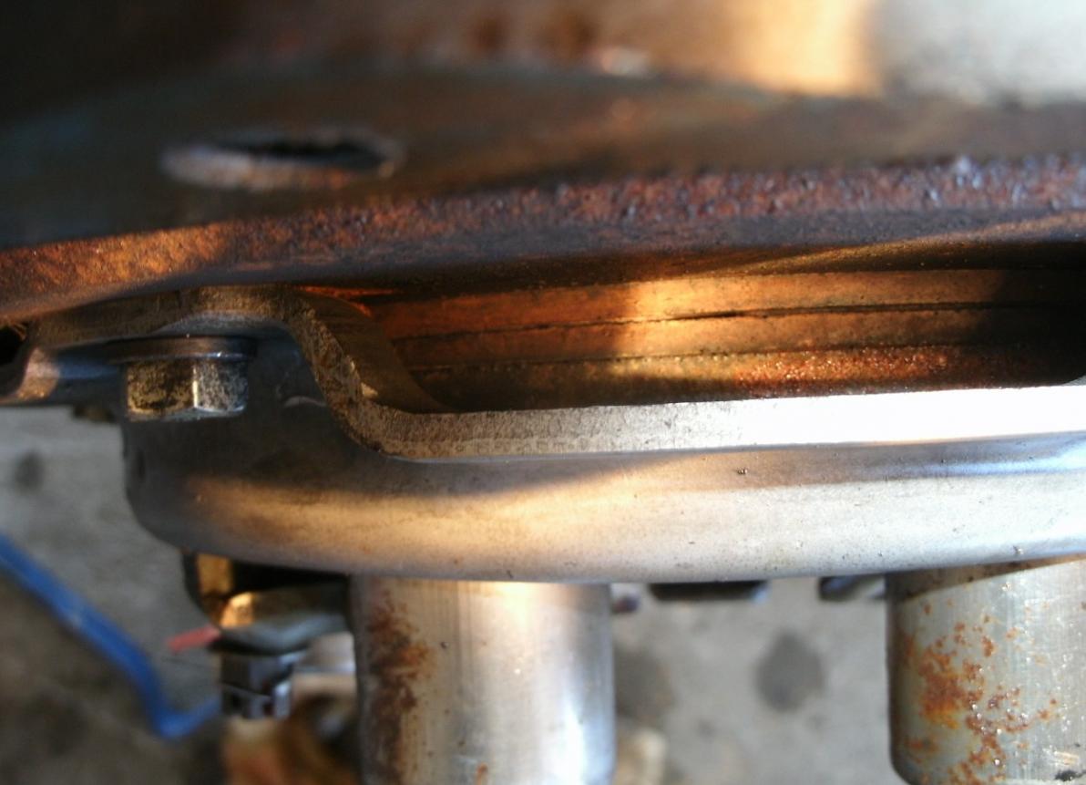

1} any members can tell the clutch disk thickness(picture1) and it is ok?
2) the inside clutch housing has 2 rubber caps far transmission side(picture2) What are they? Should I replace them too?
Your help will be appreciated.

As far as the clutch disc you probably just need to measure it, and compare it to the thickness either 1 in the book if it is in there or
2 to a new one
The rubber plugs do not need to be replaced unless you are either replacing any of the shafts in the transmission or if they are leaking.
I'll check when I get home and see if I have the measurements for the clutch disc I'm not sure if it's in the book or not.

Hi, Bill.
Thank you for replying.
I found the disk thickness requirement (If less than 0.3mm (0.012
inch) of facing remains beyond rivet heads, renew clutch disc)
Do you have rubber plug part number?
I couldn't find it from L175 parts book.
Thank you so much your help.
Found the rubber plug(bearing cover) part number at transmission gear section in parts book.
The part number 34150-21650
Question is that plugs are 40 years old and concerning leaking oil near future.(I really don't want to split the tractor again :):))
So while the tractor is splitted, I like to replace both of plugs, seal o ring as well even clutch disk.
Do I have to access to the transmission housing to replace the plug or just take off from clutch housing then replace it?
Thank you
There is no access from the transmission side, the bearings prevent that.
The plugs were a very tight fit when I replaced the main shaft
and a PITA to get out, but it was do-able.
I understand wanting to do it while it is apart, and I probably would also.

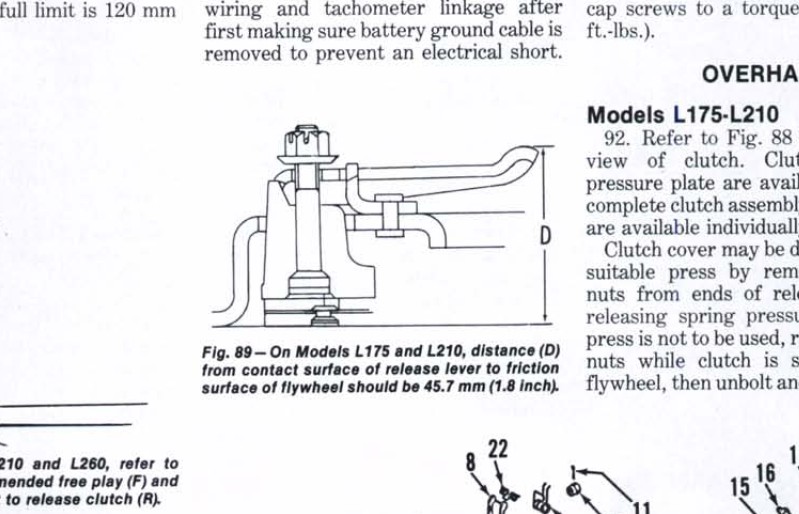

Finally replaced all seals in the clutch housing and clutch disk only.
Now having problem the clutch.
Since replaced clutch disk only, the clutch pedal is very soft and weak and couldn't engage any gear even adjusted between the release lever and release bearing as recommended.
Is this problem came from the only disk replacement?
Should I replace clutch Assembly include pressure plate together?
This is first time big frustration since acquired the tractor.
Thank you
John

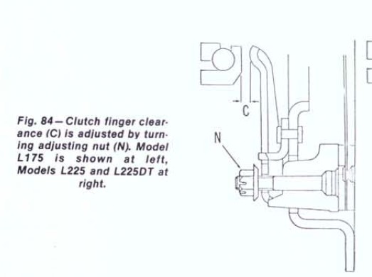

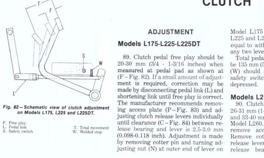

Finally figure out what was problem.
It was my fault that didn't follow up to the manual.
What it is that from contact surface of lever to friction surface
of flywheel equals 45.0-46.5mm.
So turned the adjusting nut to clockwise almost end meaning the release lever move to the release bearing
then adjust the clutch pedal as described on manual.
The clutch works perfect.
Hope no more leaking any oil
Thank you:):)

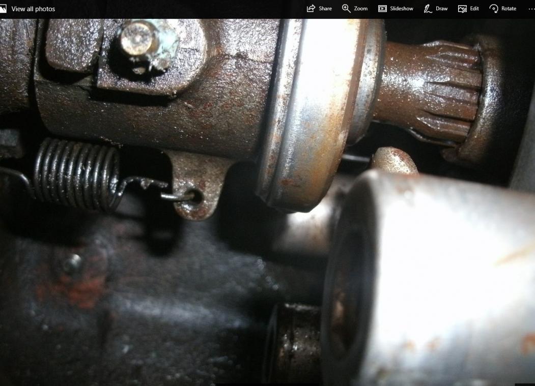

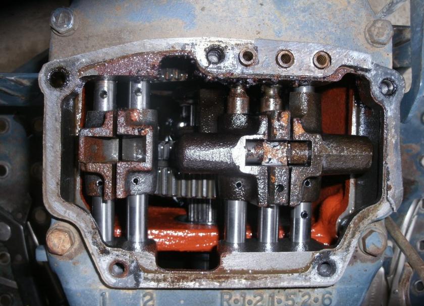

Is this a picture of your transmission?
If it is, the balls will be under the 3 springs on the top.
and transmission in neutral and shifter in neutral will let everything line up.
That is a picture of my transmission except I have worn grooves where the shifter contacts them. I don't have any gears engaging anymore' trying to find replacements for my L 1500 DT.
My son's buddy is a mechanic at a Local Kubota deaper that is trying to help me out.
