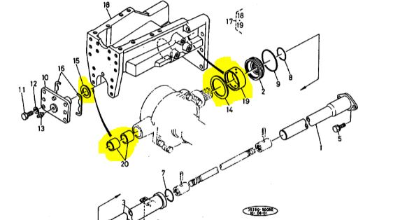

I have a Kubota L 235 that is difficult to steer. It has a manual steering gearbox that seems to work fine. When I jack the front wheels up and shake things the whole front end is slipping back and forth 1/2 inch or more on the pivot pin. Is this my problem and how can I correct it?

Don't think it has anything to do with hard steering, but you'll need to drop the front axle and if lucky just replace the bushings.

It does have a loader no ballast box but does usually have a rear implement as well. Any advise on fixing the slope the front end moves straight forward and straight back? Is that a bushing or what causes this? Can it be shimmed to fix? I have never saw one apart. Any advice appreciated.

The front to back slop is most likely wear in thrust collars #14, #15.
You'll also need to check wear in #19, and #20
