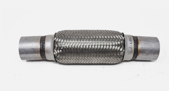

D David Jakubowski New member Equipment LX2610, BX24, GL14000 Nov 3, 2025 1 0 1 Pomfret, CT Monday at 3:11 PM #1 Good afternoon. I have a Kubota GL14000 diesel generator and love it. Has anyone installed an exhaust extension on the unit for through-wall installation? If so, what did you use to accomplish this?

North Idaho Wolfman Moderator Staff member Lifetime Member Equipment L3450DT-GST, Woods FEL, B7100 HSD, FEL, 60" SB, 743 Bobcat with V2203, and more Jun 9, 2013 34,093 9,283 113 Sandpoint, ID Monday at 8:53 PM #2 I've done similar you can use steel pipe just add an flexible joint into the mix. Reactions: 1 user
