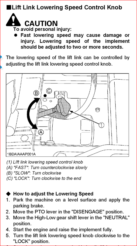

Just bought a Kubota F2880 Front mower. Looking for any shop or operator's manuals. Any previous links on this forum appear to be dead. Thanks in advance. The deck is dreadfully slow to lower. Does anyone have any thoughts on what the problem may be? It rises quicker than a SpaceX Falcon 9 but seriously creeps when lowering. Could it be a priority valve somewhere in the hydraulics? Thanks again! Go Orange!!

See if this helps :
