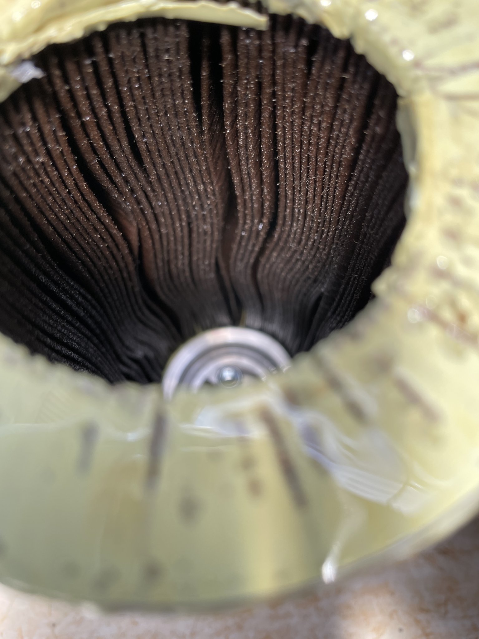

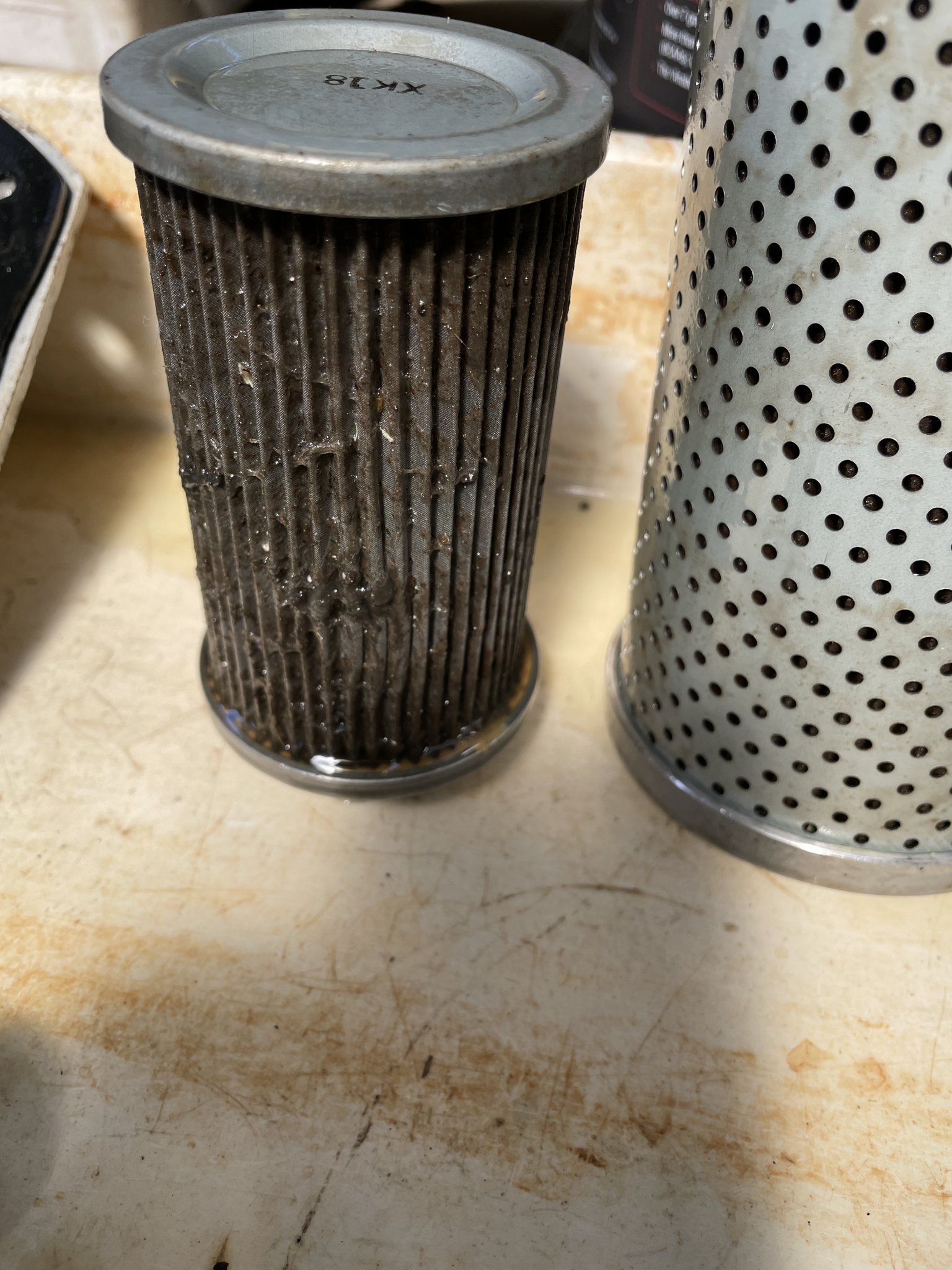

I drained the hydraulic tank and removed the filters. Both were dirty. The return filter had actually pulled apart from the pressure of not being able to travel through the filter.
Filters have been ordered. I'll update when i have them in.

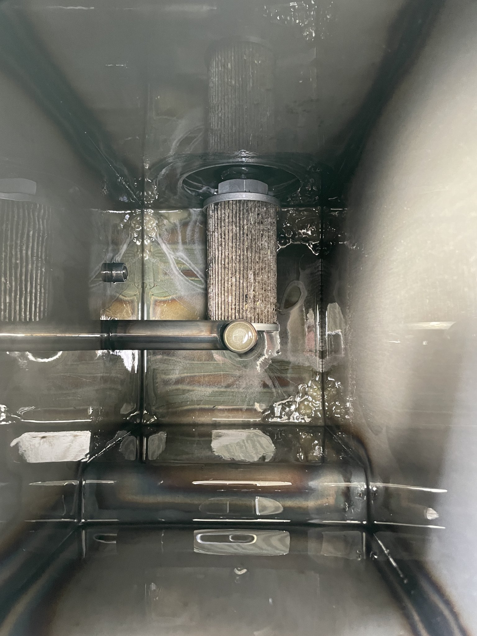

There was some gunk at the bottom of the tank and the oil does go creamy when the pump is running. I'm guessing this means there's some water in the system. It goes translucent again once it has settled for a while.
What's the best way to flush the whole hydraulic system so I can give it a good fresh start?

'best' way ? to clean the rest of it...
Buy an extra 5 Gallon( ?) bucket of oil,
toss it it with new filters,
run for say 10-15 minutes,
full cycle every lever 4-5 times,
idle down,
shut off,
drain/remove all the oil,
inspect/clean the new filters ( or just replace ),
wipe out any remaining oil on the bottom of the tank,
install filters,
add oil,
and you should be back in business.

You have (had) a restriction on the suction side of the pump. Aeration.
Just to keep it clear in my head, would aeration be when air gets sucked in and mixed with the fluid? In this case it seems that the fluid pressure got so low, due to the suction, that it boiled and formed the bubbles (creamy) and when the fluid returns to ambient pressure, it becomes clear again. Unless I am missing something.
33,903
9,121
I would vacuum out the sludge in the tank!
Your not doing any favors leaving it in there.
Other option would be to first rinse the tank out with Diesel, followed by Denatured alcohol and completely drain and dry the tank.

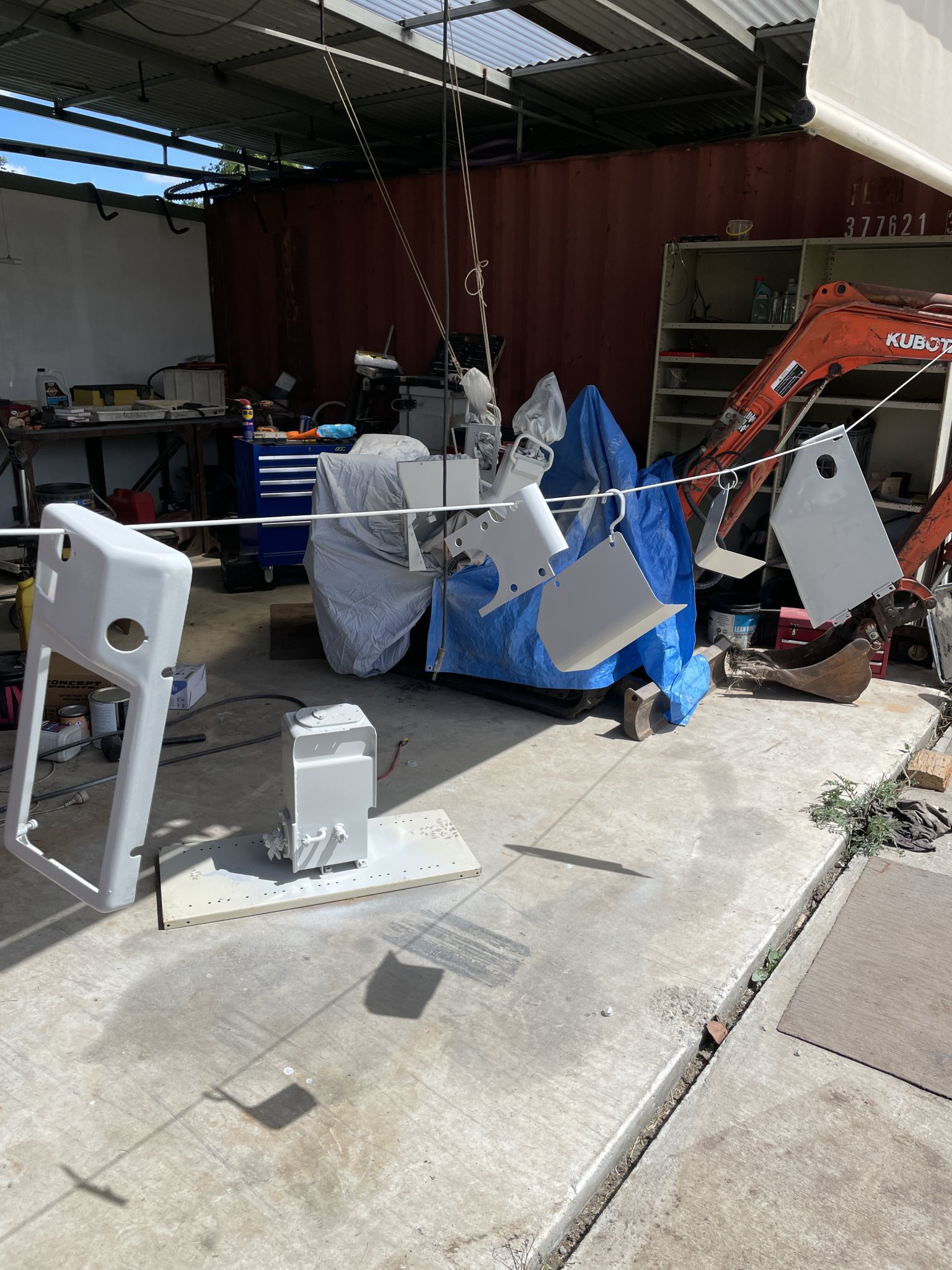

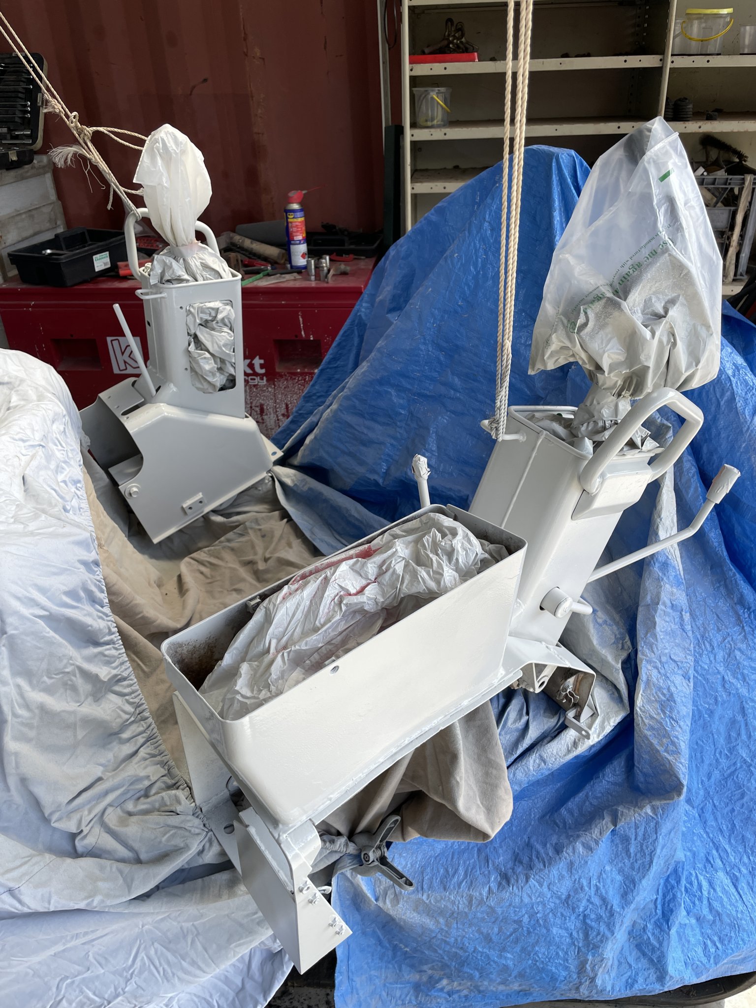

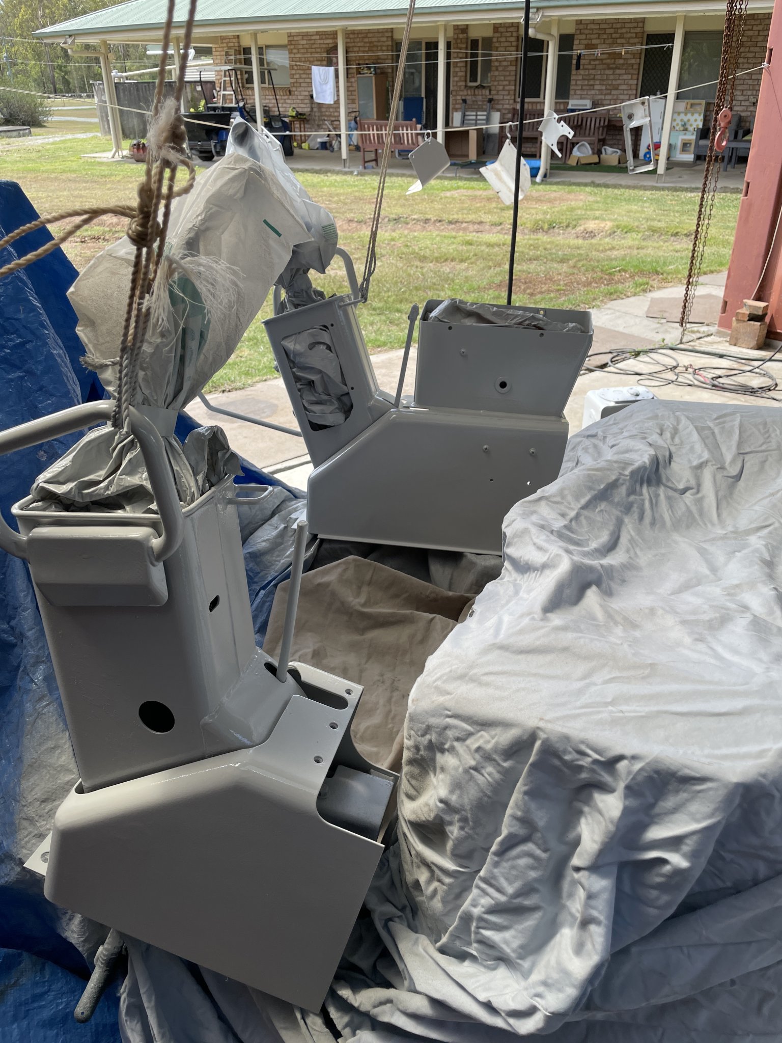

In the mean time I've striped the light grey sections down and resprayed them. They were covered in surface rust before.
