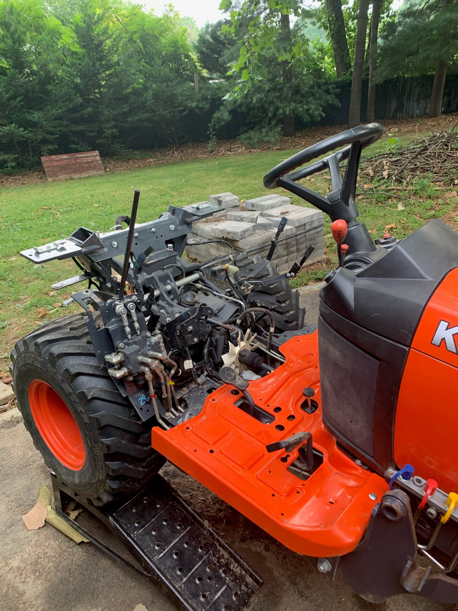

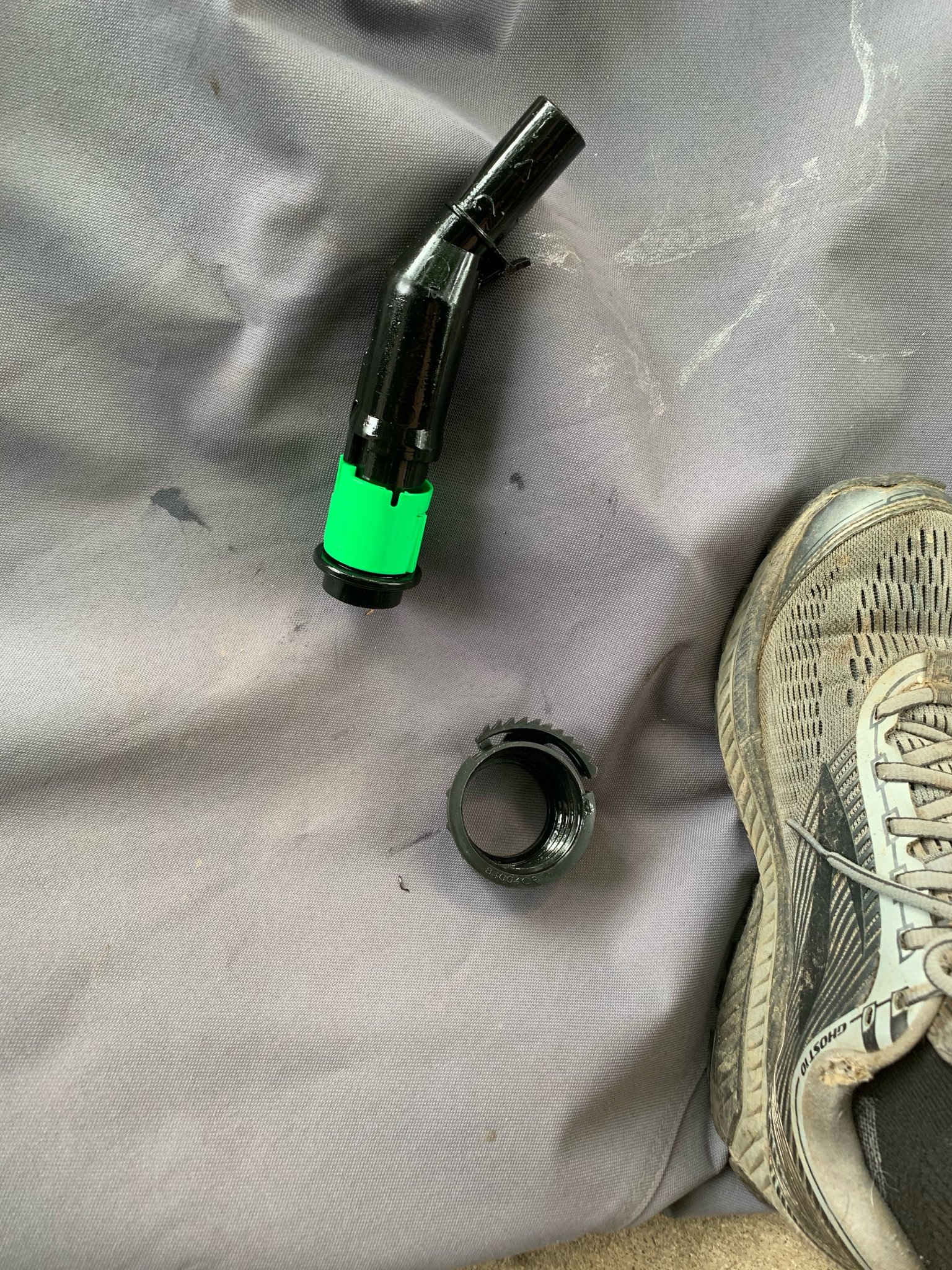

Sorry for the delayed response - I didn't buy the shop manual, but I went through the process of removing the tank anyway, taking several pictures along the way to ensure I could get it back together. When the tank was completely removed, I could hear something sizable rattling inside
bx23s tank removed.jpg nozzle.jpg , so I moved the tank around to work the object toward the opening.
What I found astonished me. It was a nozzle and screw cap from a fuel can. Apparently my daughter's (now ex) boyfriend was refueling the tractor last year when he lost control of the tank and broke off the nozzle from the can and into the kubota fuel tank. He told my daughter and when they couldn't get it out, they conspired not to tell the old man (me). Yep, Dad ain't happy about that.
Nonetheless, I removed the "debris", cleaned the tank, reassembled everything, and it's running fine now. I appreciate the advice you gave me, and I'll get back into the forum to learn more.

WOW, that's a BIG chunk of 'problem' ! Mine was 'just' a sliver or chard of plastic 'donut'. I broke a knob off(all the rest slide off...),hope you have help putting seat assy back on...dang heavy and awkward...
