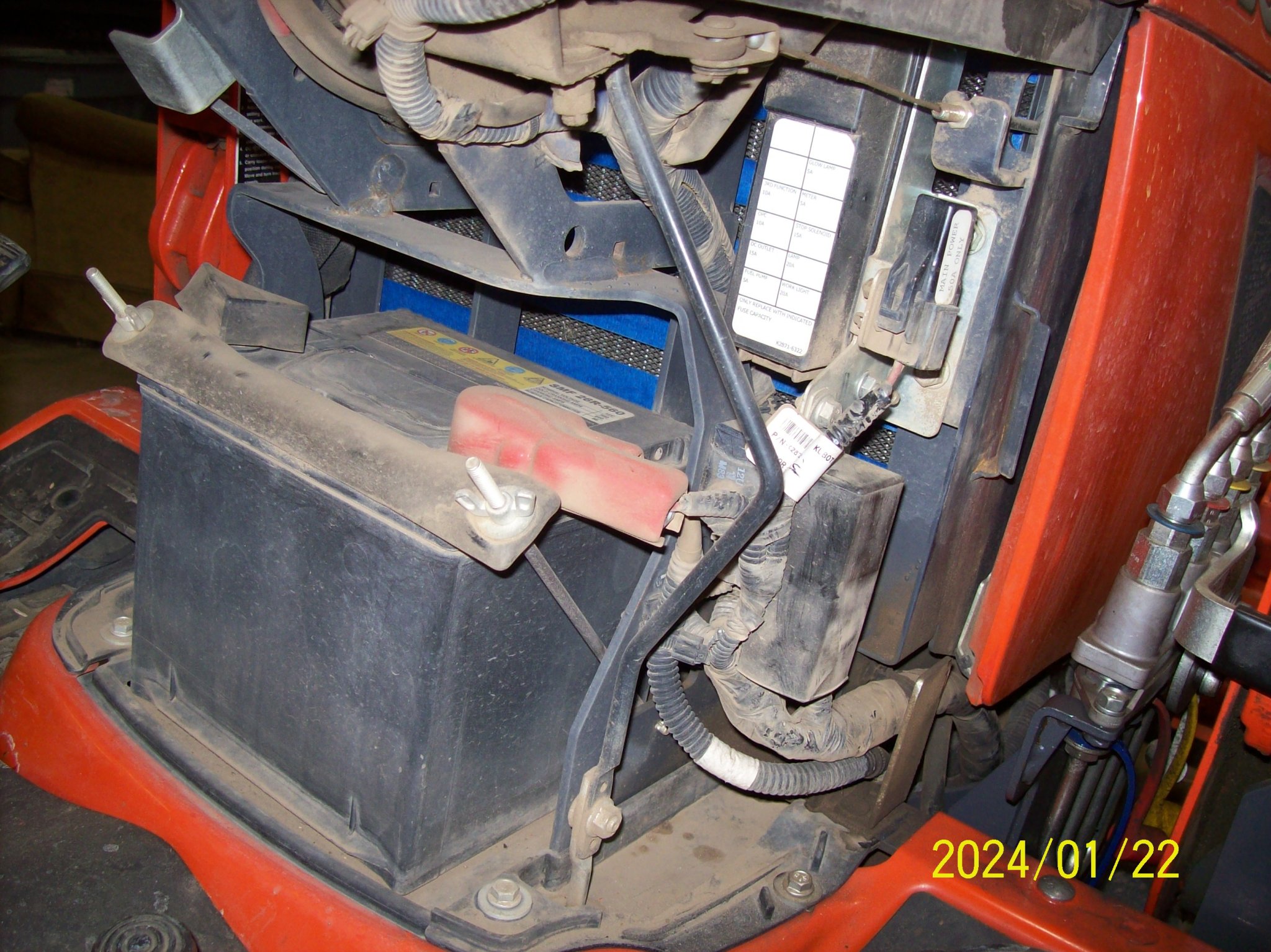

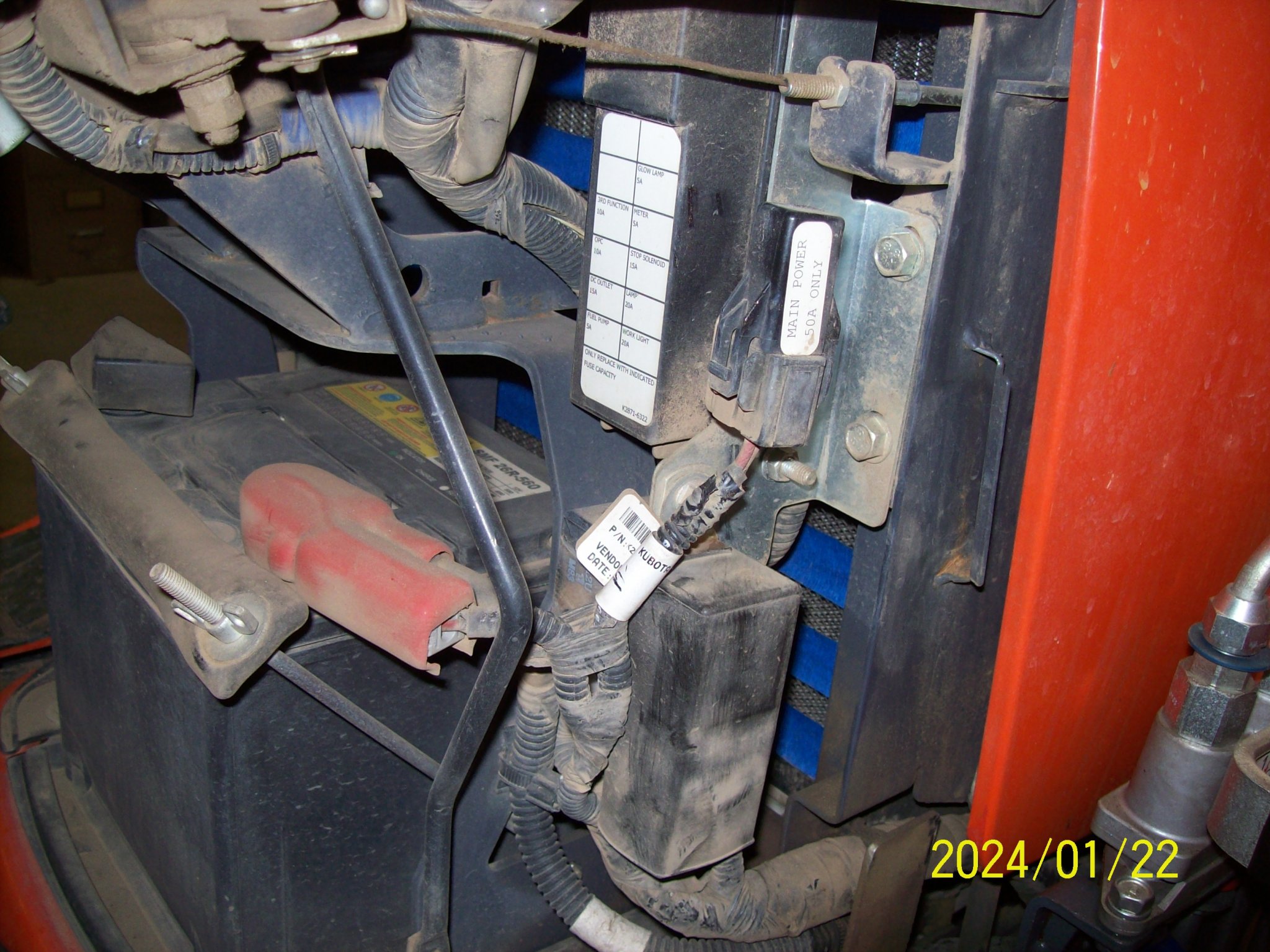

here's 2 pictures of my BX23S fuses area. The main 50amp fuse is labelled and EASY to get to !!! View attachment 120610 View attachment 120611

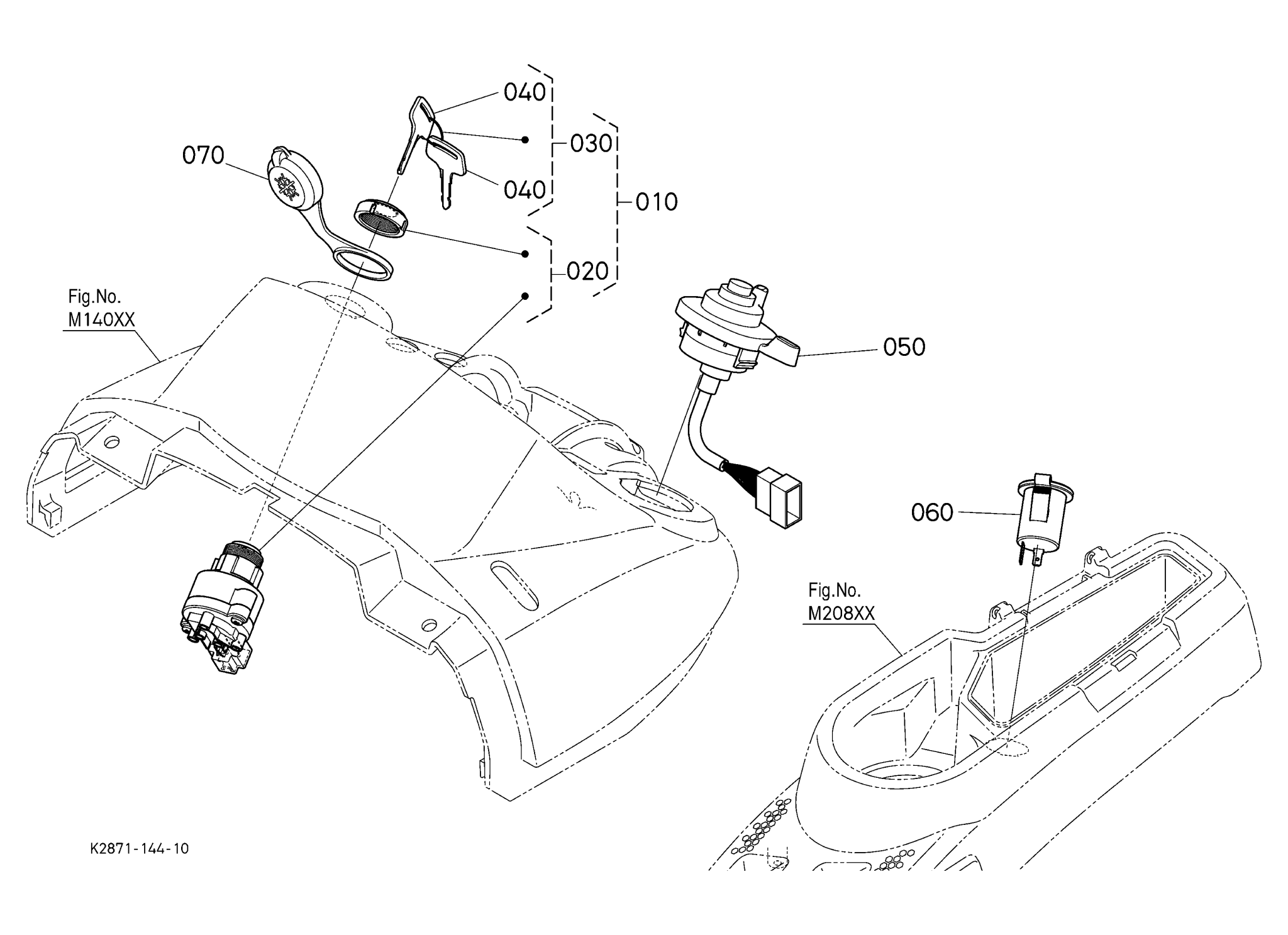

I suspect maybe a bad ignition switch.
IF it was 'easy' to remove,(usually unscrew trim ring on top, push switch through hole,disconnect wires ?) I suggest remove it, bring into nice warm house,use hair dryer or leave on register,spray WD40 in the key slot,cycle key a zillion times, test on bench.
BTW... The WSM does show/tell how to test it View attachment 120699
new switch is $120 Canadian...
Hay !!! there's a cover for it #070, $11

it 'should' take about 10 minutes to get the switch out
1) disconnect ground of battery
2) remove 'trim ring' on switch
3) pop switch down and CAREFULLY remove from harness ( plastic 'lock' )
just be careful when removing the cable when it releases, if it's sudden.good chance you'll slash yourself on sharp plastic..... so....

quik recap
50a fuse is good , also 5a 'panel fuse is good, as your have batt + oil light
NOT working are gauges, lights, 4ways,hour meter,gloplug light
??? do headlights work ??
1) I don't know what the inline fuse is for,maybe snowblower ?
2) you can check each fuse real easy..
a) connect -ve of meter to ground of battery
b) set meter for 20volt DC ( in picture !)
c) turn key to ON position
d) push probe into 'shiny posts' on a fuse. You should read '12 volts' on both 'posts'
If you read 12v on only ONE side, then that fuse is blown
If you don't read 12v on any post, hello Houston..we got a problem.
Make a drawing of the fuse panel, label circuit and rating ( Meter, 5a ).
Print off the 'fuse section' of the wiring diagram, you need it !
Check a fuse, if good ,check it off as OK.
REMOVE the ignition switch, flood with WD40, blow lots of very warm,almost hot air at it(10-15 minutes)
Reconnect switch and battery, turn key, see what happens.

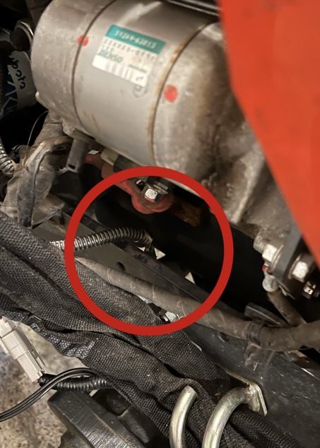

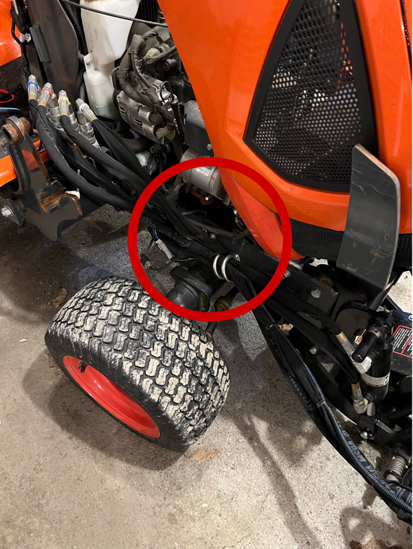

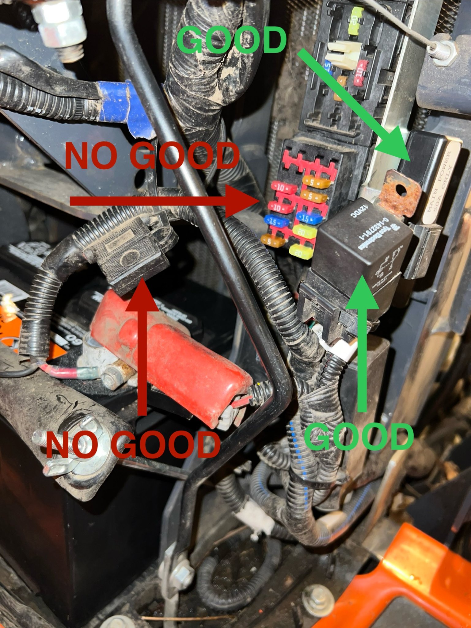

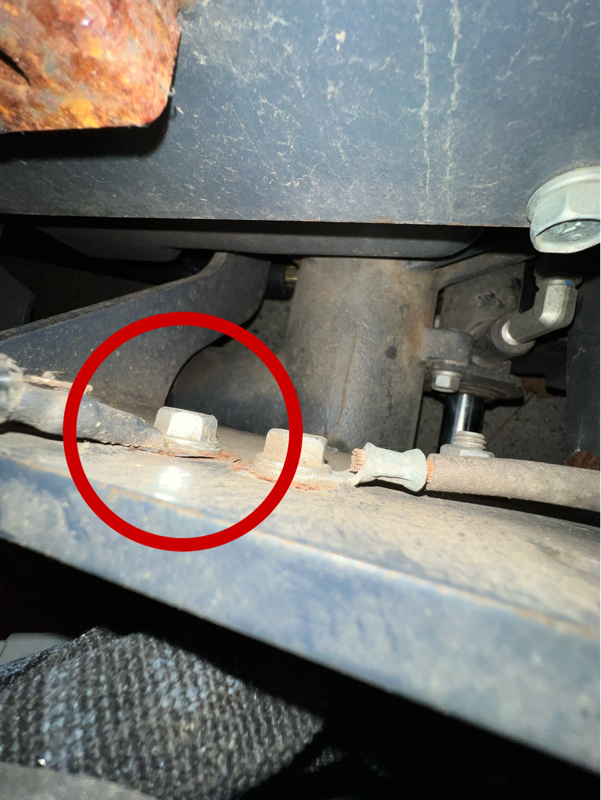

Finally figured it out!
So the mechanic from Kubota stopped by and he ran through the whole checklist as I’ve discussed here. Turns out it was a ground connector underneath the tractor that even though was connected and tight must have had some corrosion over the years and did not have proper grounding. I removed it, cleaned up the area and viola, up and running! Since I had an extra pair of hands he was able to move it around while I turned the ignition and figure out that was the issue.
Thank you to everyone for the inputs and maybe it helps someone else down the road.
