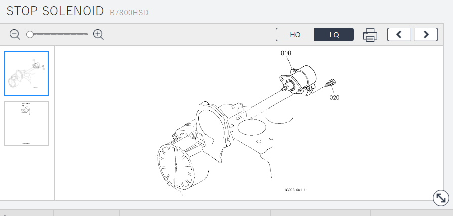

There are smaller fuses and other fuses that control the OPC and Stop solenoid.

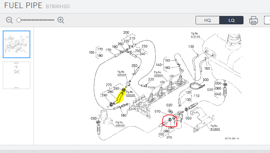

Pull the filer and clean the housing removing any water.
Reassemble, then pull the line off the side of the filter housing (RED) you should have good flow.
if you do then reassemble and move up to the side of the injection pump and remove the line there (yellow) with the line off crank the tractor, do you have pulses of fuel out of the line?
If you do, reassemble and move on as it's not a fuel delivery issue to the injection pump.
