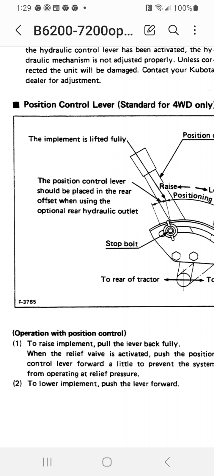

You are cinfirming my suspicions. Sounds lke you are placing the three point lever in the gated offset at the top of the guide slot.
That position locks out the feedback mechanism and prevents the pump from shutting off when the lift hits top of travel. That deadheads the pump against the cylinder and should only be used if you are using the optional rear remote outlet.

That makes sense but I'm not sure why I didn't have issues before. In the 3 point assembly, there's 2 nuts on shaft #7 as illustrated and I did take that apart but didn't know how to properly adjust it. Maybe that's part of my problem? I don't see anything in the shop manual? Thanks for your help.

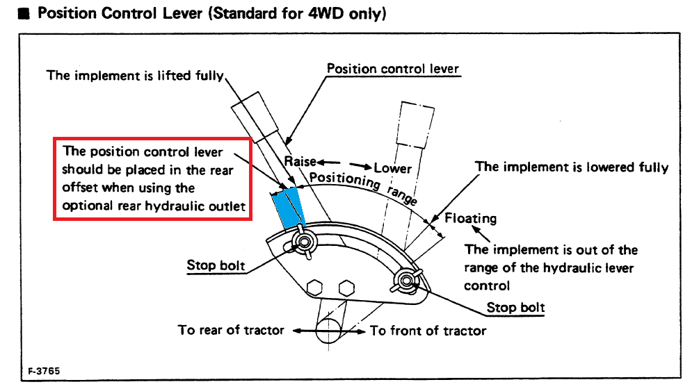

The B7200 3pt control has a special position that does exactly that.
It is used in conjunction with the optional reat remote outlet. When the lever is moved into the offset notch at the top of the guide plate (area highlighted in blue below) the feedback linkage is disabled and the spool in the position control valve is locked in the raise position. If the remote outlet is not in use the pump will be deadheaded against the 3pt piston and the hydraulic pressure spikes to max system pressure and stays there. Now on my B7200 that does not cause a blowout of the oring seal on the lift cylinder cover but it will tax the pump.
