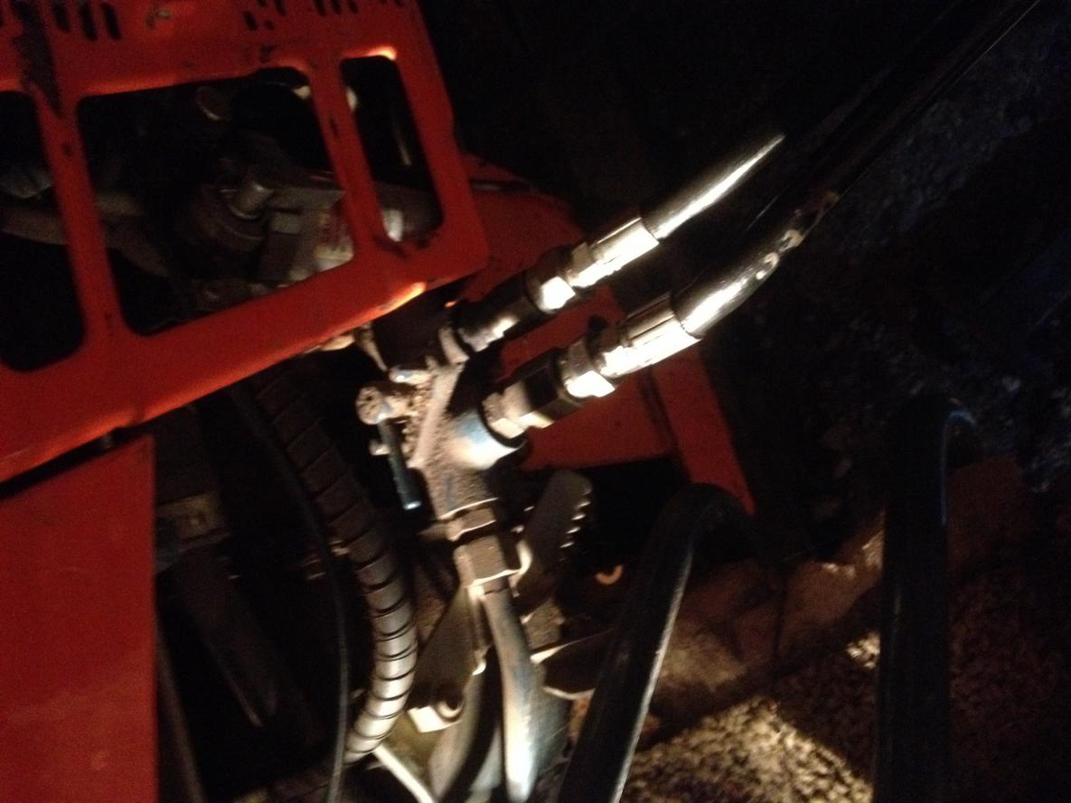

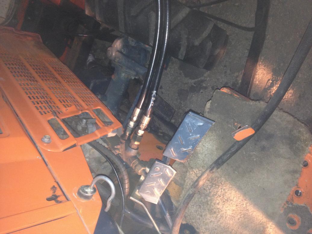

Thank you so much for answering. I really appreciate it! My blade is hydraulic driven and hooks up to the front hydraulic tee. I took pics here of how blade connects. I build and test air seeder electronics and hydraulics so got the tools just not the know how or where to begin. Thanks again for ur help

Perfect, that answers a lot.
If the blade is working fine then we know it's not the hydraulic pump, pressure or flow.
So now we need to move back.

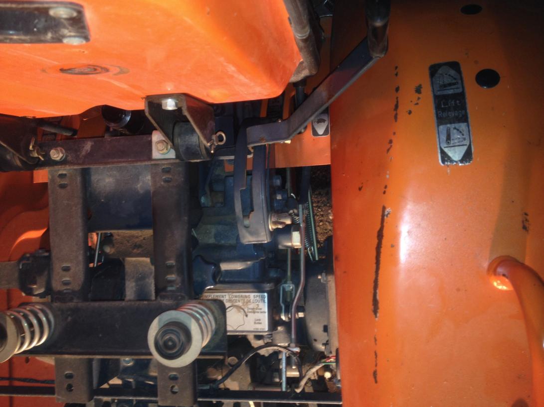

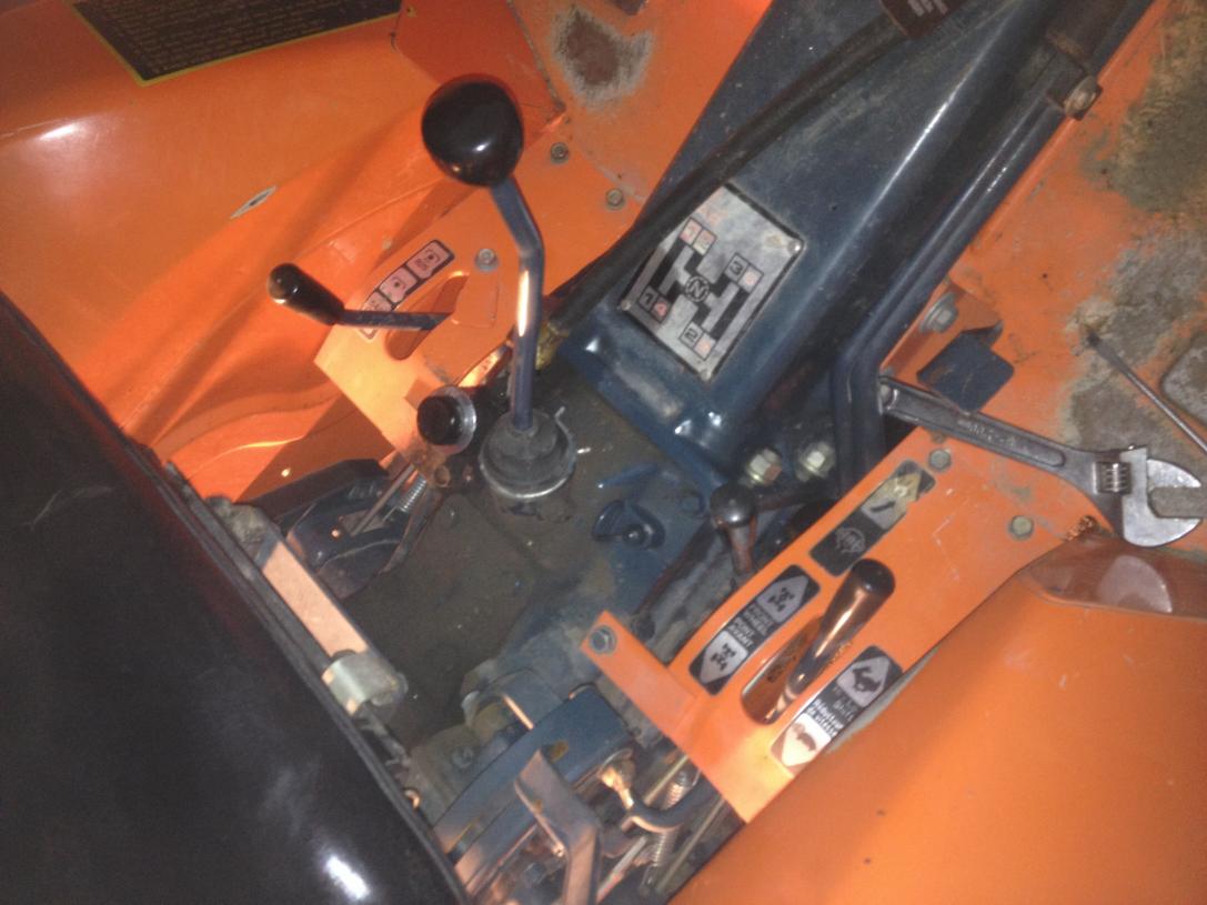

So we have some answers. I note you are new to the tractor and work with compressed air systems. Have you operated both blade and lift systems previously? My feeling is that we can work out this problem.
My understanding of the blue valve shown in your photos is that it will supply pressurised oil to both the three point lift AND the blade.
You need to eliminate these two completely long shots before taking anything apart.
1 The blade hydraulics are not completely robbing pressurised oil. This is highly unlikely because it is working.
2 The hydraulic lift lever has not become detached from it's shaft and is doing nothing ie not rotating the shaft. This is secured to the shaft by two flats and a nut.
Please send photos of your hydraulic block and cover arrangement this will satisfy us that we are discussing the same hydraulic components.

I believe the lever on the hydraulic block is in the wrong position to operate the 3pt hitch. It should be turned 90 degrees to the right. My 3pt hitch will not operate in the position that yours is in.
33,384
8,699
76_Bronco,
If he turns that valve it will just shut off power to the blade lift.
Jake5757,
Under the seat on the left side, is a valve that controls the speed of the three point, if it's turned completely off the three point will not move, try turning the valve and see if that does anything for you.
76_Bronco
B7200 4WD w/FEL, 4' disc, 4' Brush Hog, 14" Plow, 4' Blade, JD 246 2 row Planter
Mar 28, 2012
182
Rainsville, Al
76_Bronco,
You are correct wolfman, my lift operates with the valve in both directions, but my loader will only operate with the valve in the 3 o'clock position.
