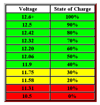

The issue is your batteries. A battery isn't considered fully charged unless it's around 12.6-12.7V. If the battery in the tractor is bad, it will draw from the good battery until it reaches equilibrium. I'd suggest fully charging the good battery, then hook it directly to the tractor cables without having the bad battery in the circuit.
