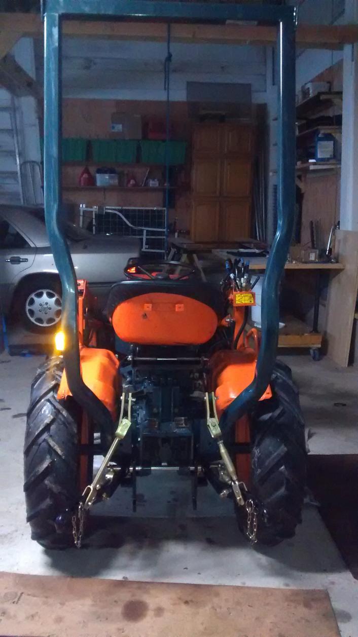

Have this gear drive b7100 with b219 loader and b670 backhoe The loader has his own pump in the front and the backhoe has a pto pump I remove the backhoe and bought a 3 point hitch kit from ebay that fit nice in the back. Lower the arms with the 3 point hitch / with the help of the screw that you adjust the speed down for 3pt Now i can move up and down the 3 point hitch by hand easy but not with the 3pt level -it will not rise up Any help please

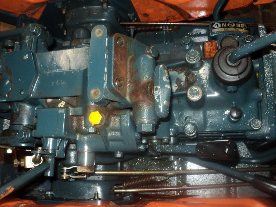

That valve that you can turn has a plug, it is on original setting i can not move it-horizontal
The yellow screw/speed dawn was set all the way in and 3pt arms all the way up I install the 3 point hitch and i could not lower it with the level or by hand try with engine on/off clutch on/off Than with the engine off i remove yellow screw and when i press it down by hand it went easy dawn Now it is not working it will not raise up No noise, loader works fine ,just change gear fluid clean filter This tractor came factory loader backhoe it was never used as 3 point hitch but it has the arms The way it looks no modifications was ever done
33,463
8,742
Take a picture of the valve under the front of the seat.
The reason that you were able to get the arms to go down is that the yellow headed bolt only adjusts the bleed off speed, you have just bypassed the speed setting and it will not lift with the screw backed out too far.
Should be able to move that valve, but as long as the arrow on the handle is pointing away from the plug, 3pt should work.
33,463
8,742
I can only post more pics in the weekend , wonder if i should try to bleed the system maybe is air inside ? but how to do it Last resort is kubota dealer -far, take a day off ,$$$, trailer that right now is under snow
Awww I just got what you said earlier, the plug on the side is to add another line, it has internal porting too, you need to get the valve to turn horizontal, you might need to get a little forceful as it probably hasn't been moved in years or never if it has never had 3 point arms on it.
And reset the yellow valve/bolt as close to where it was before.
Air in the hydraulics is almost never an issue on the outbound side of the pump (which this is), the preassure of the fluid is too great, at about 2500 psi give or take.
Check this post and you'll see what the inside looks like, and the first pick shows it in the proper position for what you want. Fluid flows in the small hole and out the large center to the 3 point piston.
http://www.orangetractortalks.com/forums/showpost.php?p=92755&postcount=12
My valve is exact like that and in that position , now if i open it to see what is inside i would like to get the o rings that i need I read a post that the piston maybe needs new o rings Any one know part numbers

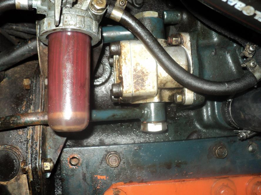

After spending my whole weekend in the garage find that gear hydraulic pump is not working / it seems clogged .There is 2 lines going into a box near fuel filter if I open return / with the engine running I should get same oil out but nothing is coming out Wonder what else to do Wonder if is safe to drive the tractor like this till I get money to fix it and is this expensive to fix/dealer

The fluid is kubota super udt2 fill the gear case ,clean filter/ screen banjo bolt oil is not flowing past hydraulic pump -open lower/out line See pic

Not getting flow out could mean not getting suction in.
A leak at any fitting before the pump can cause this, and yes a bad pump can cause it too.
Pull the pump and check for any obvious signs of damage, broken keyway on shaft, anything really.
When you loosen the banjo bolt on the bottom of the pump and run it does it make any noise?
That is the plan for the weekend, plan to remove that pump and make sure that is clean and see if any damage Will make sure that the lines are clean new o rings and washers clean filter again new udt My only problem is that if i did not buy the 3 point hitch i would never new that the pump is not working
