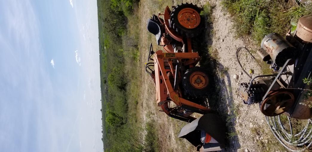

Kubota b6100 3 point hitch not moving at all
Estringer7
Kubota b6100
May 5, 2018
George West, Tx USA
Started off with whining while in gear as tractor warmed up would become more hesitant to lift and start delaying response then whining stopped at same time lift stopped working first tractor sp not entirely familiar with the mechanics of it but am mechanically inclined. Tried checking screen under seat on bolt that goes thru line no screen there at all.
