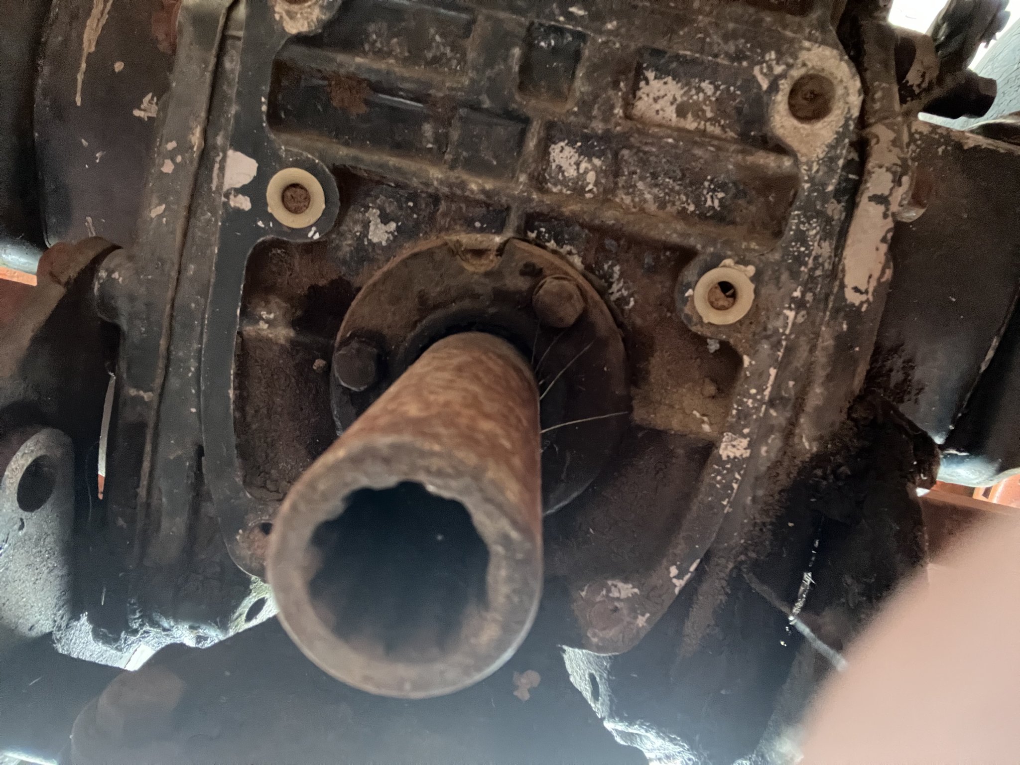

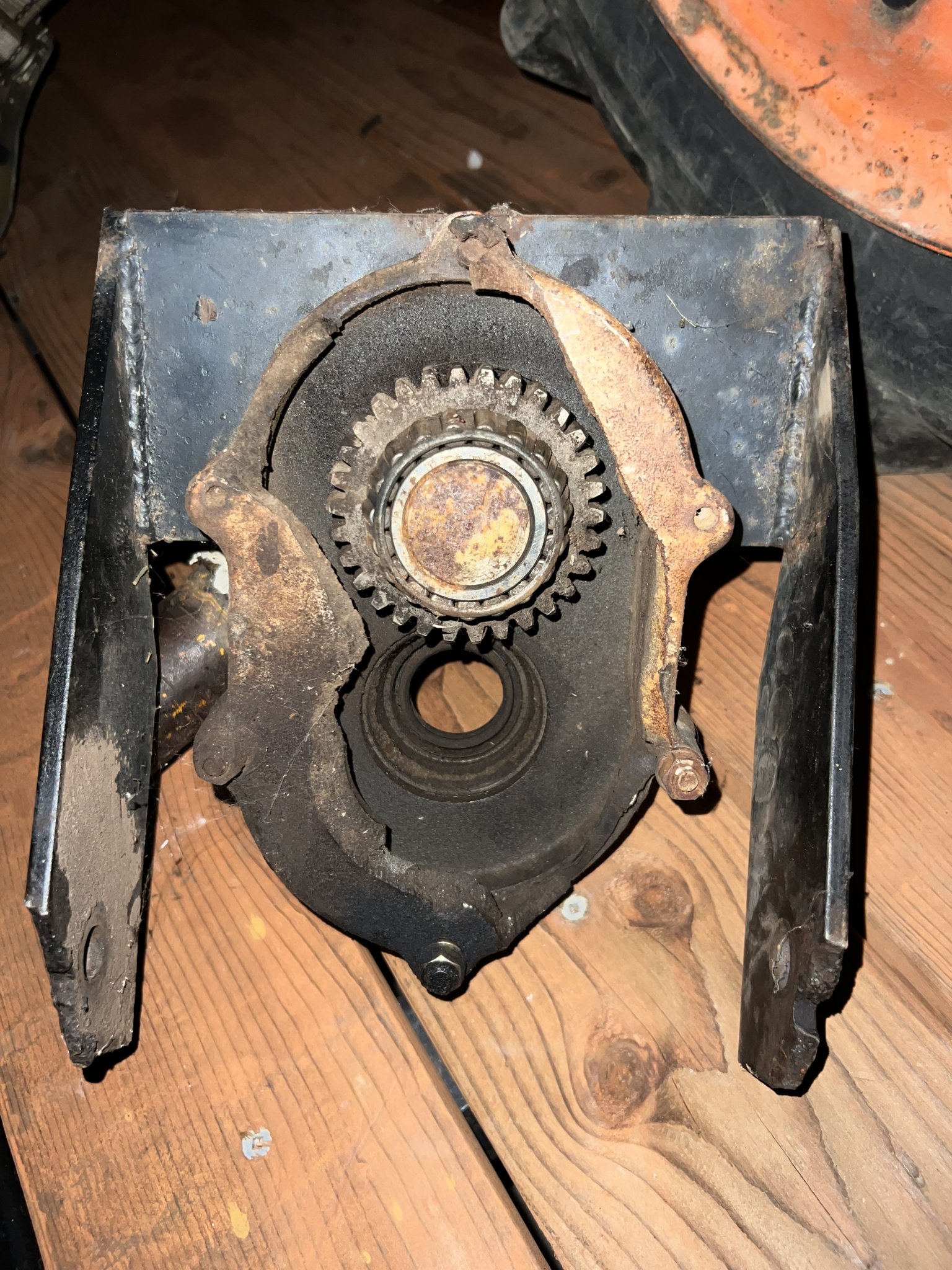

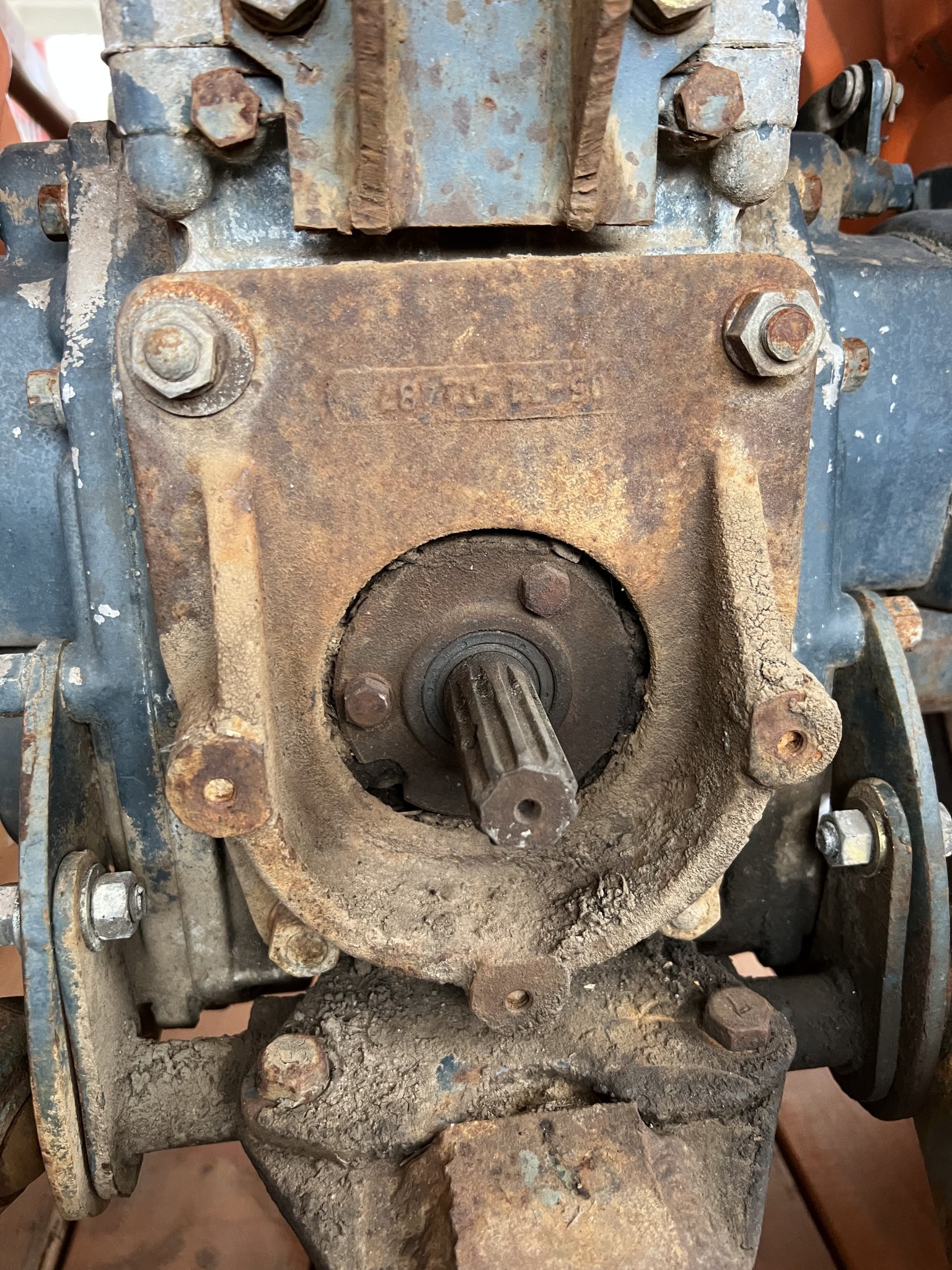

These are the pictures I took.
the first one is my 2wd trans On the tractor.
The tiller is like to get figured out first, if at all possible.

Yep a gear and the back of that case!
That's the reverser and spline adapter.

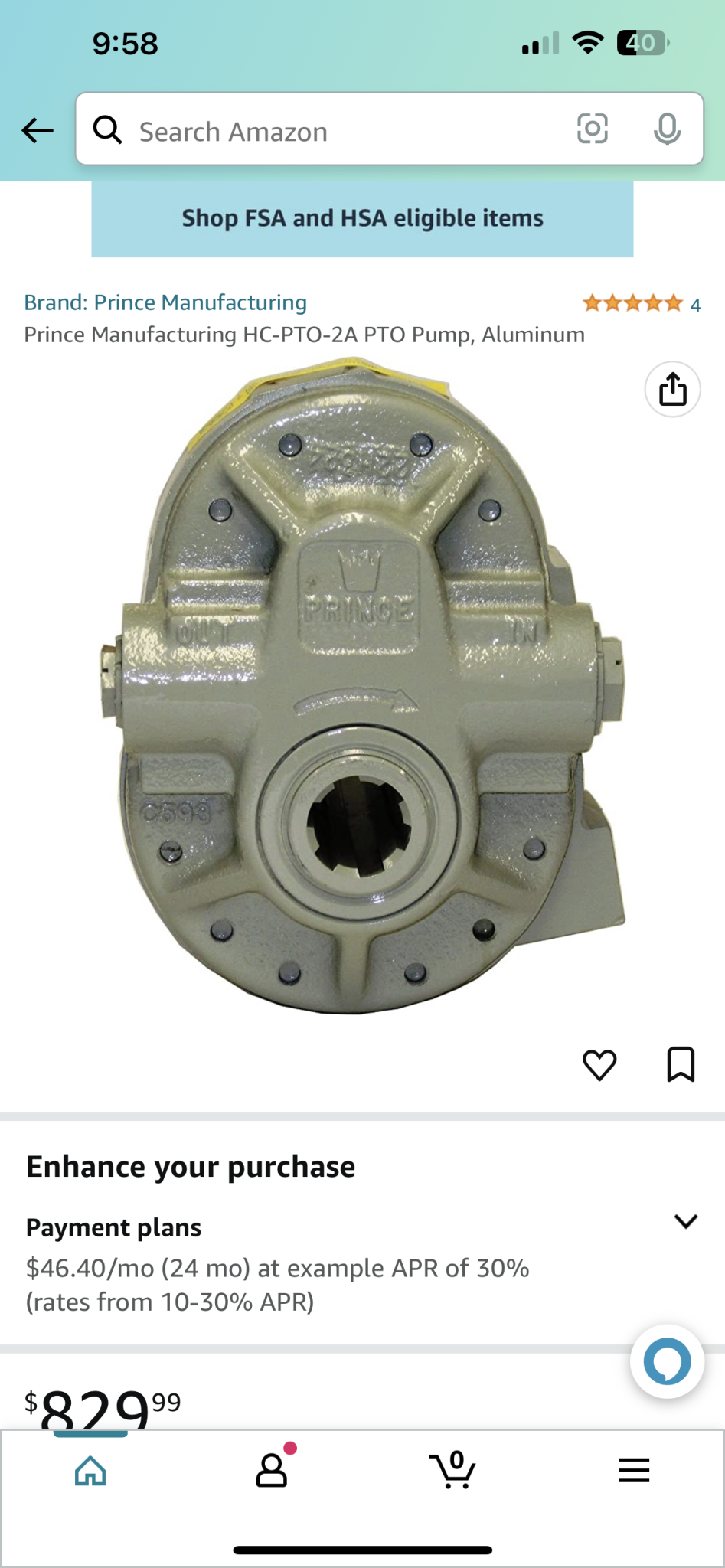

Is this what I’m looking for?
No that's a PTO Hydraulic pump, you need a PTO reverser that is specific to a B6000.
You have all the shafts you need, take the PTO half shaft off of your broken reverser box and it fits the rest of the shaft that is still attached to the tiller.
The B6000 has a small multi spline PTO that spins in the reverse direction to normal, and that why you need a PTO reverser as it will reverse rotation and give you a standard 1 3/8" six spline Male PTO shaft to connect the PTO shaft that you have already.
This is a picture of what you have that is broken.
When you get a new Reverser you'll need to remove the plate that is bolted to the tractor right now as it's specifically used for that style of reverser, there are several styles.
so what exactly is wrong with the one I have? besides the casing is broken. Is there a gear that goes on the bottom to drive the top one? If so do you think it is possible to get any thick gear and make it work or dose it have to have a certain weight to it.
And inside the reverser is supposed to be full of grease or oil, correct?

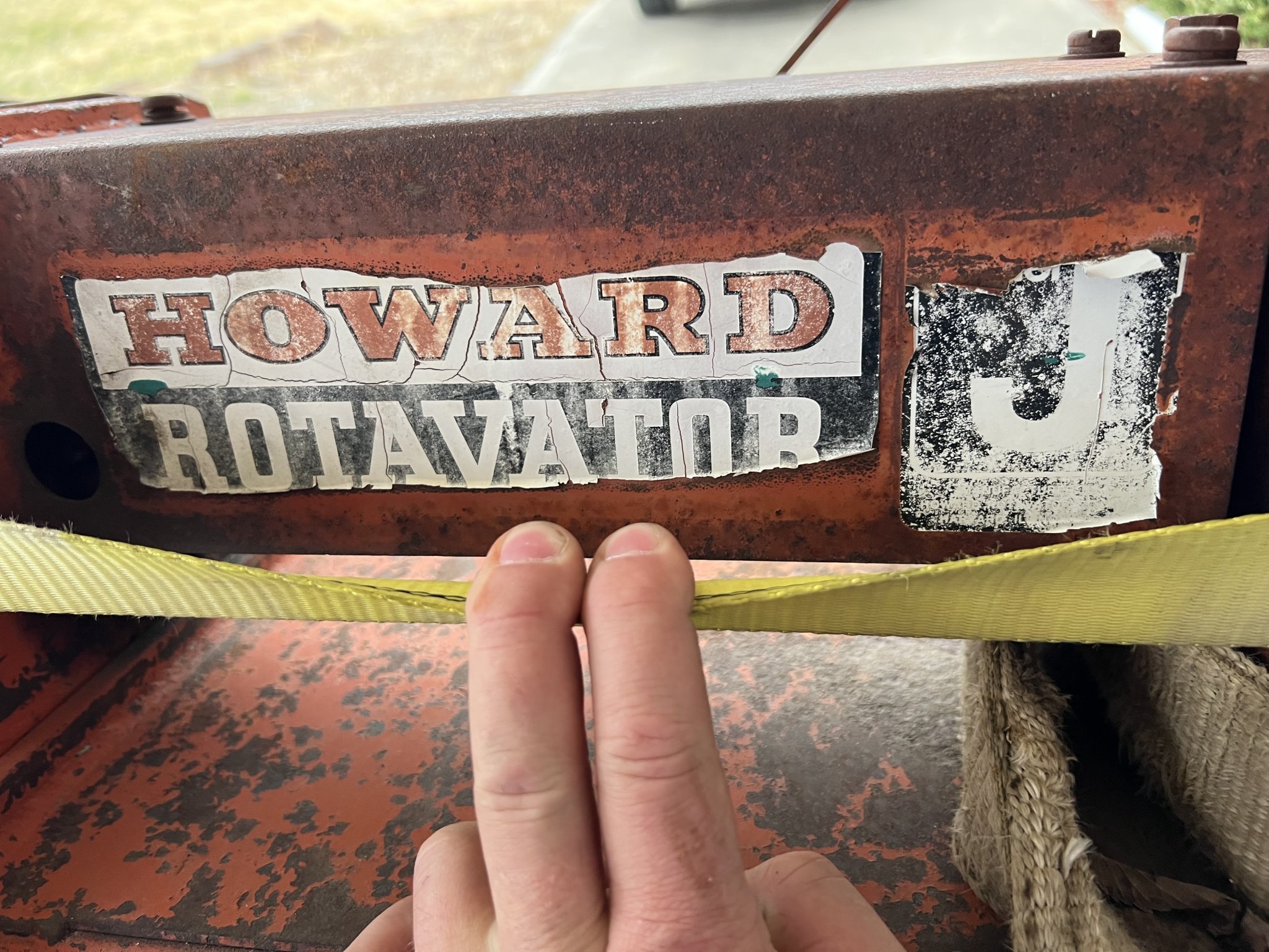

curious....
HOW could a 12HP tractor lift and pull let alone power the Howard Rotovator ??
That tiller looks mighty dang HEAVY !!
It is heavy, but it came with the tractor. I didn’t buy this from a Joe Schmo, it was Grampa’s he’s had it new. He’s gone now so I can ask him questions. So I’m here bugging y’all and learning as I go lol.

Don't ever let go of that old Howard Rotovator!
Those are machines with a solid working history!
You cannot buy anything like it today!
