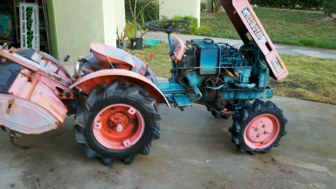

Anyway.. picked this b6000 up today out in Lancaster ca.. story is it was used for garden art and then sold and worked before... well see..... been sitting about 10 years.. it turns over jumping it from the starter.. no key.. put it in gear and it goes.. the engine oil is just nasty.. and overfilled to the rubber seal on the dipstick.. ive read that the rear seal can leak all the trans fluid in the oil..? trans oil is about dry..

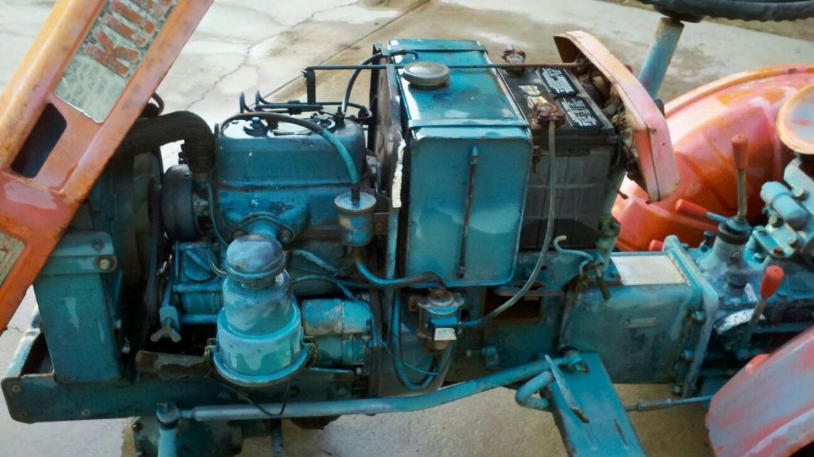

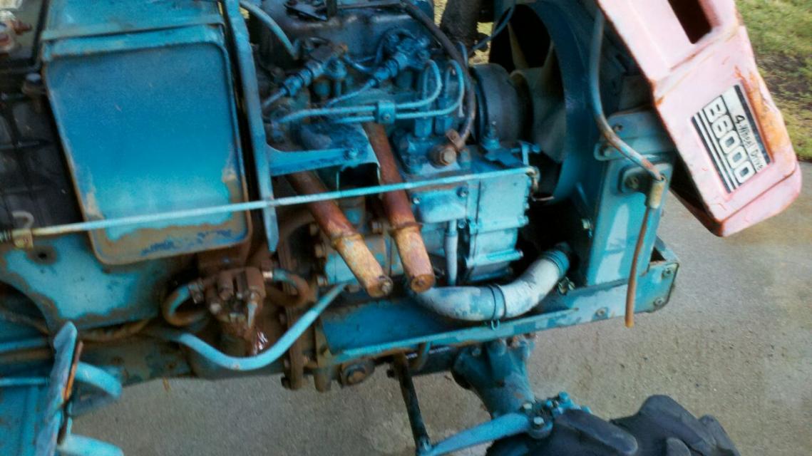

What I need.. if you guys could be so kind.. is the bottom part of the oil bath.. muffler.. just has the two straight pipes from the block.. Key.. or new switch.. and a wiring diagram would be nice.. have a random wire that looks like it plugs into someplace over by the injection pump..
a lot of the faded stickers are in Japanese.. not sure what some of the levers do.. and the hydraulic pump? (belt driven) by the starter? not sure what that is.. says to use 30w oil.. that's all I can read.. also need to know what kind of trans oil and hydro fluid I can use.. would like to buy some generic stuff locally.. just for testing purposes and change it for the correct Kubota oils once im sure I don't have to dissect it first... know what I mean???
so tomorrow im going to clean the fuel tank and fuel filter.. hook up the electric fuel pump (hopefully it works) and bleed the fuel system.. replace some fuel hoses.. and see if she fires.. will defiantly change the oil before I start it.. ive got about 8 gallons of diesel oil laying around.. im a equipment mechanic by trade..

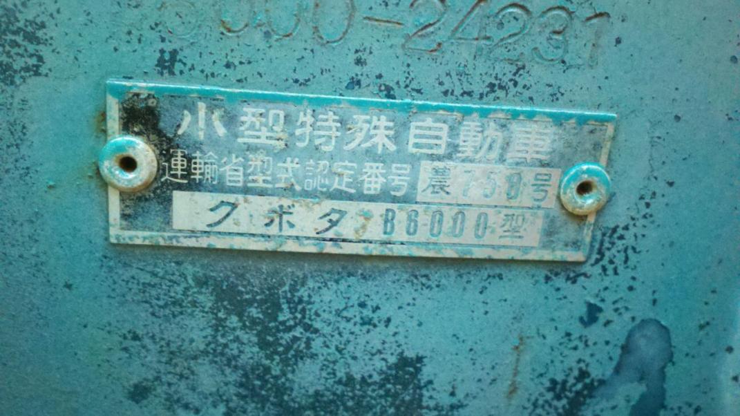

also ive posted a pic of the serial.. anyone know the year? also need to find some front tires.. having issues finding this size in the ag type.. of course that comes after I get it running and working correctly..

Oil can not leak into the engine from the rear seal. The housing that starts with the bell housing and goes back to the transmission is open on the bottom and holds no oil. Oil can enter from the hydraulic pump (not the belt driven one) but usually not unless the pump is operating not just sitting. Fuel can enter the crankcase from the injection pump but once again only when the engine is operating. My guess is the lower part of the oil pan is filled with water and the oil is floating on it.
Your engine has 2 hydraulic pumps on it. The one on the right side runs the three point hitch using oil from the transmission. The one on the left that you referenced that is driven by the fan belt must have been to run something else. I believe that when a B6000 was fitted with a front endlolader they used the belt driven pump.

The air filter oil pan is available from Kubota dealers. Part number is 10283-11240. Around 40 dollars.
There is also a conical steel baffle that is fixed inside the plastic oil pan by a wing nut. It is a separate part but I have not checked price and availability on that.

Your really going to want to find a used muffler and cover.
Muffler 15231-12114 $327.39
Muffler cover 66591-54620 $220.55
You could also try West Kentucky Tractor Parts for the muffler and cover.
