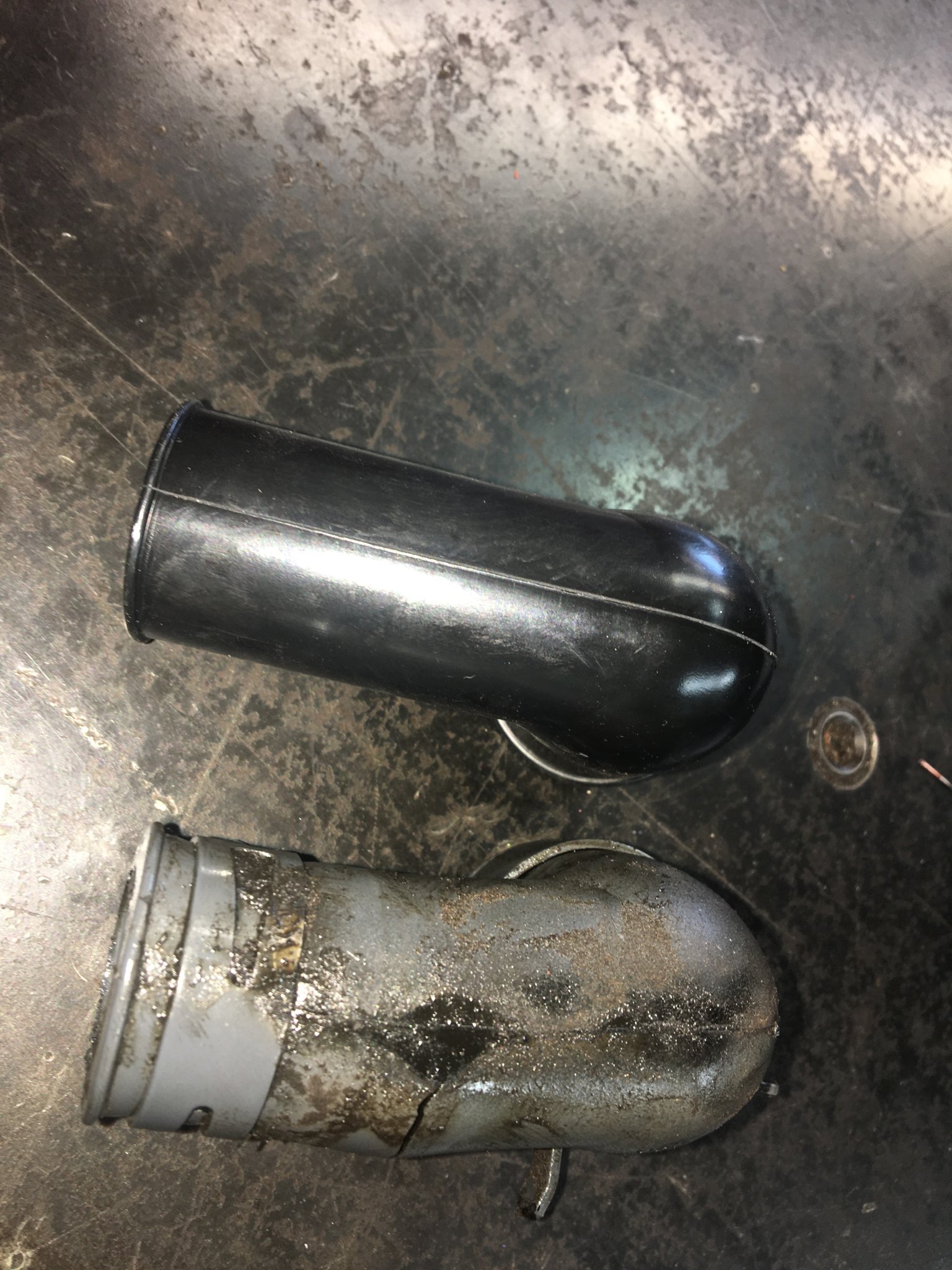

B26 had a design problem on the suction side line rubber elbow that would crack allowing air to enter. Foaming and heating up the hydraulic oil to the point it come out vent at the rear.
Never a recall but did redesign the line to reduce stress on that rubber elbow about 2020. Not covered in WSM.

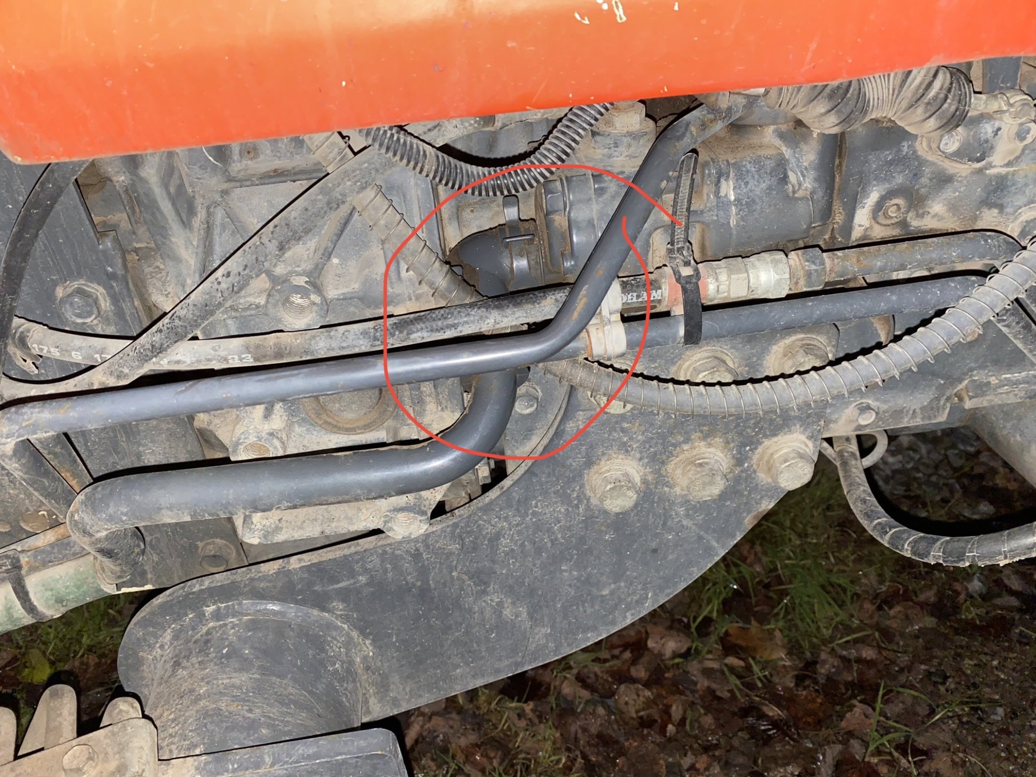

@Smokeydog saw that on youtube but could not figure out where the elbow is 🙈
Maybe this, but it doesn't look like in the youtube video.
@Smokeydog thank you, I confirmed by looking at the parts diagram that's the elbow. Doesn't look broken to me but I'll look to get a new one anyway.

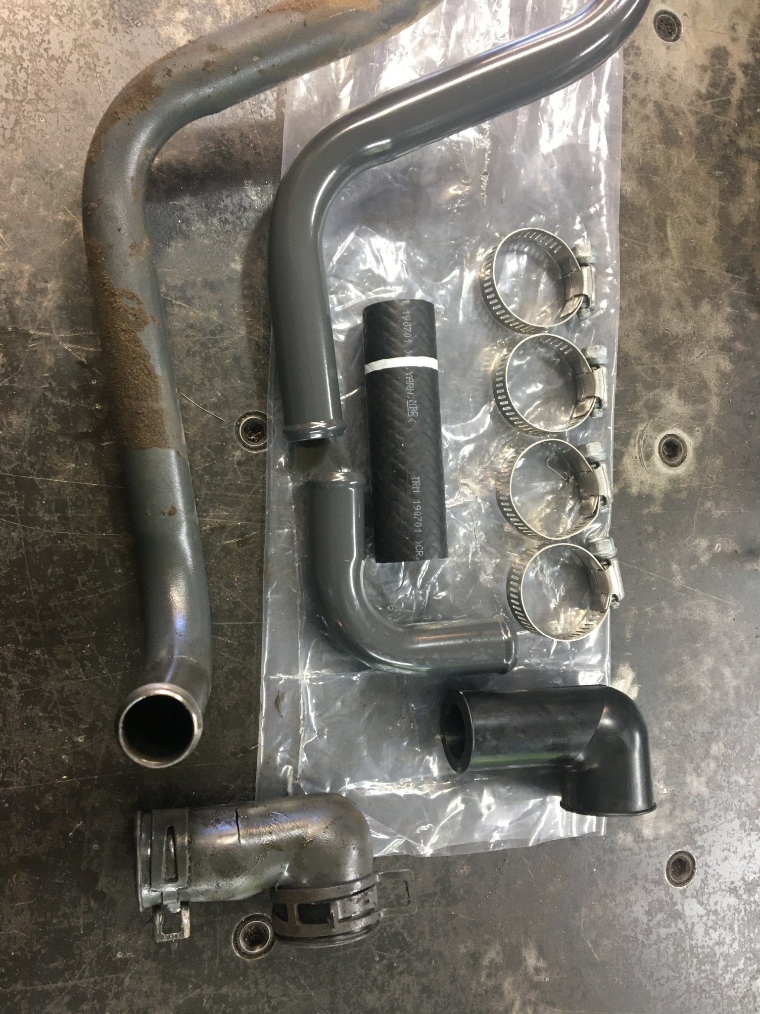

That looks like mine that was cracking. Couldn’t see cracks till removed. New elbow came with new line modifications.

The problematic old line was steel tubing from filter housing to rubber elbow.
New design is two metal tubes connected with a short piece of rubber tubing for flex then the rubber elbow. Our B26 is 2016 and changed to the new design in about 2019.
I had given a copy of my invoice to a friend to help get the right part. First dealer didn’t have a clue. Second one did.
