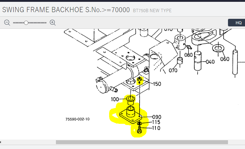

Hello orange Tractor peeps. Looking for some info on what type of antifreeze to use in my Kubota b20? Also doing some hydraulic maintenance and need to redo the hydraulic swing pistons on the backhoe but can’t figure out how to remove them. Any info would be great. The top bar is welded to the machine.

You need a service manual and operator manual.
Might consider servicing the swing cylinders in place. Tractor holds the barrels in place. Replacing seals not too hard a job, those would be a challenge to learn on.

Thank you .Smokeydog. In the process of getting service manual. I was hoping that wasn’t the case. I hate laying on my back, but always up for the challenge. I will see how it shakes out.

Here is how you remove the cylinder.
