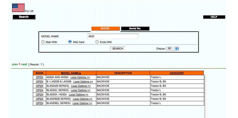

You can go to the Kubota parts website and search 4520 you will see the different variations of the hoe. Check and see that most large parts are the same between all variations of the 4520.

Enter 4520 where it says model name. Then click on the "Wild Card" button. Then you can see all the variations of the different models.
