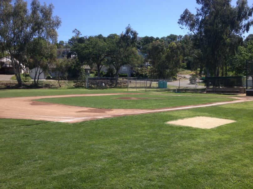

Awesome! I take care of my kids baseball field and people are always asking us to make stripes. I tell them it's hard enough just keeping it mowed.
