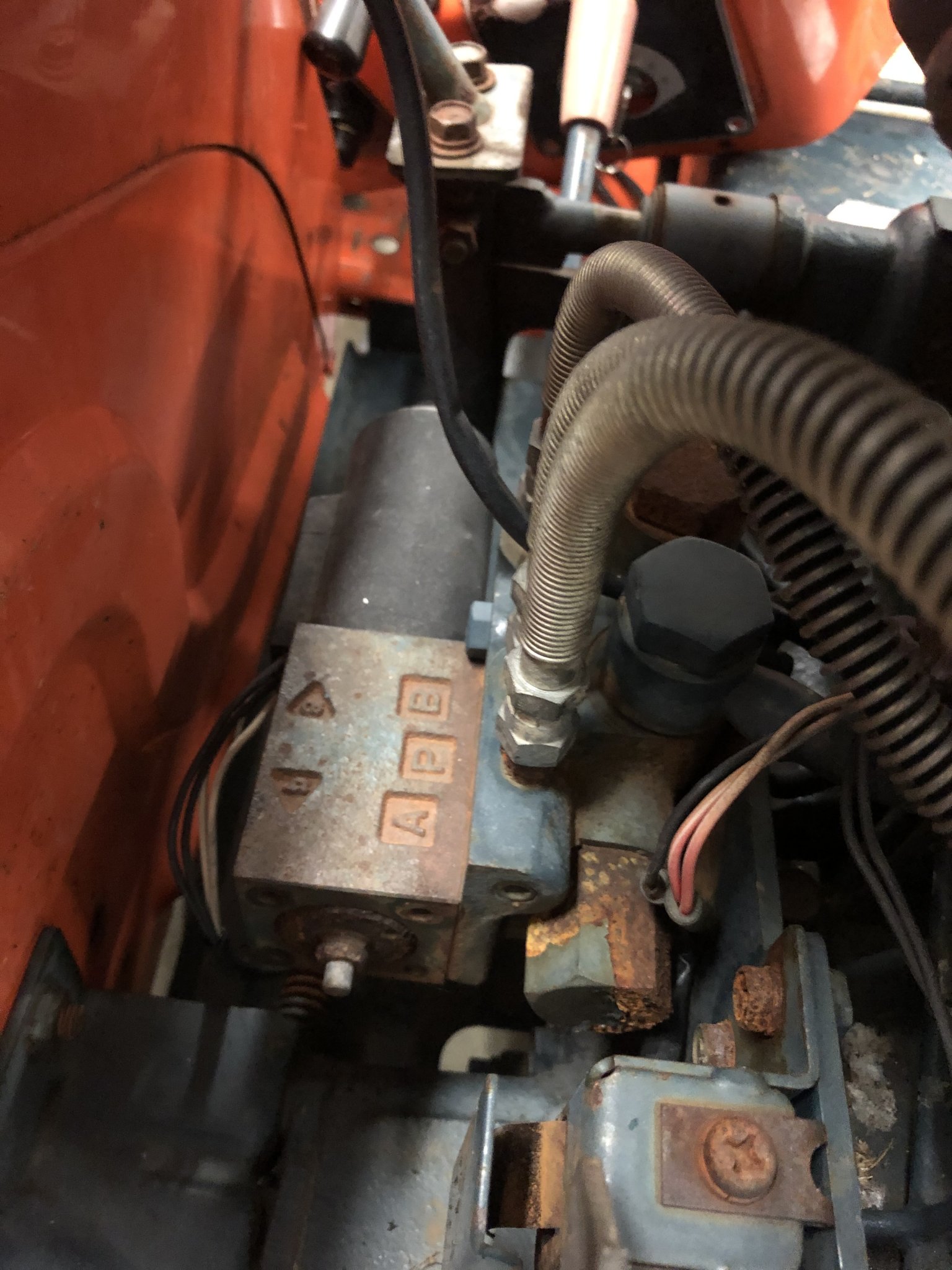

yesterday i checket the pressure at the electric, valve (the valve doesnt work ), when just using the starter-motor without to start the motor i got 100bar, that was testet at point "A".
no oil are comming from "P" and "B"
anyone have wiring diagram for this hydraulic system?

i meassured the hydraulic valve by opening all three connectors, A,P and B, only place i got oil is from "A".
my plan is to have an hydraulic optput, but not sure how to wire this, am working at som hydraulic at work, and there it is pressure inlet "P", and "A" and "B" should be output, but here this looks not correct,

someone know what the switch at the left is for? when i use the right button, the pressure drops once i release it, i got 100bar at the output,

about the hydraulic valve, i opened it and see that the A-P-B isnt the correct marking for the wire, this marks are for inside of the electric valve. i cleaned the valve and now its runs both way when operating the electric switch.
