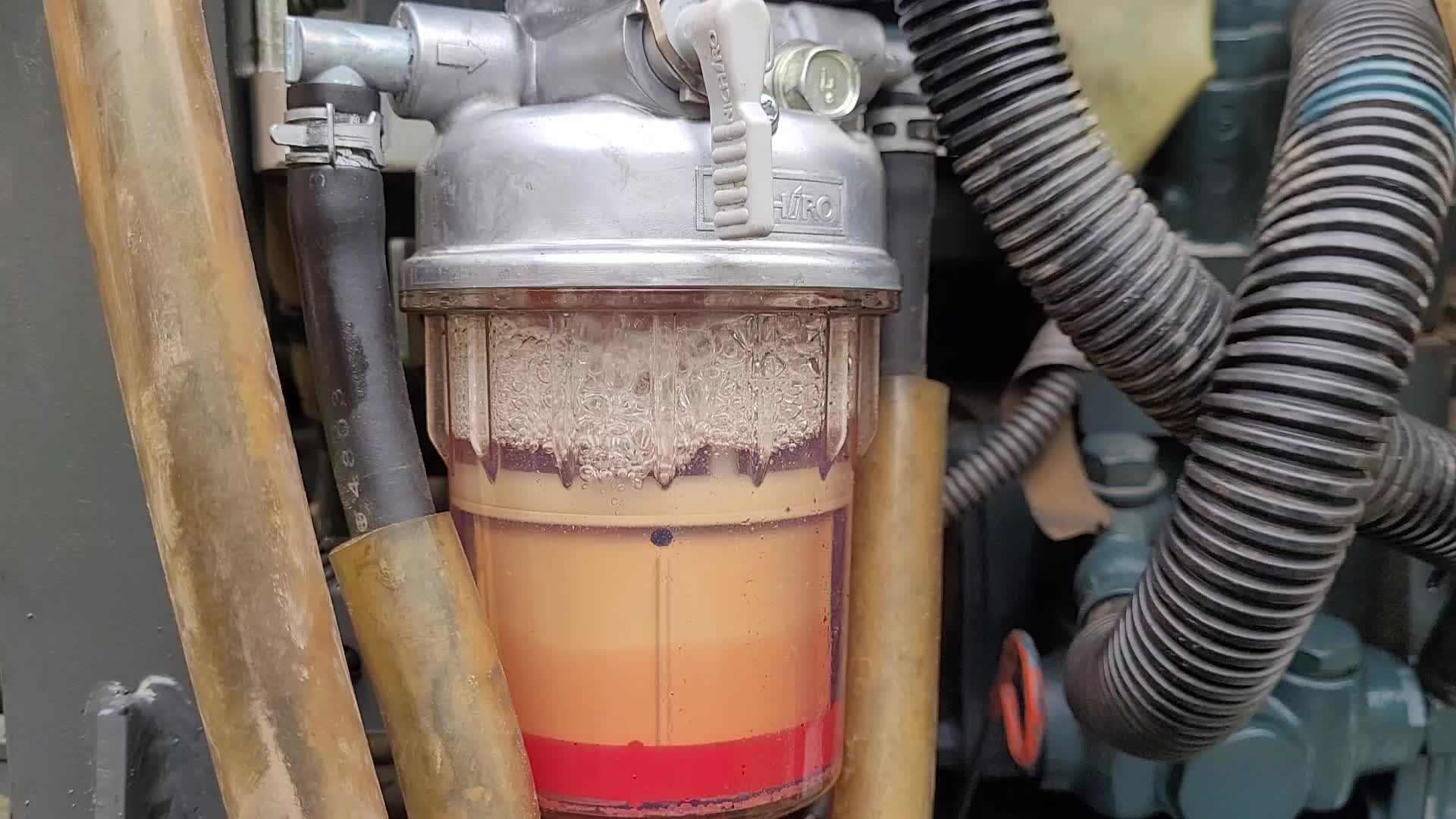

There is no warranty on this machine..I am 2nd owner. I am going to just start replacing every fuel line on it and see. Its getting a ton of air into the water seperator I hadnt ran the machine for a couple of moths and tried to start it and its been acting this way since. A motor just dont go bad sitting up for 2 months when it ran fine before. There is a pic of the amount of air going into to the system

The dealership MUST have said WHY a new engine was the fix…..nobody drops a $20k estimate on a customer without some causation/justification…
Maybe the dealer wanted someone to go away...80/20 rule.
I would suggest draining all the fuel, purging the lines and cleaning the tank.
