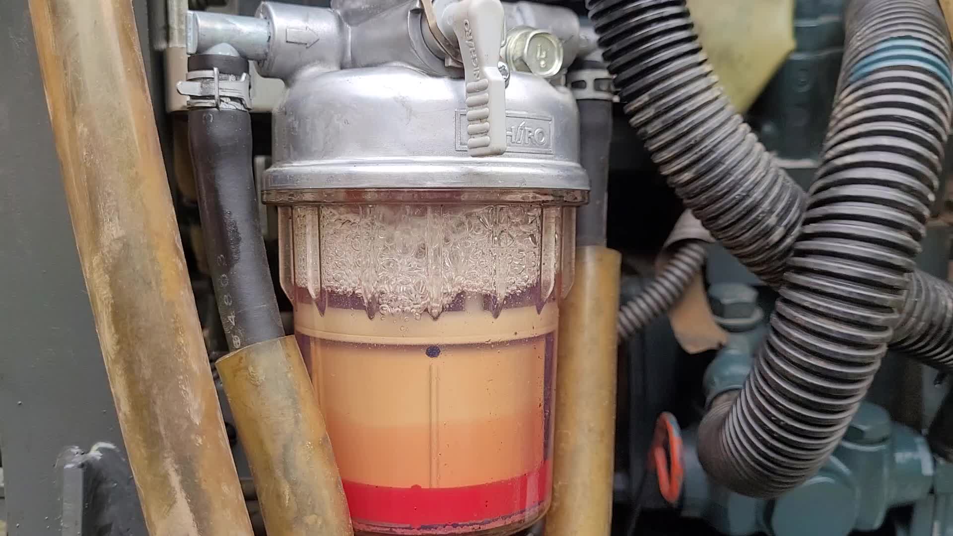

whitetiger asked about air bubbles - he's very good at this stuff. It's what he does.
Looks like it gets a bunch in the separator.

You have a suction leak between the fuel tank and the separator, either the tank outlet is partly plugged or you have a hole or crack in the fuel hose.
