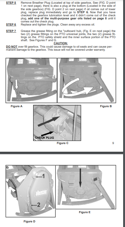

I bought a new 5’ kingkutter tiller and when I went to check the tine gear box it only has grease in it. The manual said the gear boxes where shipped full. should I add gear oil to the tine gear box that has the grease in it. Thanks in advance for help.

I'm not sure which area you are talking about. I had to put gear oil in both gear boxes on mine. I have a King Kutter, but it is branded Rural King. I assume they would basically be the same. You have a weep plug on each gear box that you remove and then fill until it weeps out. I found with the middle gear box, I can just look down into the fill hole and the gear oil should just cover the gears, making it unnecessary to remove the weep plug.
You have to also grease the bearing on the end of the tiller.

I have a King Kutter II (reverse tine gear drive 60 inch tiller) and it came with grease in the gear box. The manual said check oil before initial running. I opened the fill plug to check the oil and found it full of grease. I called the factory and asked them what's the story. They told me they are putting grease in there now and if I was to add some oil it wouldn't hurt anything at all. Ive run this unit for 3 years now and originally added about a cup of oil to get the level up and it has been just fine.

The owners manual says that they ship greased, but you should half fill with gear oil. 80-90 or 85-140. The one on the side has a small (1/4"?) plug to check the level. You are just supposed to eyeball the top gearbox and fill it halfway w/ gear oil also.

I couldn't really gauge the consistency--I could see it but didn't fish any out to squeeze it. It didn't look all that thick, but did have chunks adhering to the gears. Not sure that I've ever actually seen cornhead grease but it seemed a little thicker than I imagine that.
There were big warnings in the manual to add oil, so it may have been a thicker grease they smeared on the gears to prevent rust in transit/while sitting on the lot.

The side case on my 10 year old 6 footer takes 00 grease. Comes in a quart bottle like gear oil. Gear box takes gear oil.
