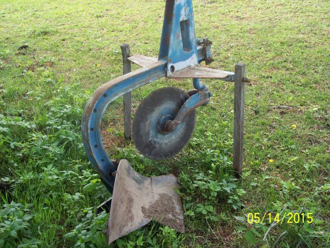

I've had this one for over 20 years. Made of scrap pieces of oak. Simply drill a hole for the pin.
Now that is elegant in its simplicity. I suppose you just drop them in the spot you park the implement, and then return the implement to the same spot when you're finished?
I'm curious how you get the 3PH arm on without moving the stand -- or do you just leave the stand on the pin and swing it around to rest on the 3PH while you're using it? (I'm thinking that trying to take a stand off then get the 3PH arm on the pin would be a real challenge! :eek:)
14,339
6,581
Only one support is needed to hold up the plow. Two just stabilizes it for long term storage!! So, remove one support and hook up the arm. Then the other side, then the top link. Yep, leave the wood right where you got it. "I'll be back".
