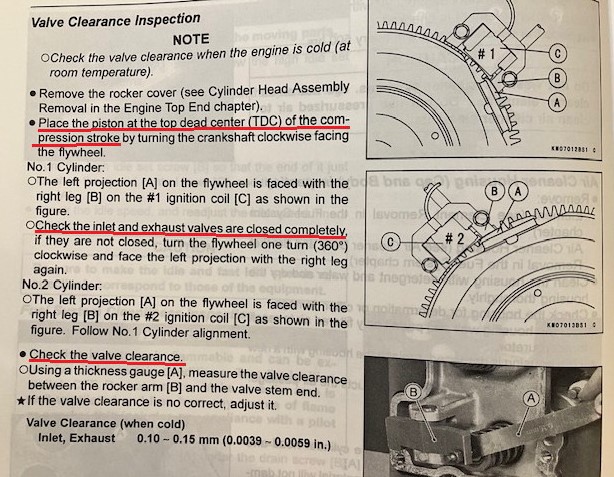

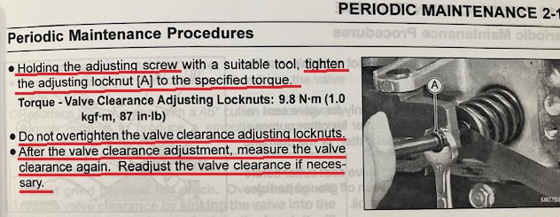

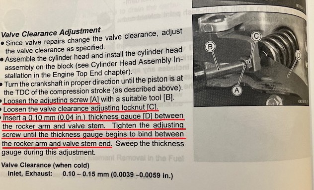

Pretty straight forward on mine.
Make sure you are at TDC on the compression stroke.

It's a v-twin. I was under the assumption that the compression release was on the exhaust valve on cylinder #2. I'm working on #1. I have compression with about .030
Lash,but it don't sound good.
I bet it doesn't sound good. That would be a good spark plug gap!
We want between .004 and .006 (thousandths) clearance.

the springs are really weak. When you stuff a thickness gauge between the valve stem and rocker arm, you just barely want any drag-no more. It's not a race engine that has 400 lbs of spring pressure on the seat, so if you are too overzealous with adjusting, you can actually push the valve open a little and stray your clearance measurement.

A 89 yr. Old retired air force airplane mechanic owns this mower. He still uses and keeps the service up, but too old too still work on it.
Understand. Thank You for trying to help him with it.
I shoot for .004 on the intake and .006" on the exhaust since it gets hotter and parts expand a bit more.
Not sure what the issue is. But bringing the engine around to TDC (on the compression stroke) should result in both valves being closed and the rocker arms 'loose' so that you slip a feeler gauge between the parts.
