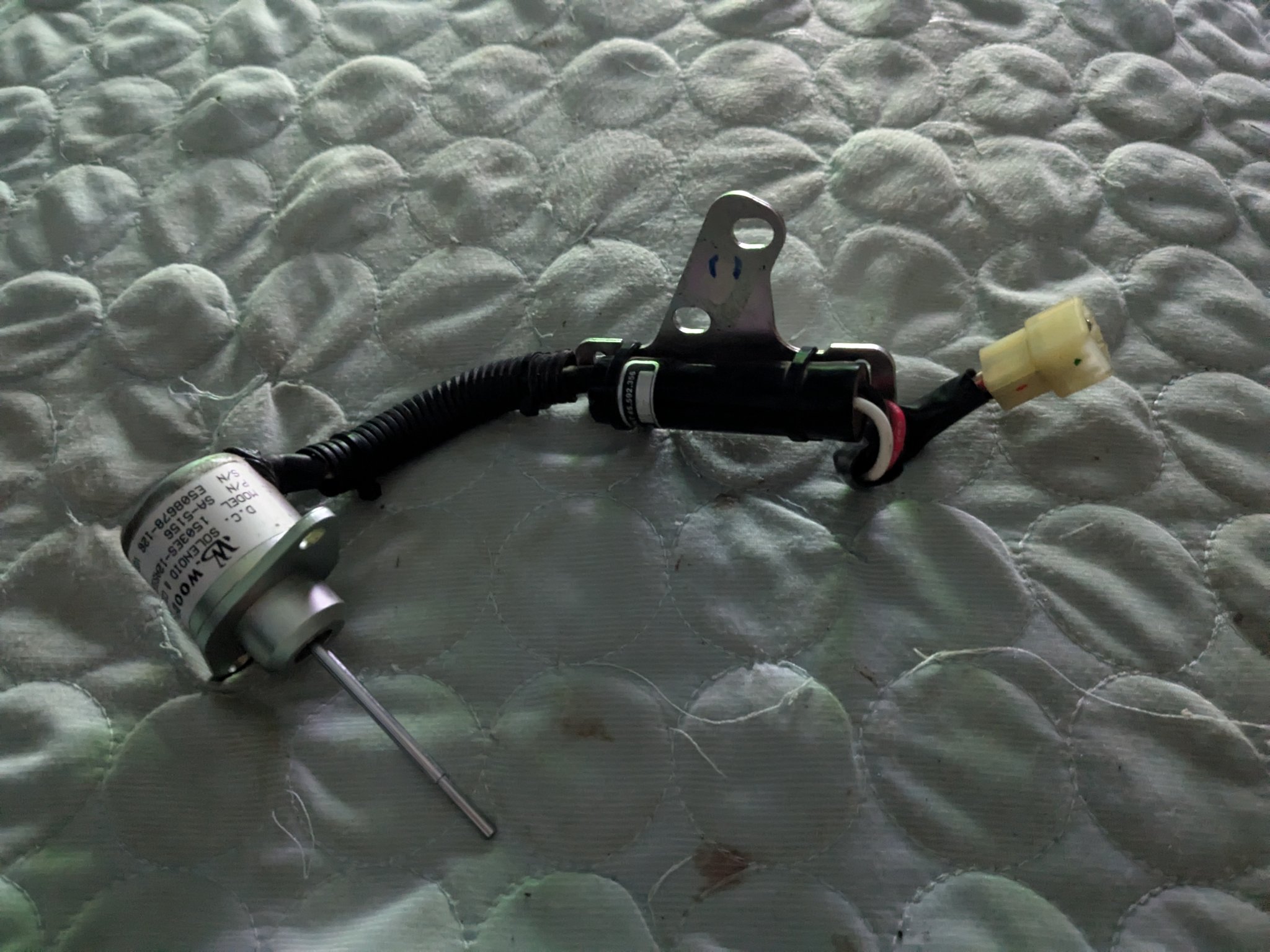

Just stopped while running. Fuel shut off fuse blown. Replaced fuse. Turns over but wont start. Took shut off solenoid out and tested. Its no good. Anyone have similar problem?

Ok thanks didnt want to waste another one. 160. I found there is no power with key on at the plug for the solenoid. also found rats nest under radiator but checked wiring and no chew marks. i thought maybe they shorted it out. still looking

oh ok. ya first thing I found was blown 30a fuse for the solenoid. there are four wires at the solenoid and three at plug end with something in middle. Maybe thats the relay?
33,429
8,720
The part on the cable is a cap and diode buffer, the relay will be on the relay bank on the EX.
There is possibly another fuse that controls the relay.
That is a run Solenoid so it get 2 power signals, one signal when it cranks to pull the plunger in and one signal that will hold the plunger in.
