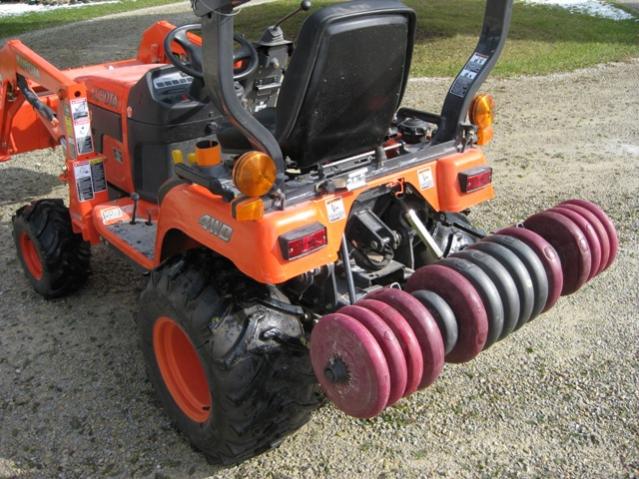

Not exactly a ballast box, but counter weight none the less. You can pick these old weight sets up at garage sales for just a few dollars. Depending on the size of your tractor, this idea may or may not be enough weight. But for my little BX, it works great.

L4750, that counterweight looks good. I'd never thought of that.

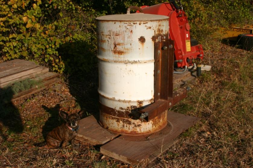

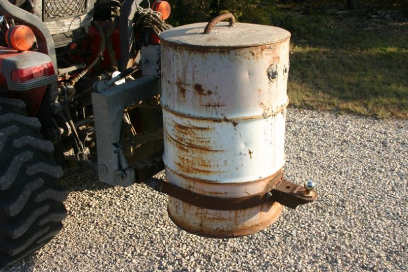

Here is a couple of pictures of the one I made for my L35. I figure it weighs about 900 lbs. My helper only weighs in at 9 lbs, but her job is to catch any field mice or rats that might dash out when I move something.

Nice barrel counterweight, Pat. I especially like the hitch ball on the back for "multi-tasking". Good thinking!

Thanks! Always glad to get a compliment. I hope to get some time, sandblast it, then spray some paint on it.

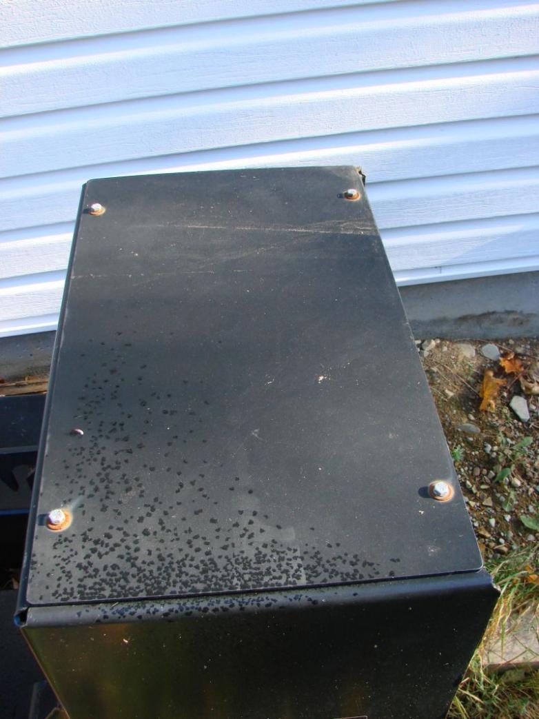

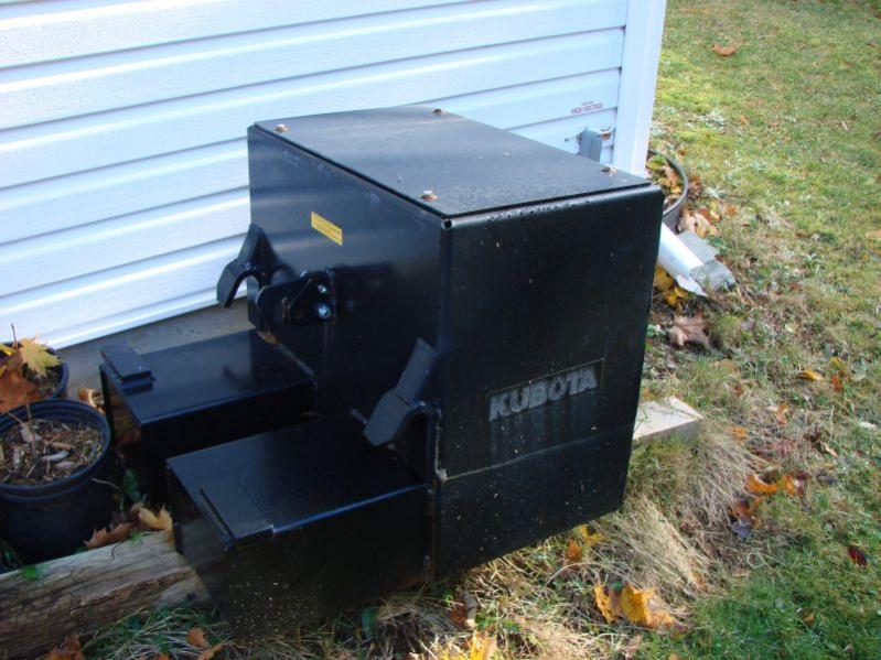

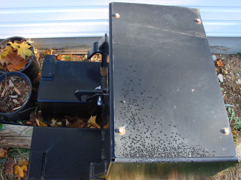

Here you go buddy. I snapped a few photo's of the ballast box that came with my tractor. I've never had it on because I never take my snow blower off but this thing is slick.
If I remove the top bolts there will be a steel shaft inside that goes through the two lower 3PH stabilizers. The ballast box attaches to them and the top hook of the box keeps it from falling off. You fill it then with whatever you like for weight and reattach the cover. It's simple and a very nice design. When you want to remove it just let your 3ph down and flip up the top hook and drive away from it. Nutten to it :D
All is well up here although it's not very white. Hope all is well with you on your end. Thanks for asking.
The Kubota model number is LM8244 for this ballast box.
