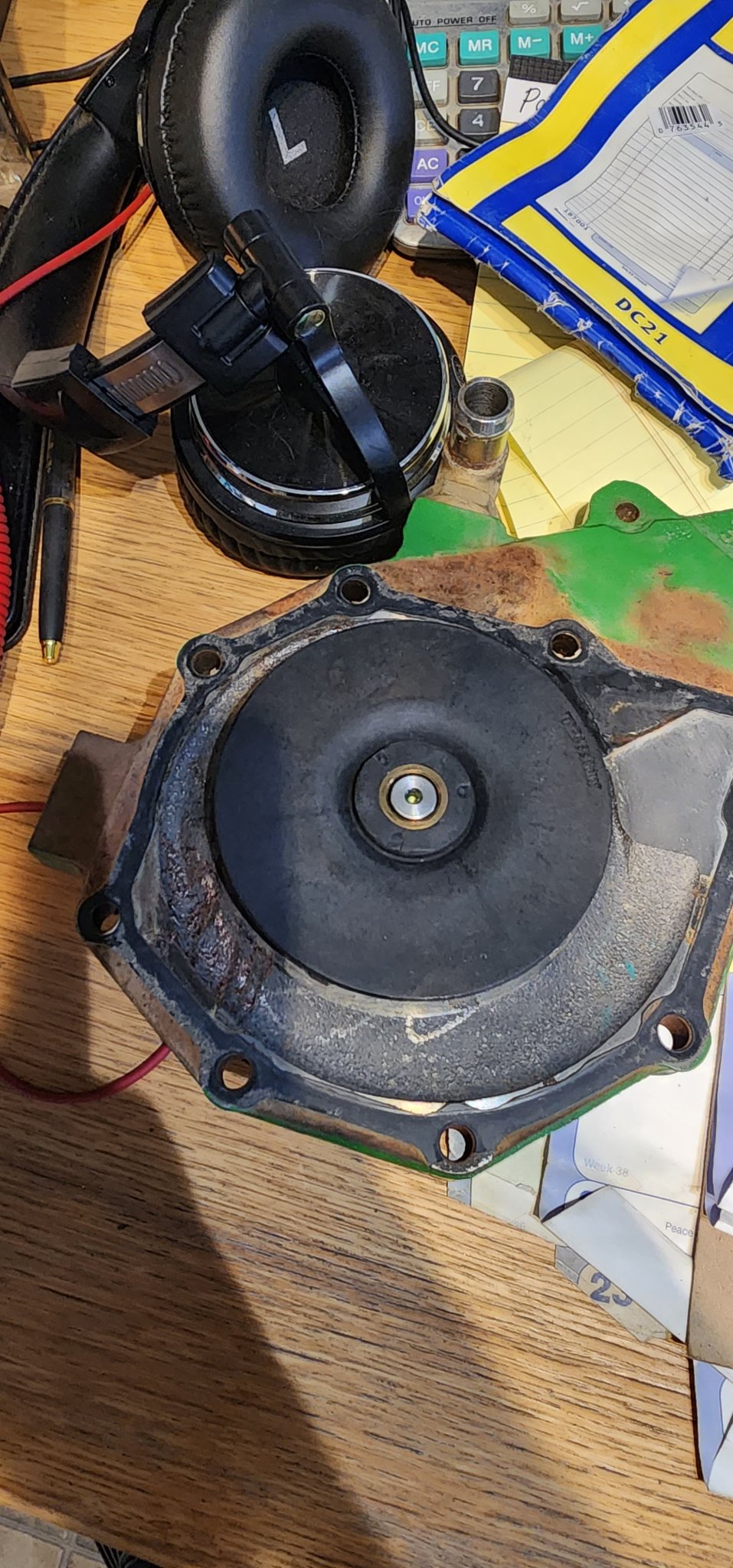

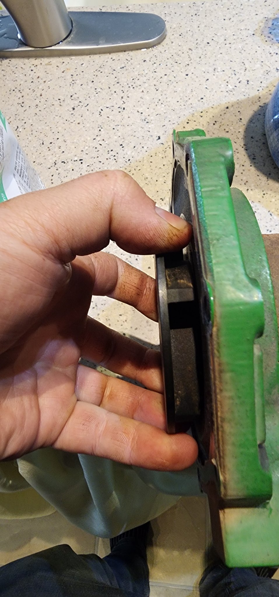

Well the new water pump definitely helped circulation alot, didn't fix my heat.... everything is improved except the air issue is somehow worse???
