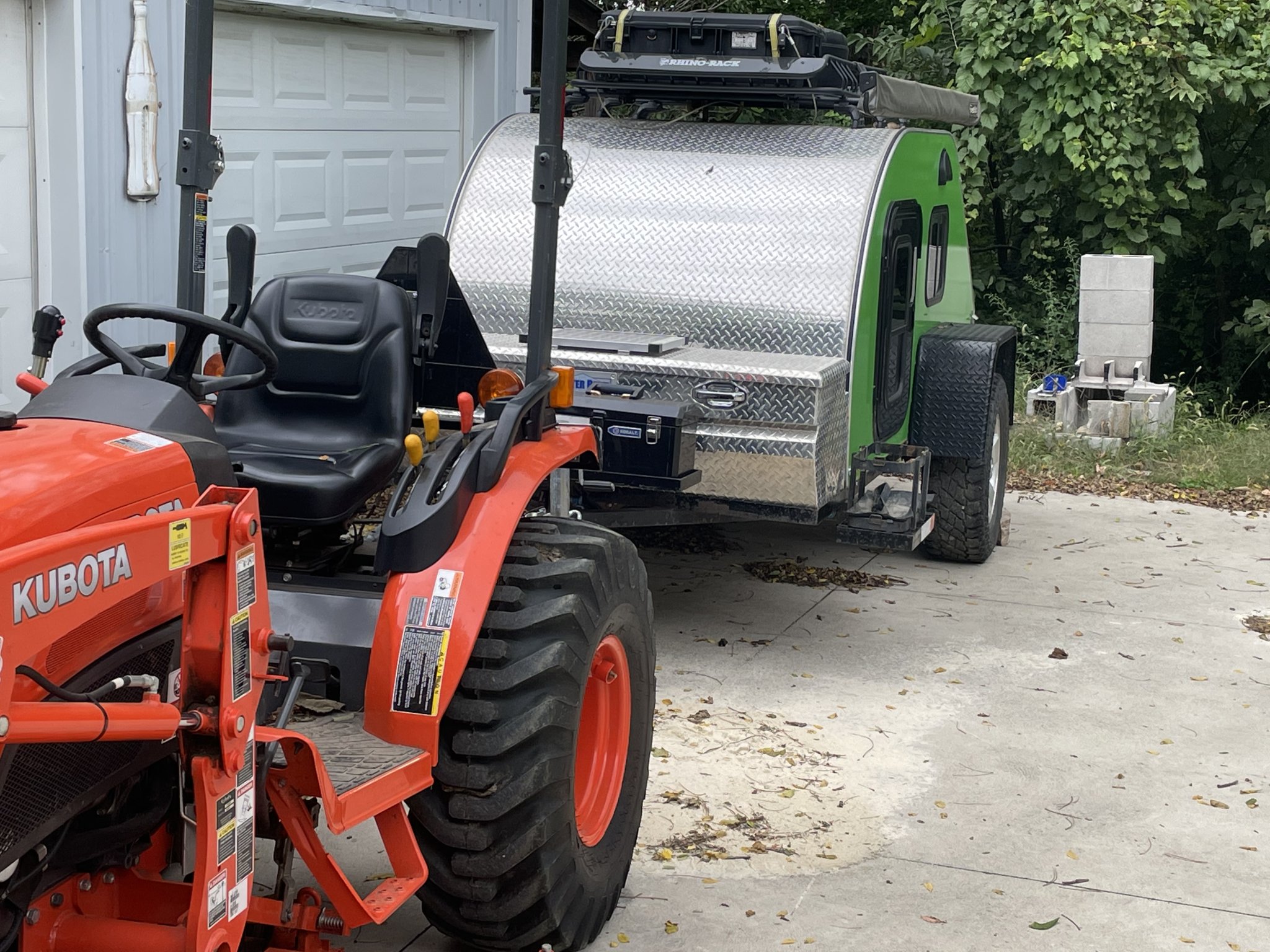

PS…I pull a camper with my B. You clearly have a bit more class with your machine and camper though 😂. I am on the micro scale.
Cool camper! Just the right size for me and the wife now that the kids have moved on!
GrumpyFarmer
3,018
4,029
Thanks. We normally have it behind our FJ for expedition like travel. It’s a got a lock n roll hitch and it tracks very nice behind the tow vehicle regardless of terrain. It has 22” ground clearance so can go about anywhere the FJ can…limiting factor is the width of tires / fenders…it’s wider than the vehicle. Has a queen size bed in it…but there is no standing up in it. It has a small awning and a side tent for the dogs.
