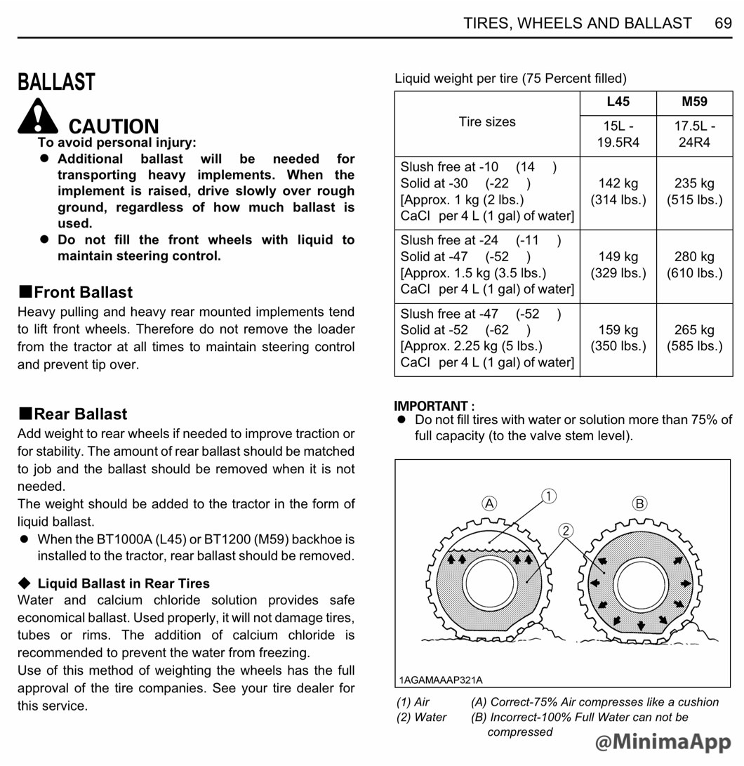

You shouldn't be leaking any juice if the valve is at the 12 o'clock position. Clean your valve stems and valves before re-assembly.
Yes you will because the tires are filled to the top of the rim with the tractor jacked up. So when the tractor is down off the jack and sitting on the tire, the ballast, rim guard or washer fluid, is compressed so that it is no over the top of the valve stem.
Sounds like they are overfilled to me
SidecarFlip
Banned
7,182
557
That is for CACL, not beet juice or washer fluid. Not really germane however. If you fill the tube with any liquid ballast with the tire elevated, once the tire is lowered to the ground and the weight of the tractor compresses the tire, the liquid will be at a higher level than the valve stem (which is in the lower part of the rim, in all cases. Any liquid seeks it's own level and when compressed (by the weight of the tractor itself), the liquid will always rise in containment.
That is 100% correct.
I think even if they were half filled you would get a little bit come out when checking pressure. Just from what is left on the valve stem from tire rotation. There wasn’t a lot.. just not use to having anything but air come out of my tires when checking pressure.
