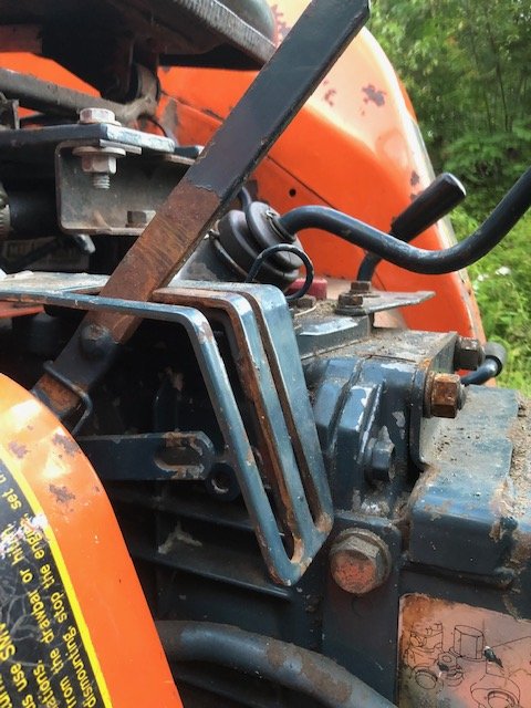

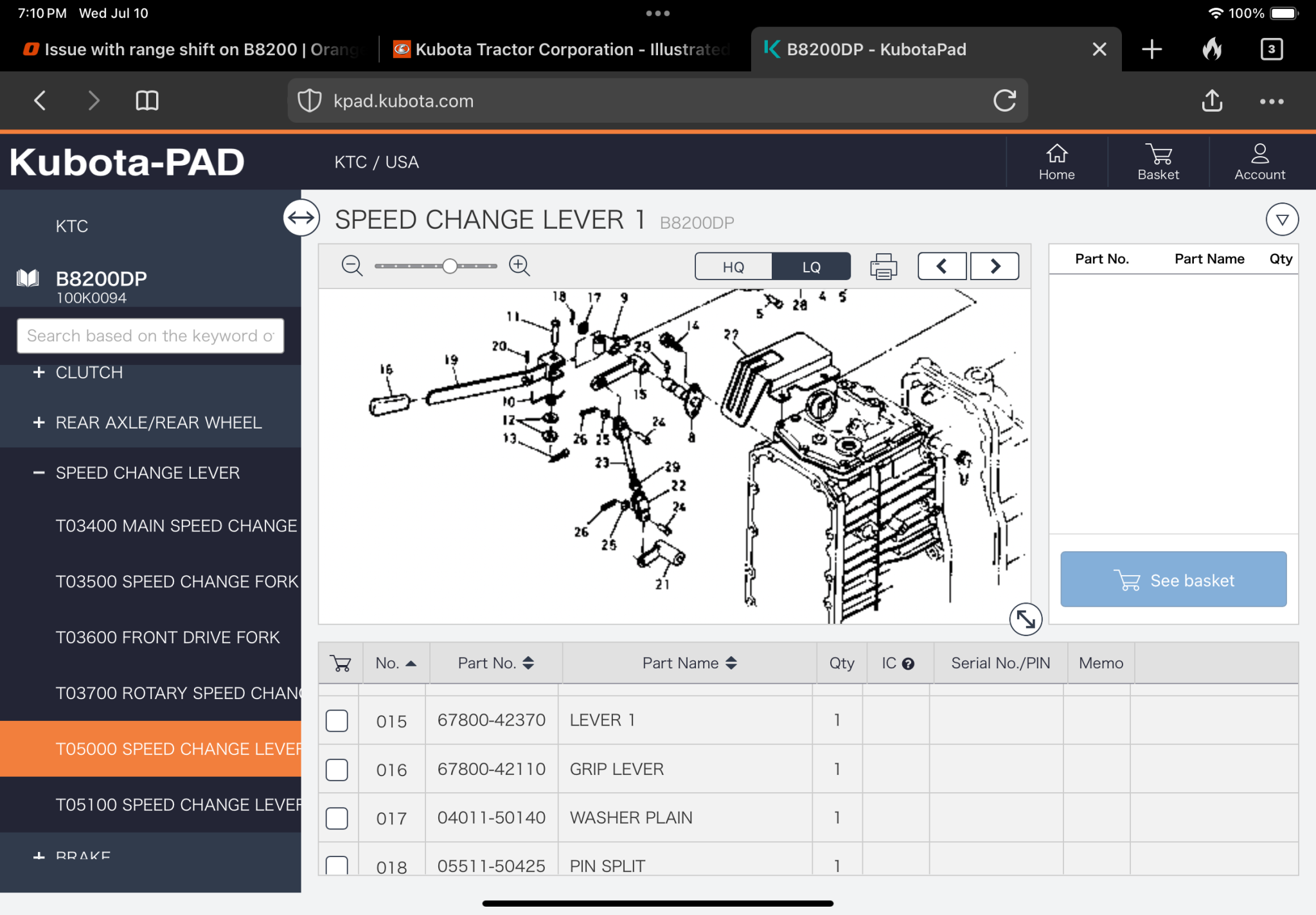

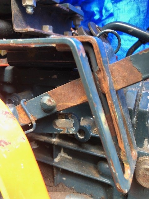

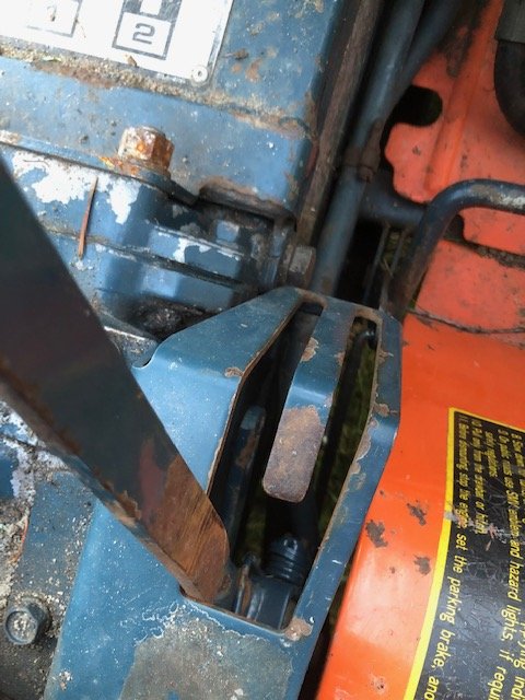

Brand new here. Just got myself a new to me b8200, about 450 hrs on it. I've got 40 acres in Ontario, gonna use it for that. Ive been grading and doing some mowing it's running great. Guy I got it from seems to have taken good care of it. I'm having one issue can't get into the lowest or highest range gear (range is what I'd call it, not sure if there's a more accurate term?). Previous owner said he had no issues, can't tell if something got knocked when I was transporting it. It's the range/gear that would be down and closest to the inside of the tractor. When I go to push down the range lever seems to be hitting this other lever (the one with the oval hole in it). You can see it in the pics. There is a tab on the range lever that almost seems it would slip into that oval hole, but just won't go. It's new to me, so don't want to force anything. Got the manual and couldn't find any mention/image that helped, thought I'd check with y'all. Anybody with a b8200 got any advice/ideas? Thanks in advance everyone.
