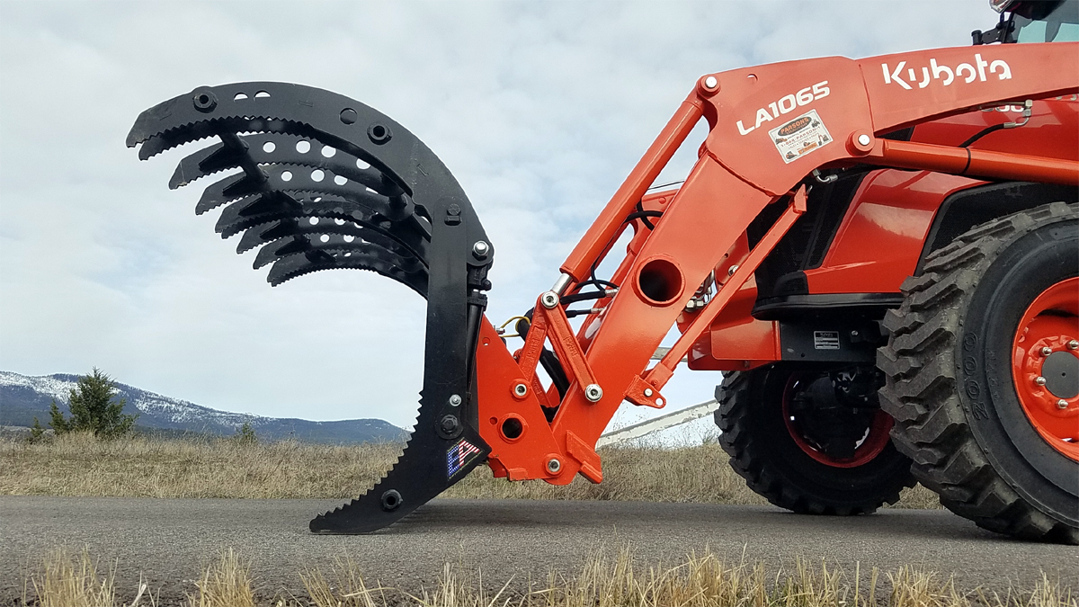

I have a root rake grapple (EA Wicked 60) and the lower tines are quite short (see photo). I haven't tried to run it over the ground to pick up sticks and such, but if you go slowly I think it could be done. But as @North Idaho Wolfman said, the closer the lower tine length and geometry resembles a bucket the easier it'll be to float the grapple over the ground while still being able to get under sticks and such.
Ahh okay that makes more sense! It was a geometry issue! I think the teeth on mine are a little longer (and flatter) than the ones from your picture so will try it out carefully and see if it's even helpful. Thanks again for all the tips and guidance @McMXi and @North Idaho Wolfman
