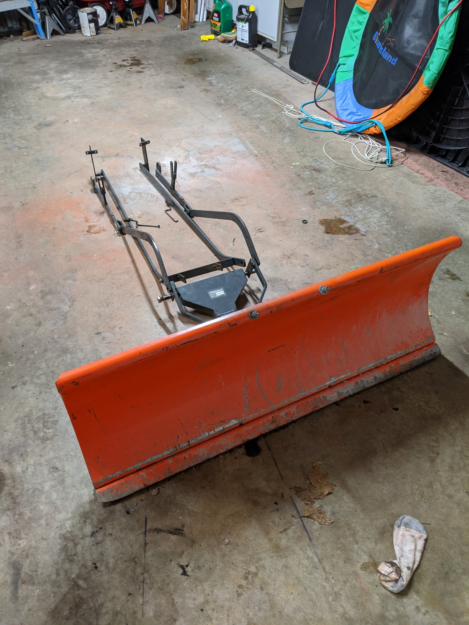

Steve, yes they exist. I have one. Besides snow, it moves loose dirt very well too.
But i have never seen one like that shown above for a G5200. What model blade is that?

I finally found a Kubota snow ploy for my G5200. The model ID tag is missing, but I'm pretty certain it is a model G2001. The 48" blade looks like the one above, but it attaches to my G5200 differently.
Mine has a single long arm or beam that attaches to the blade on the front and then travels the full length of the tractor where it attaches with a single 3/4" bolt to a plate that's bolted to the bottom of the transmission at the same place the trailer hitch bolts on. About mid-way the beam has a crossmember that attaches to the same mechanism that lifts and lowers the mower deck. Does the same for the plow.
Sorry I don't have a picture. You can find one by googling it. The ploy is like new and I paid $150, which I thought was a good deal. Snow fall has been light so far in Missouri, so I haven't had a chance to try it yet.

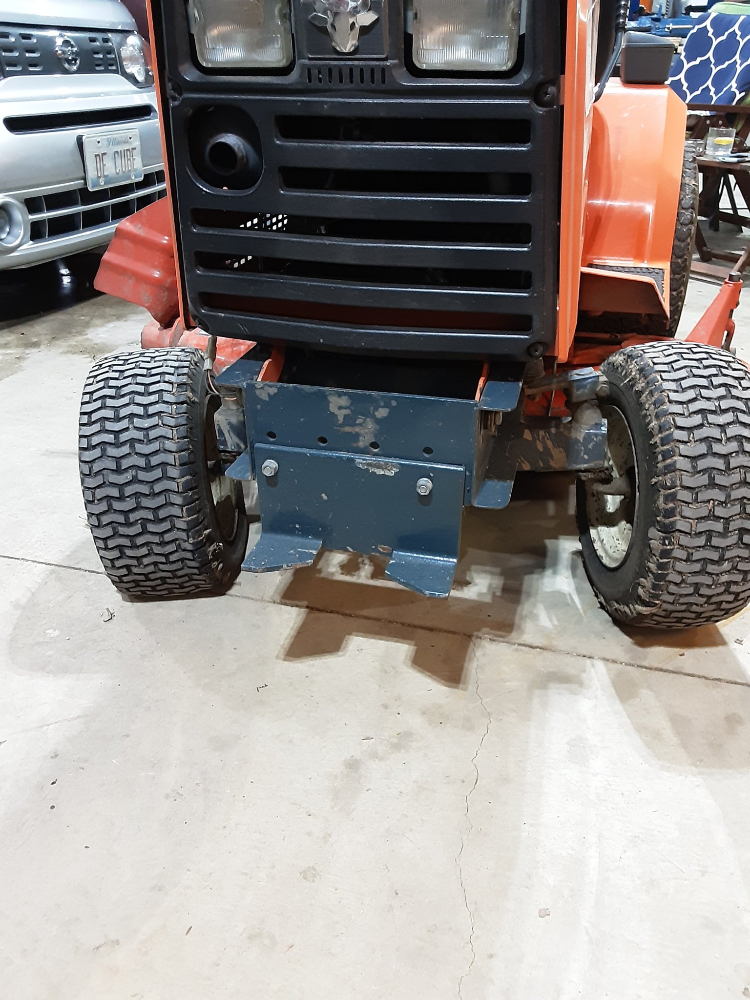

That was a fair price. Did you get the front bracket as well? If not you can make one from 4x4 angle. The vertical piece on the front portion of that rail pushes against this bracket. It basically transfers the force of tractor to the blade.

This is the bracket I made from some L-angle. The vertical channel on the plow frame rests against plate when plowing. You can see where paint has rubbed off between the two bolts. I think the factory bracket might have a tongue that extends down to add additional surface area, but I didn't have a welder at the time to fab one on.
When plow is pushed against something, there is a slight amount of flex (probably in the loose bolt connection and some deflection in the full length of channel that runs fore & aft) to allow contact on front bracket. Been a awhile since I had plow mounted, but thinking 1/8-1/4" of gap when not plowing.
There is hole in vertical channel to allow a hitch pin to be inserted when plow is raised. With pin inserted, lower plow and bracket will carry weight of plow for other duties when not plowing.

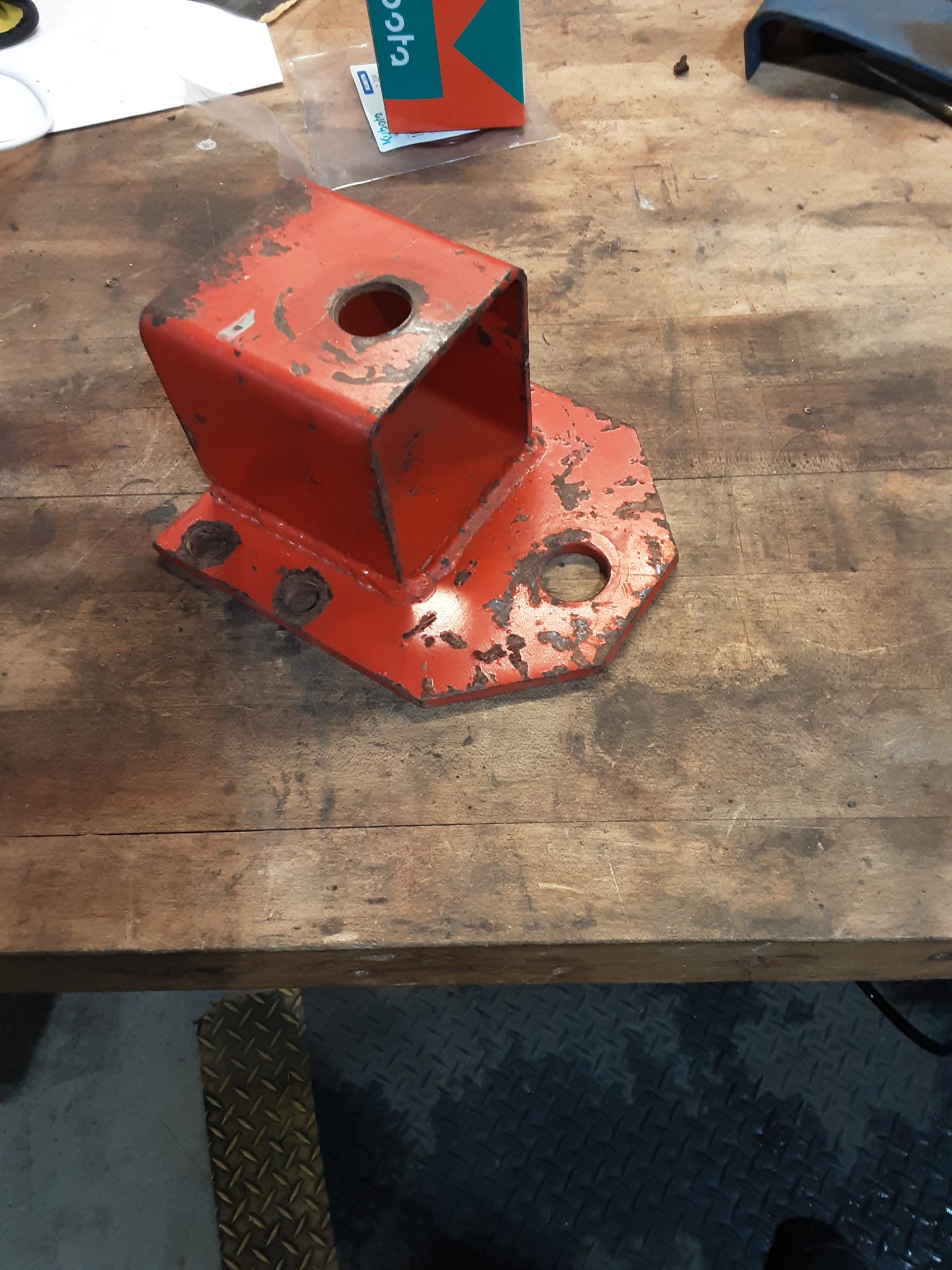

I will find that rear bracket and photo it...its in the shed somewhere. I never used it because it would not mount on bottom of axle housing due to a drain bolt in the way. Spacers would solve that, or boring a clearance hole.
The factory ball mount already had the clearance hole, and the rest of the geometry was correct anyway. My guess is the square tube on the rear plow bracket adds some extra rigidity, but for the little use it gets from me, not having it has not been an issue.

Found it! 5"x6"x3/16" plate, with 3x3OD X 3/32 tube. 7/16" mounting holes. A 7/8" ball hole, exactly 5" & 1" OC from the ends.
Again, it would need spacers or a hole bored to clear a plug in bottom of axle housing. I would wager there is supposed to be a rubber bushing between the u-channel on plow and this plate when bolted up to allow for some flex. You cannot tighten the bolt up. I think my bolt has a pin as well to keep nut from falling off.
