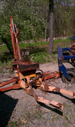

I have found a Kubota brand back hoe with the hydraulic pump and controls.
It comes with sub frame arms and a seat.
I am concerned about overloading my B6200.
Can you guys tell me if there was ever one made for it.
If so what size was it?
The seller has no numbers on his.
Thanks for anything you can give me.

So far judging by the picutres it seems a tad too large. Anyidea the size of the boom on the hoe you have in question?

I can't help with what model that is, but it's not a B670, which was fitted to the B6100/B7100 series.

Yes it will fit a 6200 but you may need to double check the subframe mounting points.
As far as size is concerned , its fine, the pic does make it look bigger than it really is.
I have a parts and owner manual for the same unit in my desk somewhere, bought it on ebay a while ago just in case it came in handy.
this backhoe will also also fit B6001/6100, 7001/7100 and maybe afew others but subframe mounting holes may vary on others.
I would say 6001/6100 would be the smallest fitment, i'll have a rummage through my kubota files to find the relavant docs if thats any use.

Just been in the files, according to my official owners manual, it looks to be a Kubota 130 backhoe model, (KB130)
digging depth: 6ft , reach: 9' 2" , arc of swing 135 deg etc
buckets, 8" , 13" and 16" widths.
operatring pressure: 1800 psi, flow rate @1000rpm at PTO is 4 gpm, system capacity 4 gallons.
you may find it labelled as a differing model in the US, but in my manual is says worldwide spec.
The K629 backhoe is pretty well the same unit also.
your backhoe is missing the hand rail that bolts onto the backhoe chassis though, may have been damaged and taken off..
hope that helps.

That's helpful, Rob. I just have to figure out where to pick up one here in eastern Canada. Thanks.
