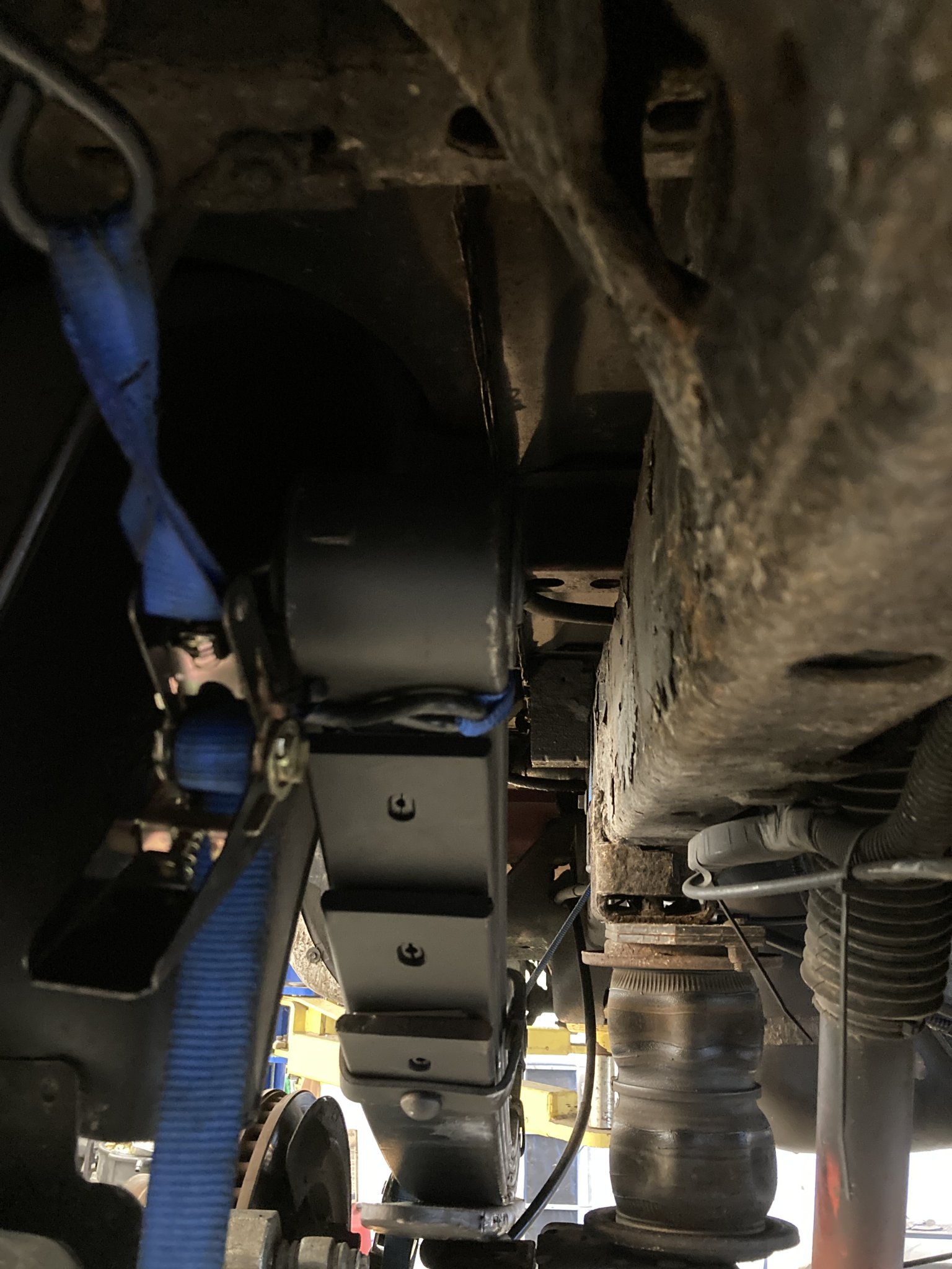

Life takes over so in the “mean time” I throw a set of “air bags” on it…..Sort of a Band-Aide temporary fix.

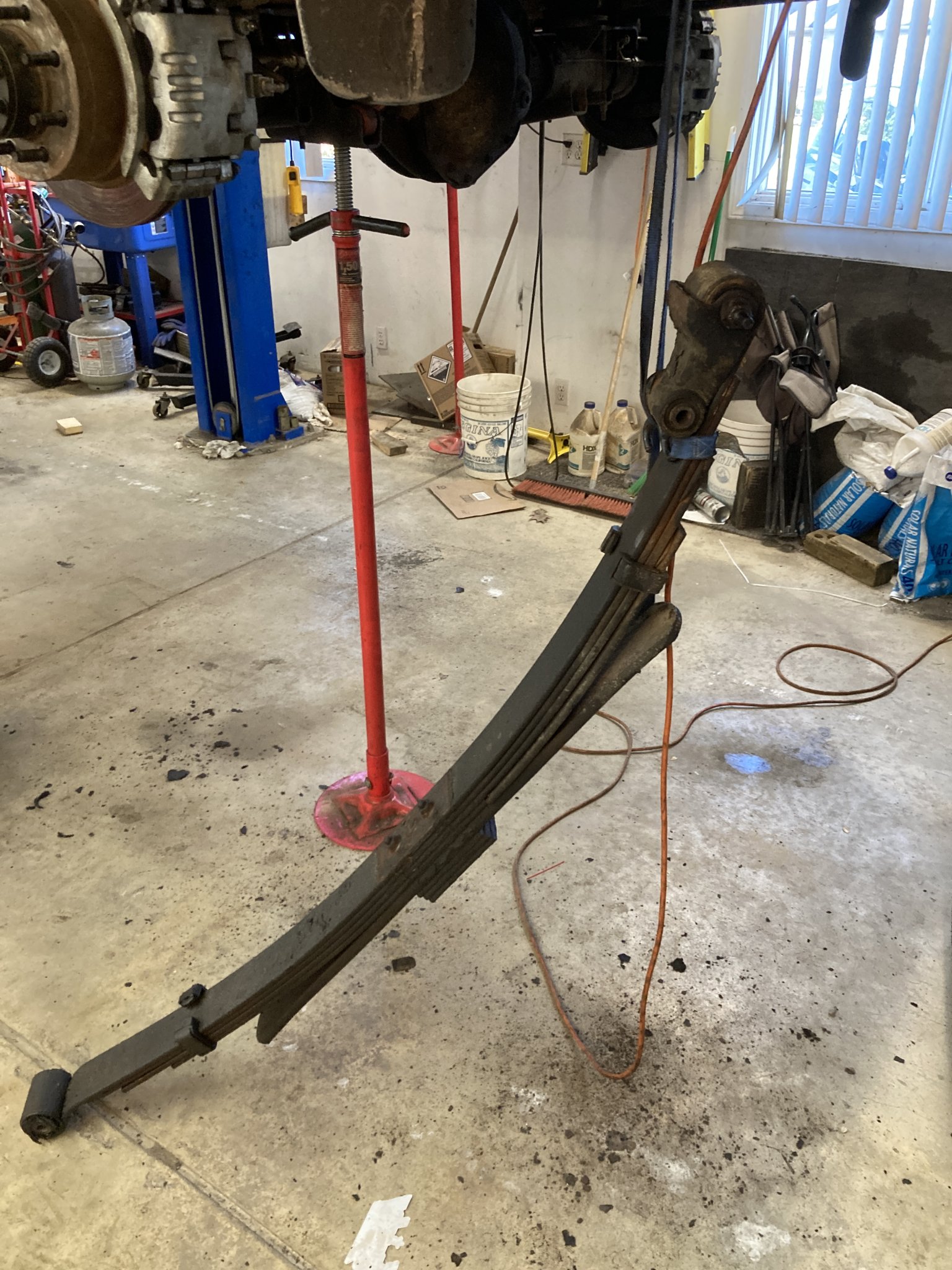

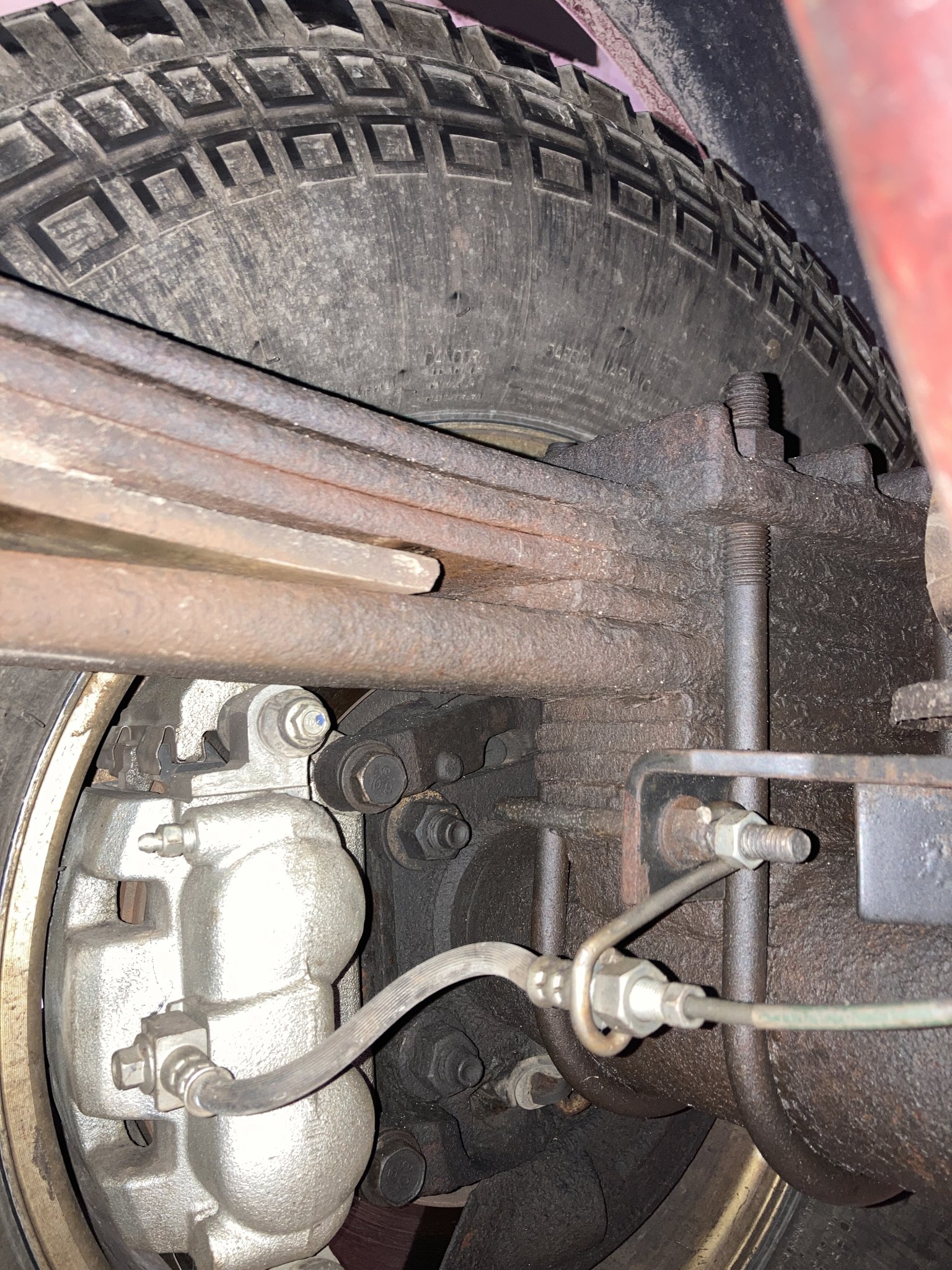

Here is the “Before” pic….It seems to have been “growing” since I first saw it….
Internet problems…..to be continued

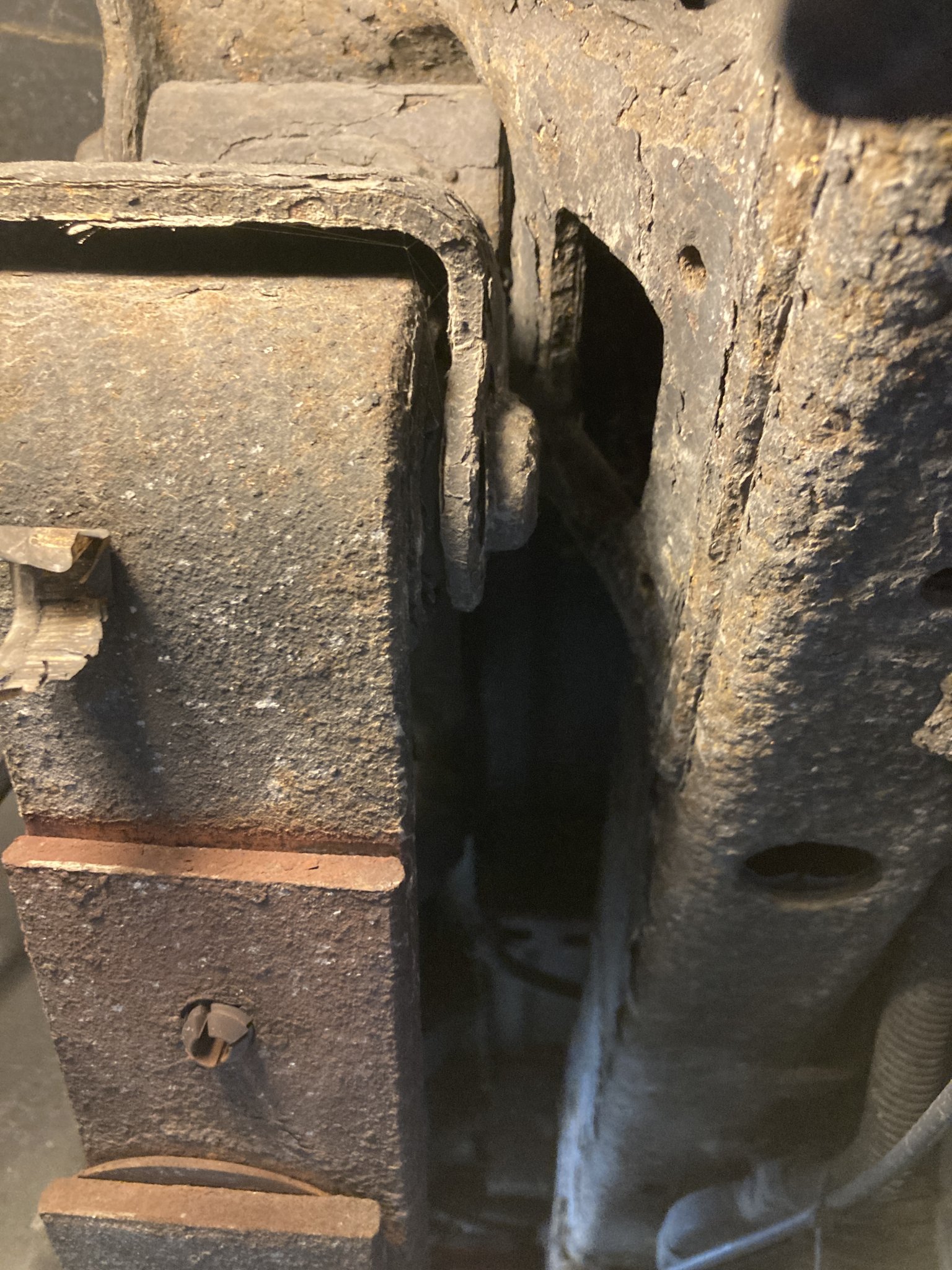

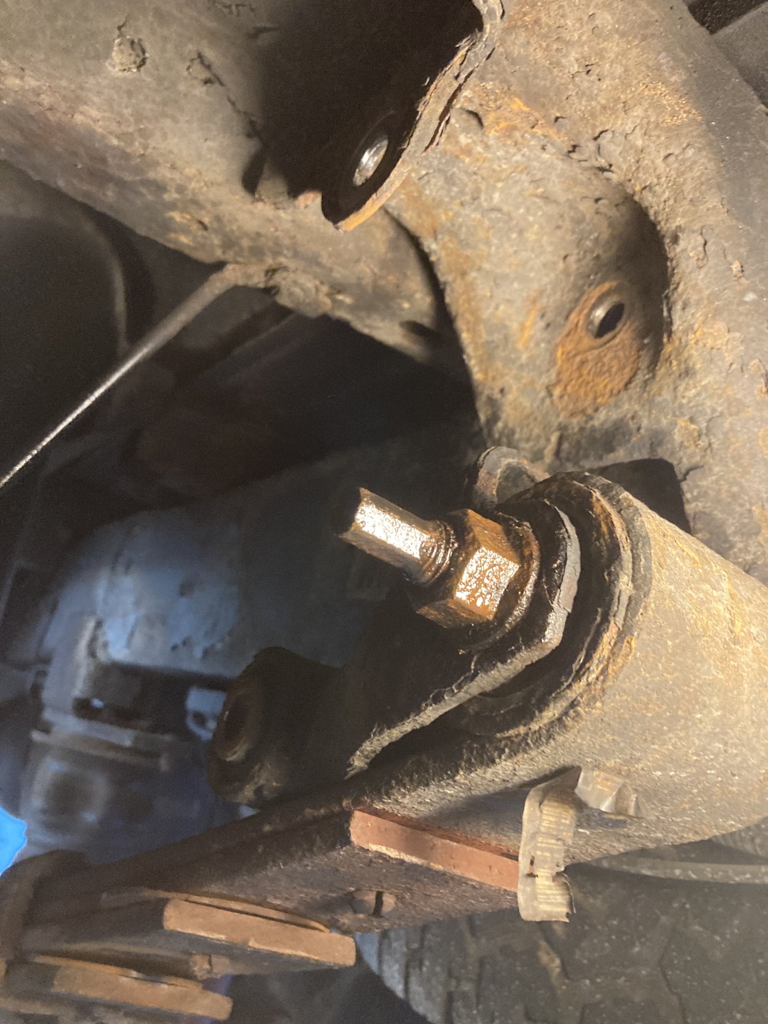

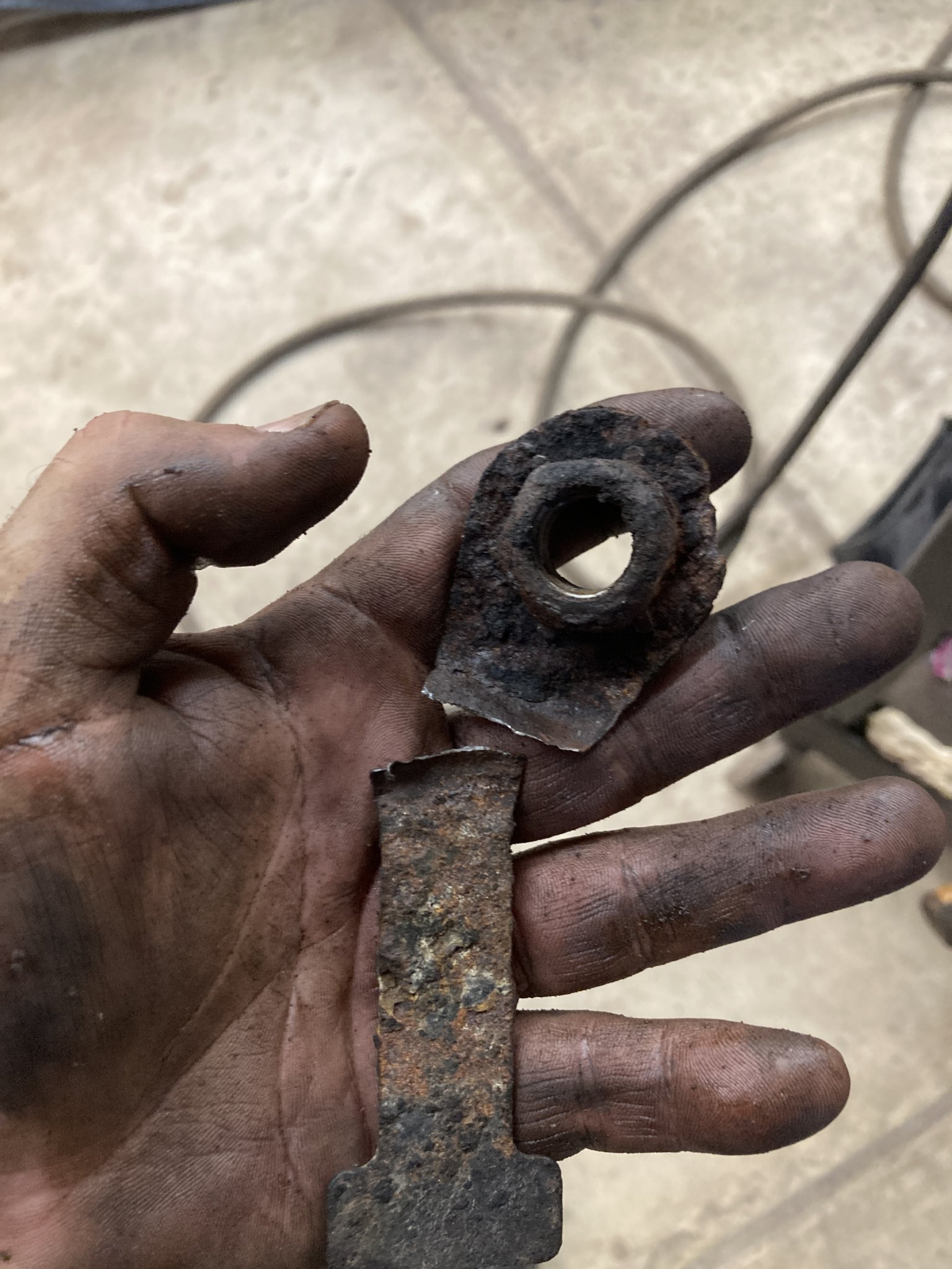

I am very confident that after 20 years, the “flame wrench” is going to be called on to cut the bolts off….
But to my surprise, after soaking them for a few weeks now, I end up getting them off and they look surprisingly good.
Then it hits me like a “sack of hammers”.....I realize that I have never done a set of leaf spings…ever…..on any vehicle..hmmm.
I am kind of shocked by that fact, but it’s true…..never..

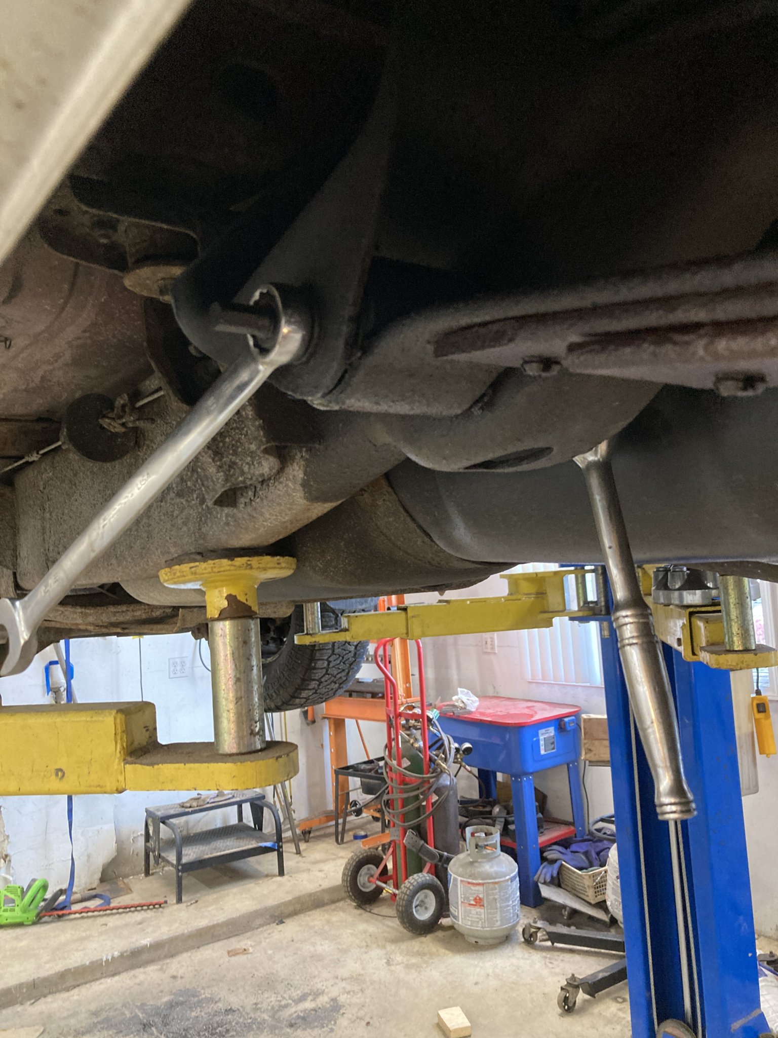

The worst nuts to get were the top ones, because the little arm that stops it from spinning was rusted through on both nuts.
But with the help of some "cursing and swearing" I was able to “fish” a wrench in there and eventually get it out.

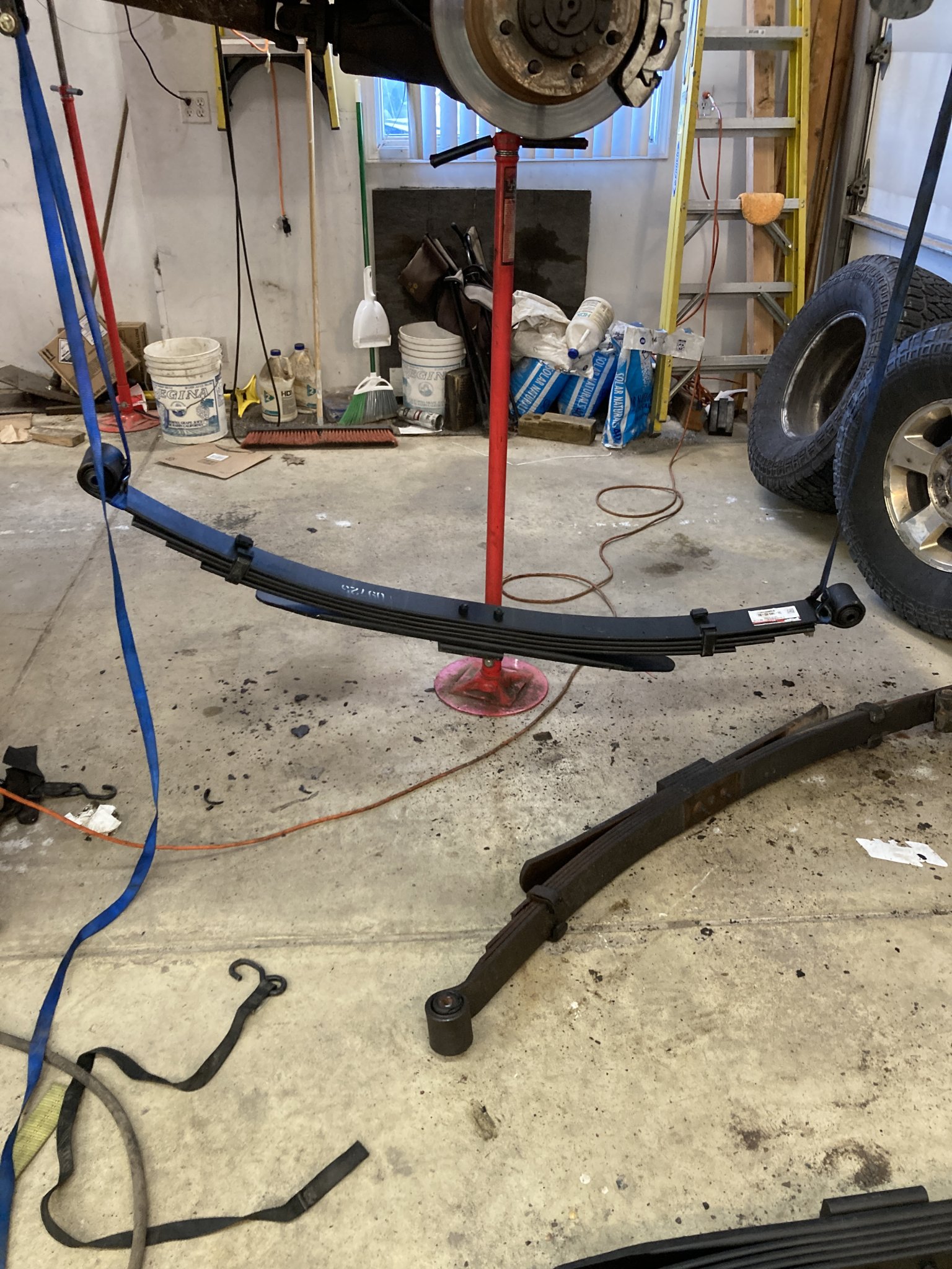

Now I just gotta get this "heavy-ass" thing out......then back in.
Well "back in the day" ......young "20-something Paul" would have just lifted this thing out......
However, "mid 50 Paul" has decided that trying to "muscle" this bad boy out, will most likely "end badly".
So I look around for a few minutes, and come up with what I believe to be a "solution". to my "gravitational acceleration" problem.
Straps........

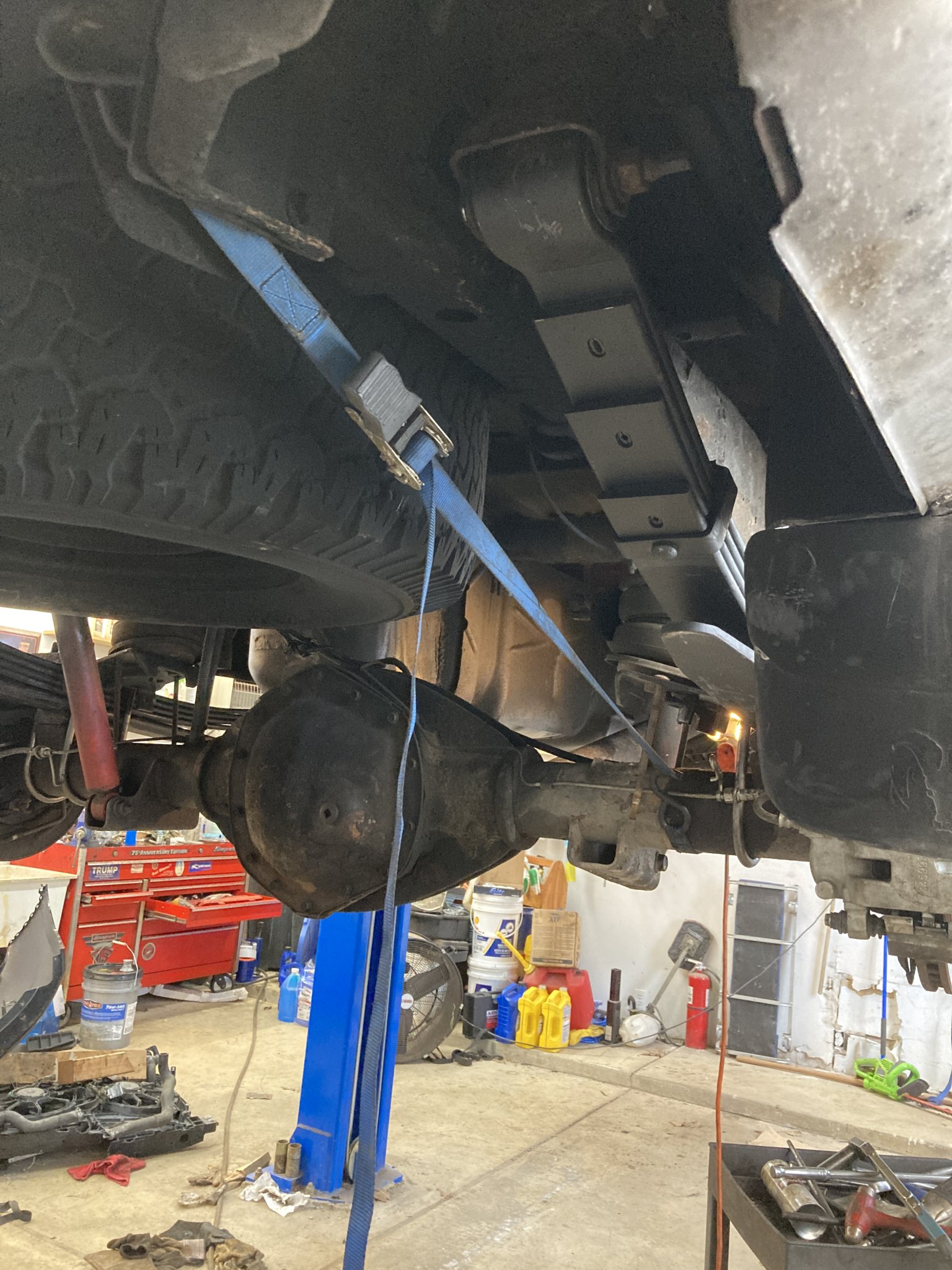

I was able to use this strap to hold one side, and then I could lift the other side up....just enough.....to get it over the brakes.
(As I type this, I am wondering why my "dumb ass" didn't just remove the brakes in the first place, ????? hell everyhing is new and it wouldn't have taken much.........But I also wonder why I didn't buy all the "Google" stock I could afford back in 2004.........Shoulda, Would'a...Could'a..:rolleyes:)
At any rate....I use the strap to help lower it out.

The whole "strap idea" worked pretty good, so that is first and foremost on my mind.
Therefore, I start looking for some more straps, so I can kind of "work it, back and forth" in order to lift it in place.

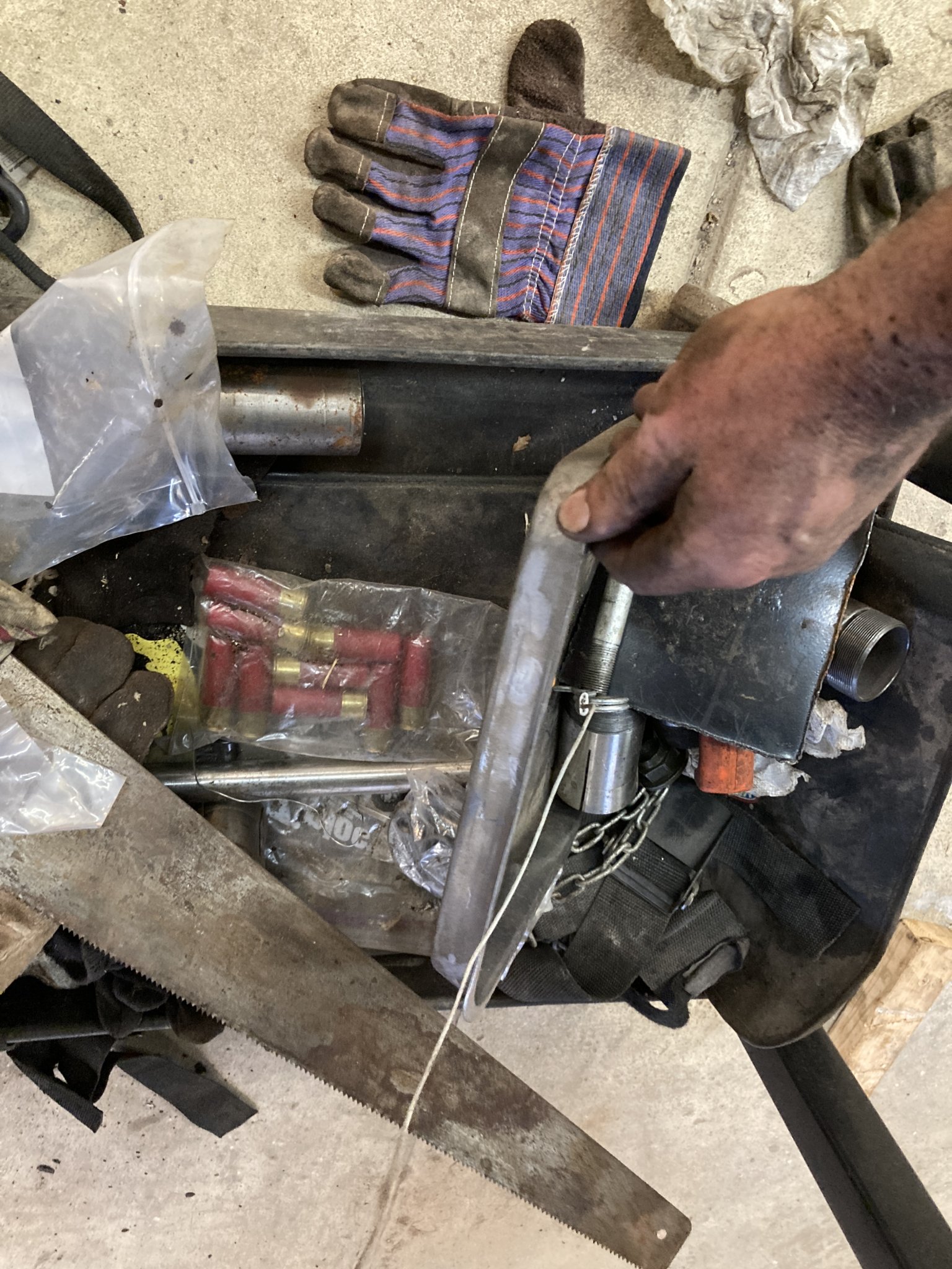

Hahaahah.. the first thing I find, is those "shot gun shells" I was looking for about 2 years ago.....😂😂

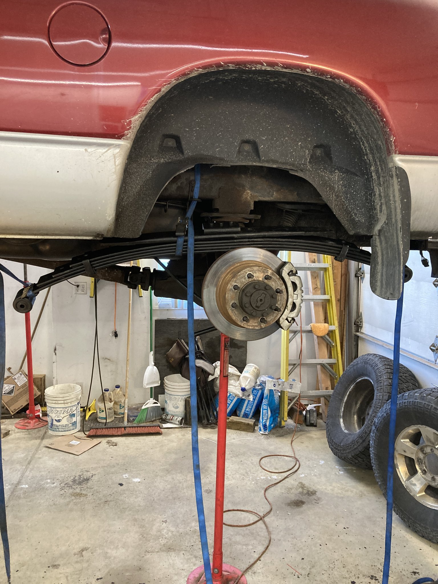

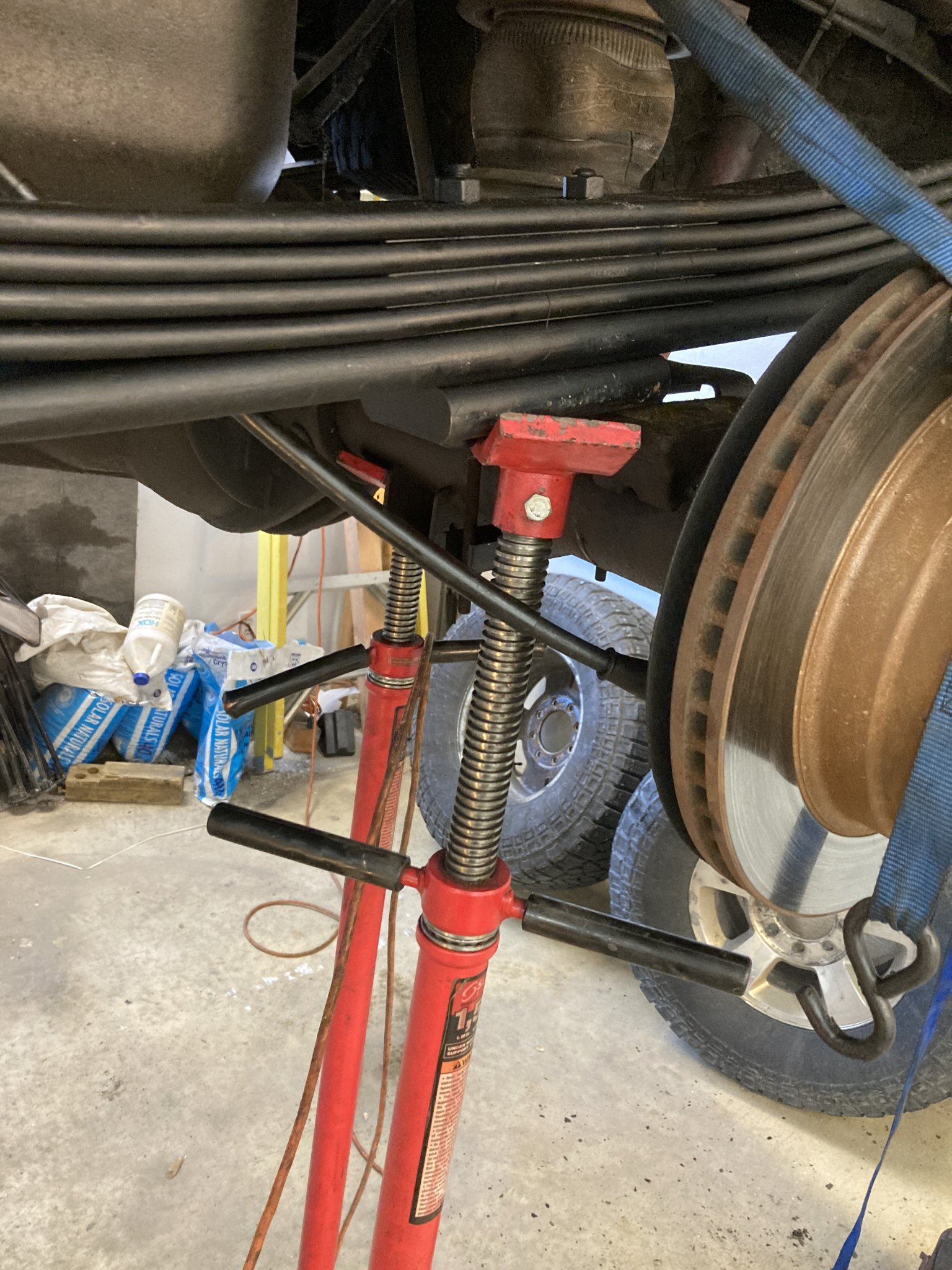

Well I start rigging it up

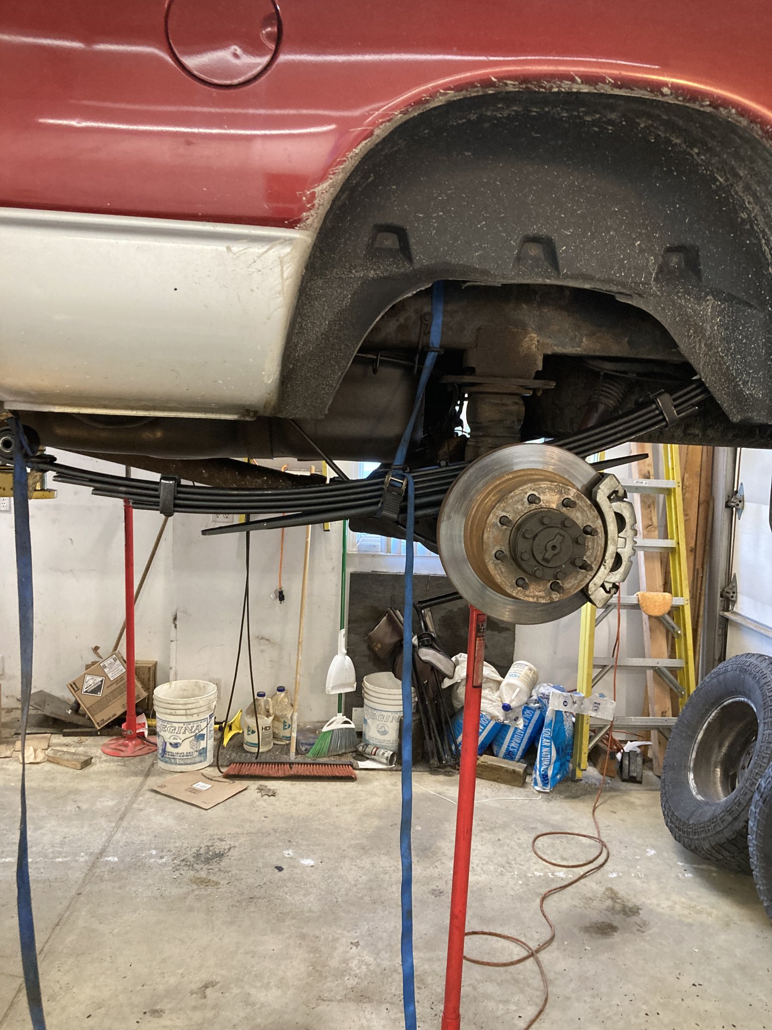

Slowly I work each side up, then go to the other....blah...blah...blah....

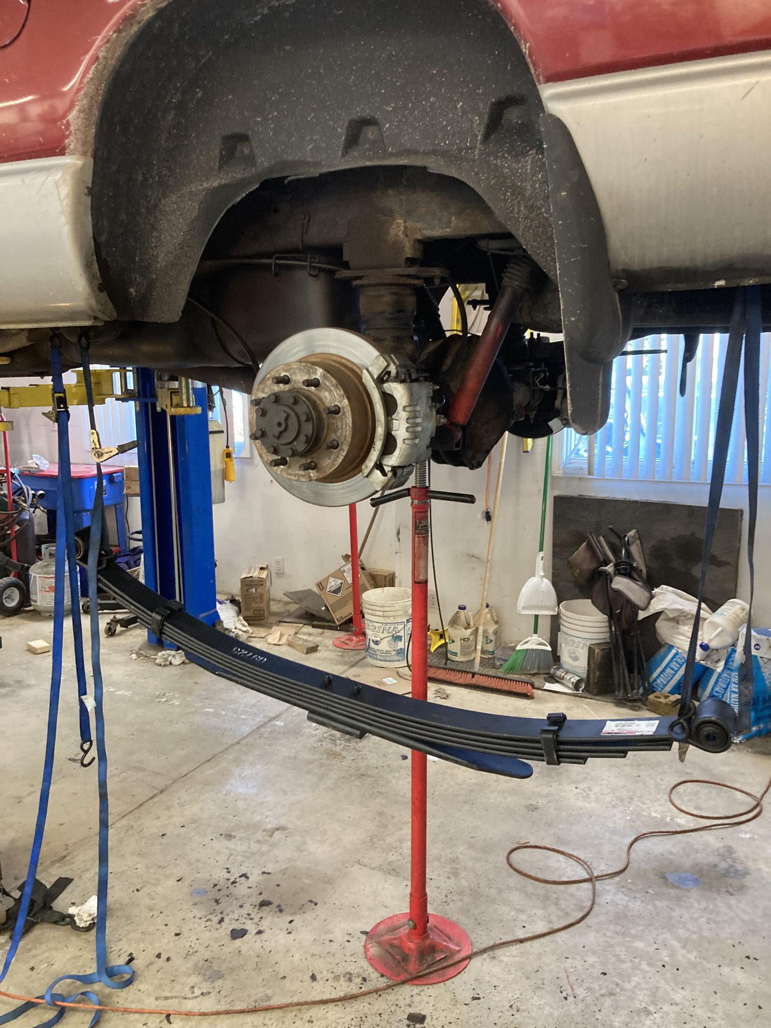

Now I decide to to "flip it" for some strange reason.........
Well that was a "poor choice".........
I probably wrestled with that thing for a F'ing hour and a half.....I was trying all kind of sh!t......that thing fought me "tooth and nail".
I finally got it "flipped back"....but I "vowed" not to make that mistake again........
It took a little prying to get it to "seat" on the axle, but with a little more "cursing and swearing" I finally got it.
Now that I "know the score", the bolts went back in rather easily.

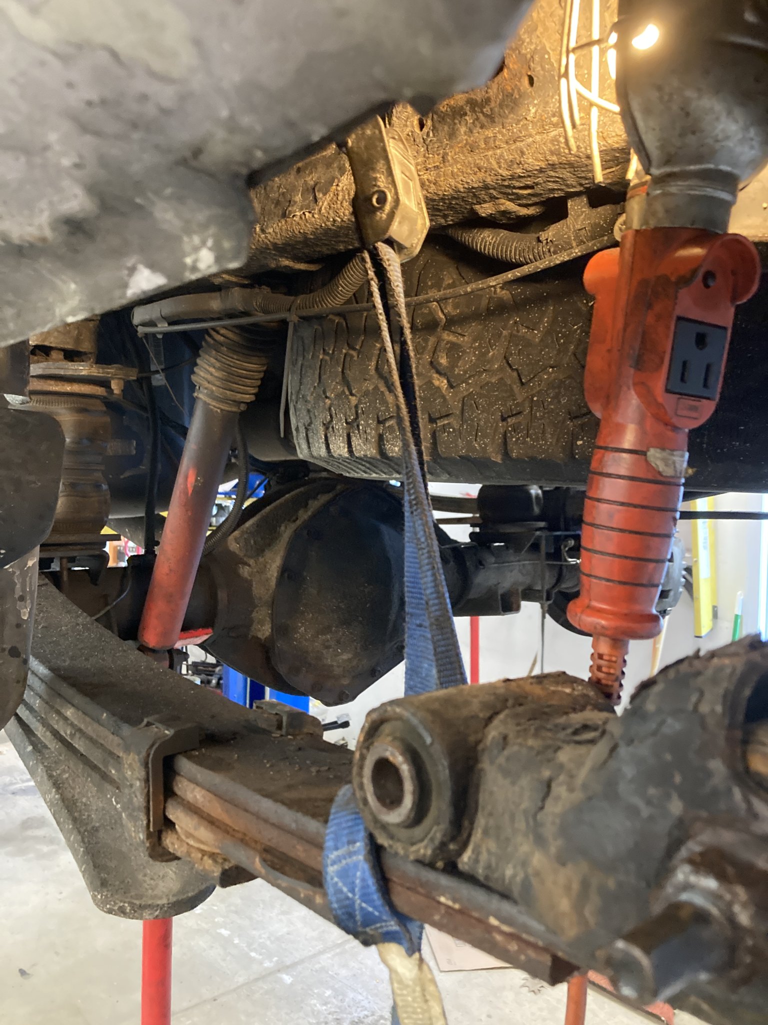

One thing I learned was that attaching that "strap" to the bumper bracket to pull the axle in place so that you can pry the axle onto it's "perch" is way, way easier than "muscling" it. (pic below)
