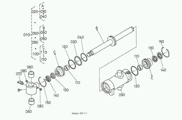

Based on the illustrated parts list, I would say yes.
MDHughes, You responded to this question a few years ago. I have a similar question. The illustration shows the parts that make up the steering cylinder for a gang of Kubota tractors. Mine is a L2900DT 4wd. I also found it in the parts manual (pdf). Can you tell how to get a complete seal repacking kit that includes all of the sealing parts? Your help is appreciated.
Thanks,
Jack Lithgoe
There is no seal kit, you must order the seals individually.
