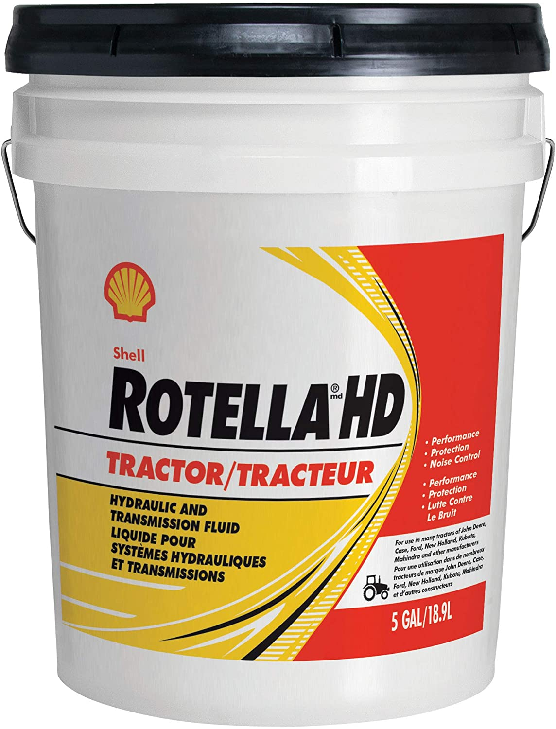

I have an unopened 5 gallon pail of Shell Rotella HD for some reason (lost in the mists of time), and I'm trying to figure out if I can used it in the transmission of my BX25. I have tried researching it online, and have come up blank.
Does anyone know if this fluid is compatible? I figure it has to be better than the Tractor Supply stuff I just had to put into my BX after my rollover problem. It's overdue for a change anyway, so I'm going to do the filter and fluid change, and it would be nice if I can use a quality product that I already have.

well if the bucket says it's compatible, it's a liar.
kubota doesnt' give the specifications of their fluids other than engine oil (SJ, etc). So how do any of the other fluids get their "meets kubota specifications"???
They don't...the only specification that it meets is the size of the container (5 gal, 1 gal, etc). The higher up's at kubota have advised us of that fact.
UDT and super UDT2 are proprietary, nothing else is truly compatible to my knowledge which came from the teachings of those who are actually in the know. That's all I can tell you.

If it's an HST, I would only use Kubota fluid. Gear drive, Rotella. I use the Rotella in one of my M9's (other has Chevron in it).
My 2 cents, take it for what it's worth. Personally, I wouldn't use TSC store brand fluid to start a brush fire with. it's JUNK.

No, the bucket doesn't say anything about Kubota, but if it did say it was compatible, I'd believe it. Shell has the resources to verify such a claim and too much to lose to make it casually.
On the other hand, Kubota has a lot to gain by hiding their specifications and saying that nothing else is compatible, and since this stuff is neither magic nor rocket science, I do not believe them. I appreciate brand loyalty, but blind fanboyism does not make for good decision making. The idea that only Kubota makes a fluid that is truly compatible is just ridiculous.
When I needed something quick this weekend, I called my local Tractor Supply store, and the manager there confirmed she's been using their Traveler brand in her Kubotas for many years, and affirmed that is is compatible. I have no reason to not believe her, as I have done business with her for many years. Yes, she has a profit motive, but again, too much to lose to be lying about it. While I'm not a great fan of their brand, it will do in a pinch (which was certainly in!), but then, that's why I'm looking to change it to something better.

It is one of those things they are trying to get you to buy Orange parts just like JD tries you to get you to buy Green parts. Your jug says "hydraulic And transmission fluid. Here is a pdf about the oil: Rotella HD.
It should be fine in a hydrostat system. I noticed it is a 10w30 weight so make sure that is what your machine needs.
I would Not mix standard oil and synthetic. That said, as wgator mentioned, even the SUDT2 oil is a blend so does it really matter? I use Rotella in my M9 with shuttle as well.
If you are doing a full change I would use the jug you have.

Kubota is listed on the bucket don't see why you can't use it.
Exactly. They tell horror stories to protect their market.
That doesn't mean that all fluids are equally good, but Shell Rotella products have an excellent reputation.
Thanks very much!
Thank you!
I couldn't find it on mine, but mine is pretty filthy on the exterior.
Yeah but it says "for use in many tractors of JD, Case, Kubota" etc..., not all models of tractors. I would be careful with the weight of oil in certain regions, especially on the hydrostats.
