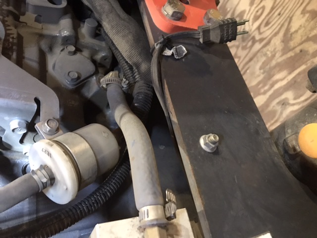

Hi-
After a bit of research I've concluded that I need to install a lower radiator hose heater instead of a block heater in my BX1860. I've found several threads on this, which are useful. That said, I'd like to know if anyone has installed one of these in a BX1860? Based on my research, it seems like it's going to be a bit of a pain given shape of the hose and the space (limited) available.
I'm also wondering where in the hose the heater should go to allow for proper heating as well as ease of use. I'm considering snaking the plug thru the 'firewall' and into the battery compartment (somewhere) so that I only have to remove the screen and plug in during the winter months.

My understanding is that the block heater, once installed in the BX1860, hits the muffler. The lower radiator hose heater is what Kubota says to use for this tractor.
I gave it a try today...it’s tight, and was a pain in the butt, but it’s now in. No leaks thus far and tractor temp seems ok. Coolant level held while working this afternoon. I’m interested to find out how it does over time. If I thought a block heater would work, I’d buy a replacement radiator hose and install a block heater, but based on my research, it just won’t fit with the muffler.

ThatÂ’s for sure; not much room at all! I may take it out and reinstall sometime as IÂ’m not 100% satisfied with it right now. Since itÂ’s still warm here in VT, it remains to be seen how well it will work.

When I bought my bx1860 in 2011 I had a block heater installed at my dealership. It is mounted at the front left of engine and is only about 2” square. It’s gets so hot my dealer said to only leave it plugged in for about 20 minutes. I have left it for a longer period than that as sometimes I start it when it is -30 it has never given any greave and the cord just hangs below the motor cover. It gets very hot and seams to work well.

No kidding? I was under the impression the muffler would get in the way; is that not the case? Can you put up a picture? If this is an option for me, with my bx1860, then that would be great!

If there was enough room in the BX engine, I'd probably do this - there just really isn't the room. I'm surprised Kubota recommends this as an option on the BX1860. I installed an inline heater (this involved a lot of swearing and cursing Kubota for the poor engine layout), but after doing so I found that it would be unlikely that the oil filter would come out without jostling the lower-radiator hose around and possibly causing a coolant leak. In the end, I took the heater out and replaced the lower-radiator hose with a new one. I'm hopeful that @kenbx1860's block heater picture comes thru as I would much rather do this.
