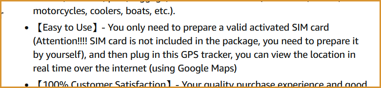

From among the top-rated tracking devices on Amazon, this one requires no phone LTE subscription and there is no monthly fee; it's just straight GPS. It does require a SIM card (purchased separately). The real-time location is accomplished using Google Maps.

There is no such thing as a GPS tracker that is, as you put it 'straight GPS'. This may be obvious, but a useful tracking device REQUIRES a reliable wireless data path for the location data to get back from the device to you. And that path is likely to be cellular.
The SIM card is essentially a paid 'ticket' to use a cellular network, and the fact that this device puts that burden on the user is a turn-off, for me at least.

While the device itself may not require a subscription from the vendor, I note the following in the description:
"You only need to prepare a valid activated SIM card (Attention!!!! SIM card is not included in the package, you need to prepare it by yourself), and then plug in this GPS tracker, you can view the location in real time over the internet (using Google Maps) "
I'm not aware of any way to get an activated SIM card & service for free.

Yes there is no free lunch here. You either need a satellite connection, a SIM card or a Bluetooth or Wi-Fi connection to a device that will relay the location to your device. If your machine is not in an area with cellular service or near a device it can connect to any of these style devices will be useless.
There are a number of trackers that you can install that will connect to battery power and will transmit the location using a sim card for a couple hundred bucks a year subscription. This is probably your best alternative

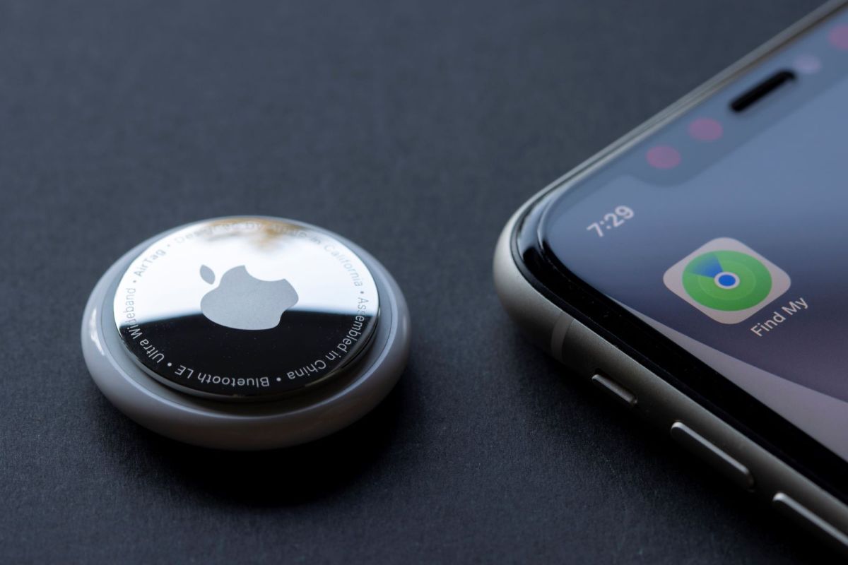

What about one of them apple air tag things?
Know nothing about them.
Aren't folks tracking stuff with them these days?

Thanks for the replies. Yes, you are right about the SIM card being essentially the hardware behind a cell phone subscription. I don't know what I was thinking. Maybe I was thinking about SD cards like the ones you'd put in a camera; those are just flash memory.
I asked Grok about this. Here is the link to the Grok. The answer is too long to post here:
He recommends SpeedTalk Mobile. The plans start at $5/month for 100MB of data. I have no idea how much data one of these SIMs transmits during a month

My daughter and son-in-law gave us two of those for Christmas. They had in mind that the Apple tags would be installed in the cars, I think. But, yes, there's no reason one could not be placed in a tractor.

I believe they use low-energy bluetooth to connect with an Apple phone. The range of the tag is very limited, same as any other BT device.

You still need connection to a compatible mobile device to relay the information to your device. No compatible devices within the range of the tag and no location updates.

I'll chime in: Another tool in a combo strategy that can help - nothing is foolproof.
  • Need BT proximity to ANY active iPhone.
  • I use on old school classic cars, (combined with agreed value ins, common sense, and other disabling ) Also have on wayward dog, luggage. Note: Pro thieves use rollback and are gone in min.
  • They now warn anyone with iPhone that the tag is "following" them and will sound a beep to locate & prevent nefarious use.
  • Counter is to really hide and disable/remove the speaker
  • Battery last 1-2 Y and is replaceable
My Own Conclusion: cheap ($25) and better than nothing. Didn't think about the tractor but good idea JIC. I would have a much bigger problem if hit here at home.

As already pointed out, Apple Air Tags will alert others that there is a tag nearby. That can either get them to stop, or get them to flip on the GPS jammer, locate it, etc. Tile has a similar tracker that works with all smartphone platforms. They also do not notify others that a tracker is with them...unlike Apple.

As per above, AirTag is def not a commercial option
However, a big PRO is that GPS jammers have no effect on the BT LE signal from the tag.
Again, they will know it's there, but if there is no speaker/sound and easily well hidden, it MAY cause them to abandon ship or look elsewhere. They are not going to locate it quickly or without major disassembly!
Like it or not, there is a high percentage of iPhones in use, so odds are good it will signal position eventually.
