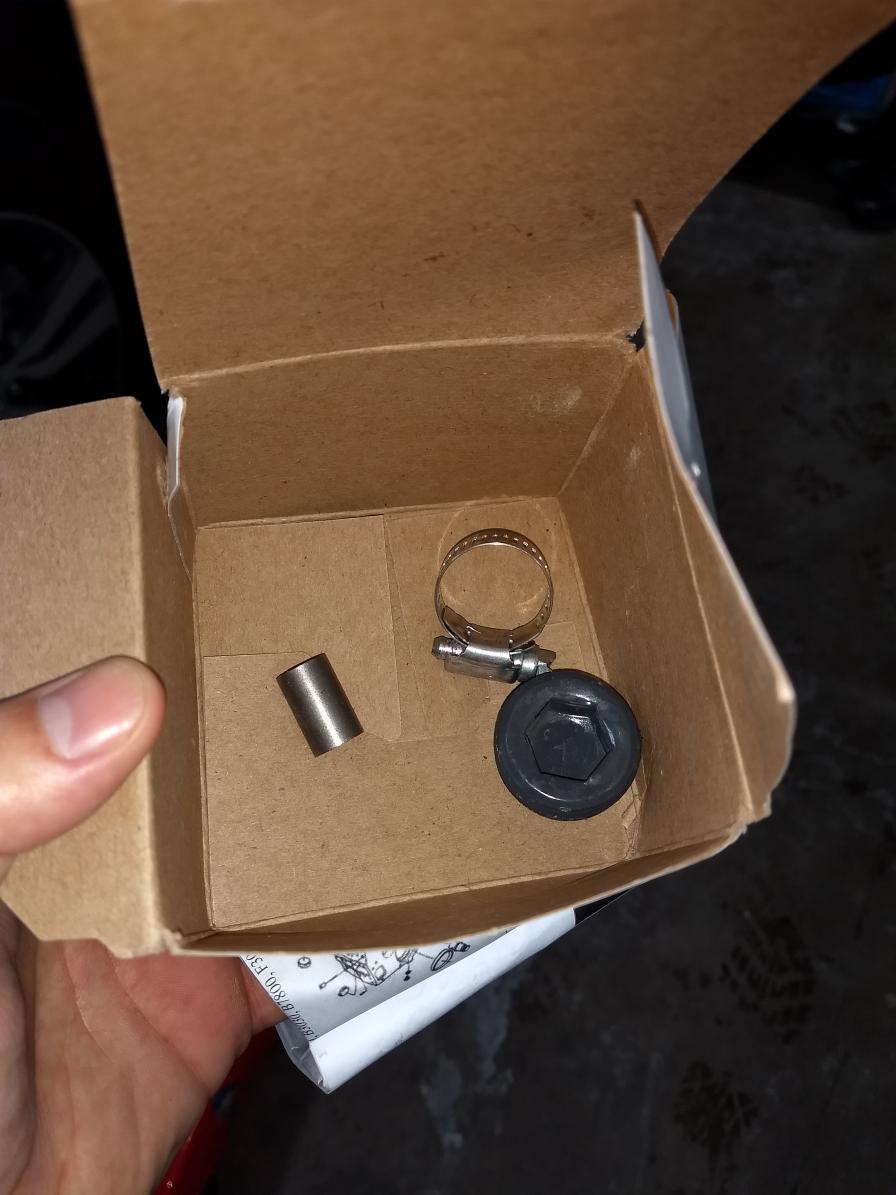

Here is the block heater, they cover several models with the same heaters, I'm guessing the hose clamp and chuck of round stock was for a different model because the instructions didn't mention anything about them for my b2620

I just picked up the same engine block heater pictured by the original poster for a B2601.
Does anyone know what the little metal slug is for? (See OP's picture) It is not made of aluminum or zinc, so I don't think it is supposed to be a sacrificial anode. It looks like steel, but not magnetized. It does not fit into any of the other pieces.
The instructions included with the kit are for another engine and they don't mention this little slug. The dealer didn't know what it was for- this area is not known for needing engine block heaters. My only guess is that you are supposed to use the hose clamp to anchor the slug near the NEMA 5-15 plug end so it is weighted down and won't flop around and get into the fan or other moving parts.

If the piece of metal is solid, I think it might be a plug for the bypass hose under the heater opening.
I wouldn't use it. ;)

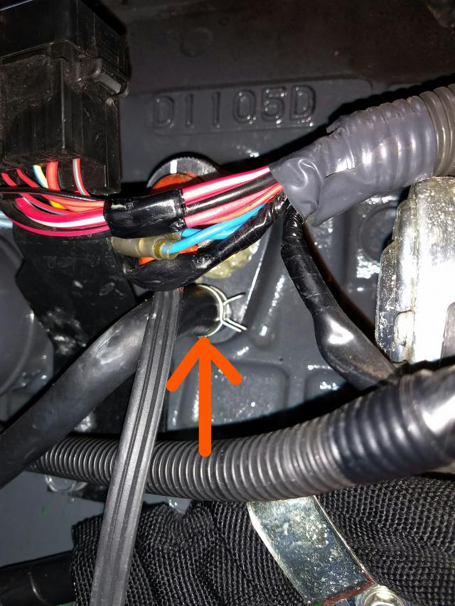

Definitely a solid plug. I was about to hand-over-hand that hose just below the heater port to see if I could figure out what it is (shown in another one of the OP's pictures above). You say it is a bypass hose? I assume a coolant bypass hose? What component is it bypassing? That plug looks like it is just the right size for that hose/port.
One of the random manuals I found for the engine (or similar engine) shows a coolant drain plug in that spot. I definitely won't use the kit plug unless I can figure out what it's for.

I believe that some older Kubota engines the pipe plug you remove with the 17mm hex bit had a fitting through the center and the black hose that goes into the block went into the pipe fitting. The solid steel plug was to seal the end of the black hose as it could not go back into the engine because of the block heater and is not necessary to enter the engine block for its function as radiator drain.
The kits are universal and all seem to include this mostly unnecessary solid plug and hose clamp.

What you guys are saying makes a lot of sense- a lot better than my guess about the slug/plug being a weight to keep the cord out of the fan! I can just imagine the cord and slug getting caught in the fan. That would be an exciting few seconds! :eek:

Are you talking about the small hose under the heater?
Your supposed to cap that hose when you put the heater in it i do believe.
Pictures would help! ;)
