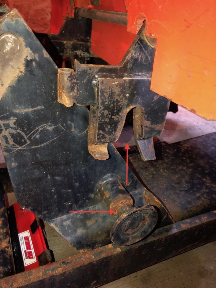

I recently purchased an L3710 with a loader and a back hoe attachment. I managed to get the loader off (I'm sure I didn't do it correctly - not pretty =- but it's off). I need help attaching the 2052 blower.
I've got the unit hooked up to the mid-PTO (all shafts and the pin), but I am having an issue with how the black unit attaches to the front of the tractor. There is a "U" shaped bracket that looks like where it needs to go, but I don't see what would keep it in place (from falling down). Maybe I am missing a part.

Thank you for the advice, sir. I should've thought of that. Here are a few photos of the area I am talking about, as well as the pinned portion further underneath the tractor.
As you can see in the photo- it looks pretty clear that the attachment should move right up into the bracket, but how does it get held in?
If possible, I was curious if it mattered what ports I plug the hydraulic lines into. Right not, I have the two lines from the hydraulic lift in the inner ports and I was planning to connect the blower directional controls into the outer couplers. Does it matter? Is this (in)correct?

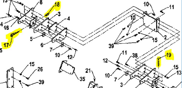

You should have 2 pins (19) and 2 sets of 2 half bolt sections (17,18).
that is what holds it in the V slot.

Thank you! I googled the manual on the 2052 but never found the image you posted. Thanks for the highlights, as well. Thank you again, sir.
