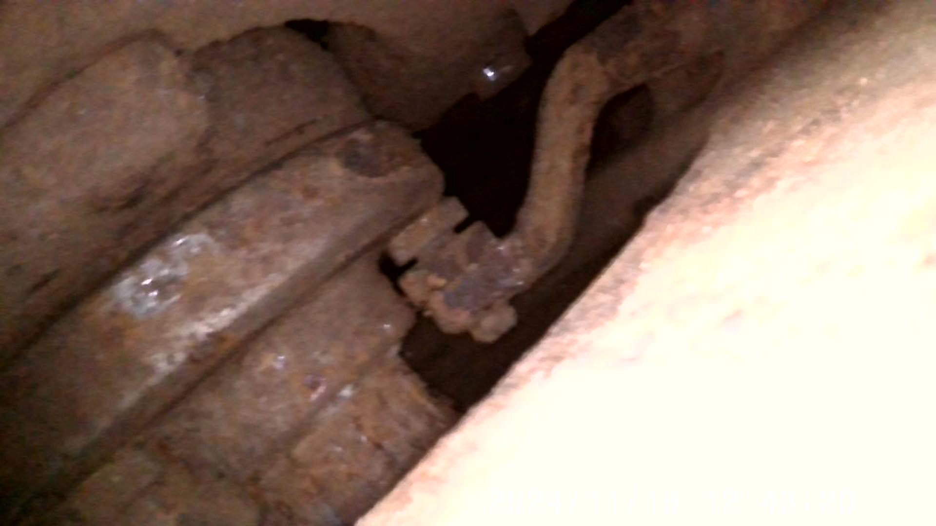

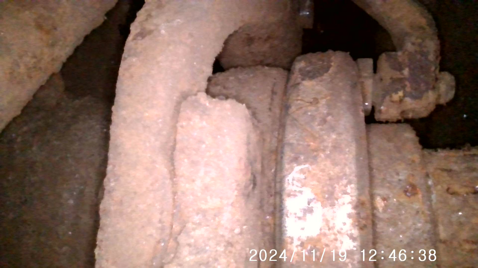

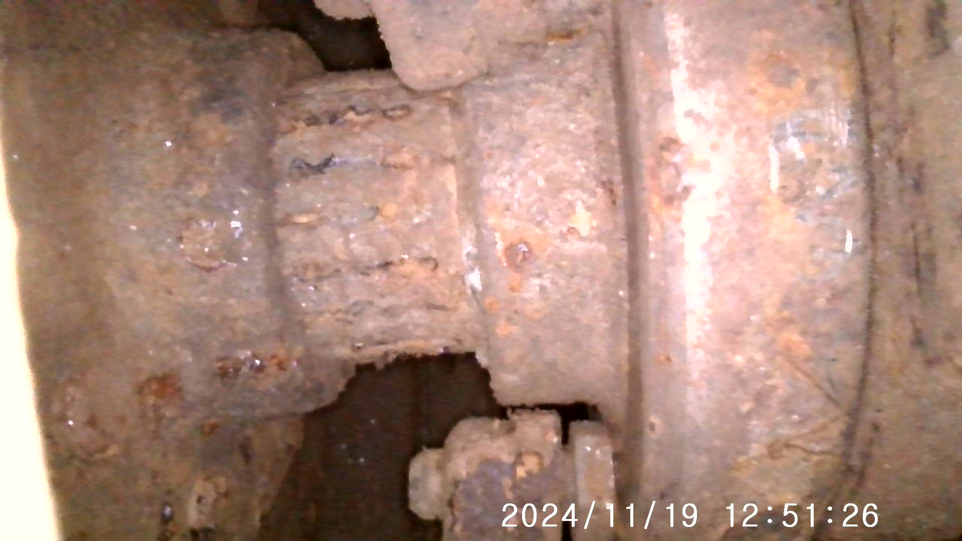

Just wondering if anyone has any insight into splitting an L2250 , Mine has been sitting for around 6 months, and the Release Bearing seems to be frozen, I cannot actuate the clutch, it is stuck in the fully engaged position,
I have tried the obvious things , I just got a scope to see inside the bell housing thru the breather tube access point on the right side of the tranny, (after removing the tube plate) I will try to use a thin pry bar (only about an inch clearance between the case and the Daul Clutch that is just inside the port, also hoping to be able to get to a grease zero that I see on the release bearing, But not to hope full, (but maybe I'm wrong)

Yes I've tried the obvious stuff ,yesterday I scoped it and it is rusted completely ,It is apparent it has to be split,

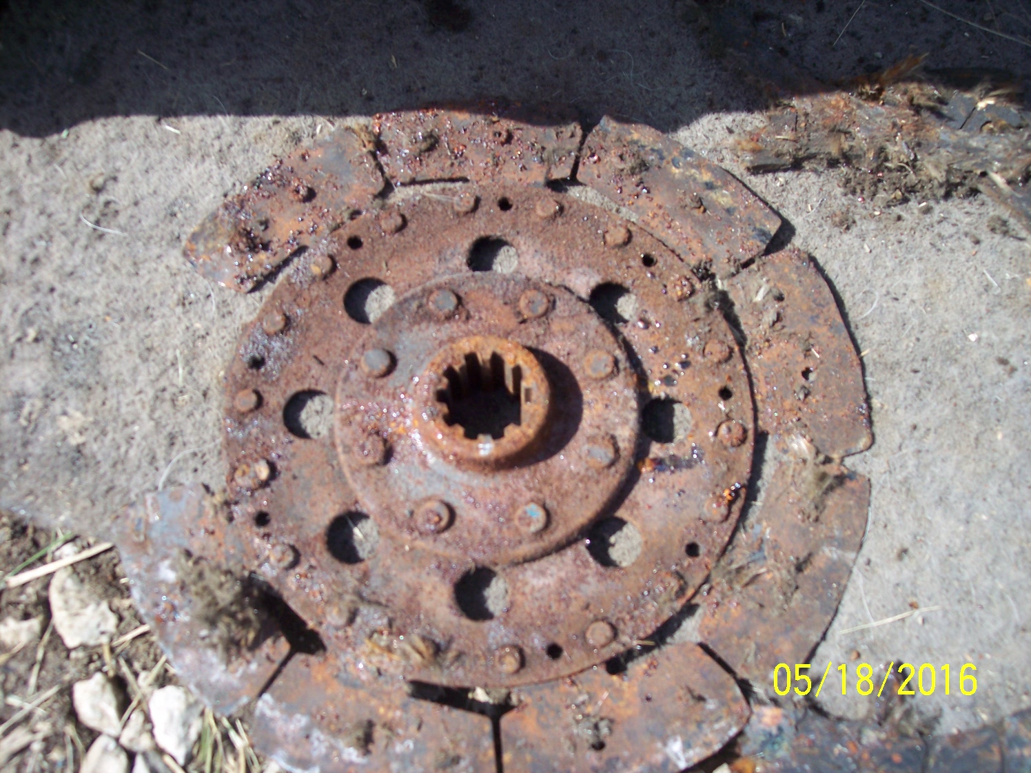

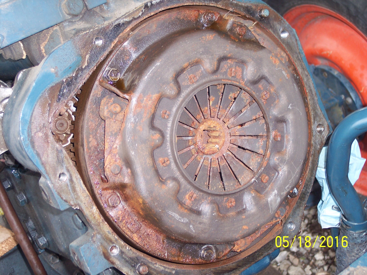

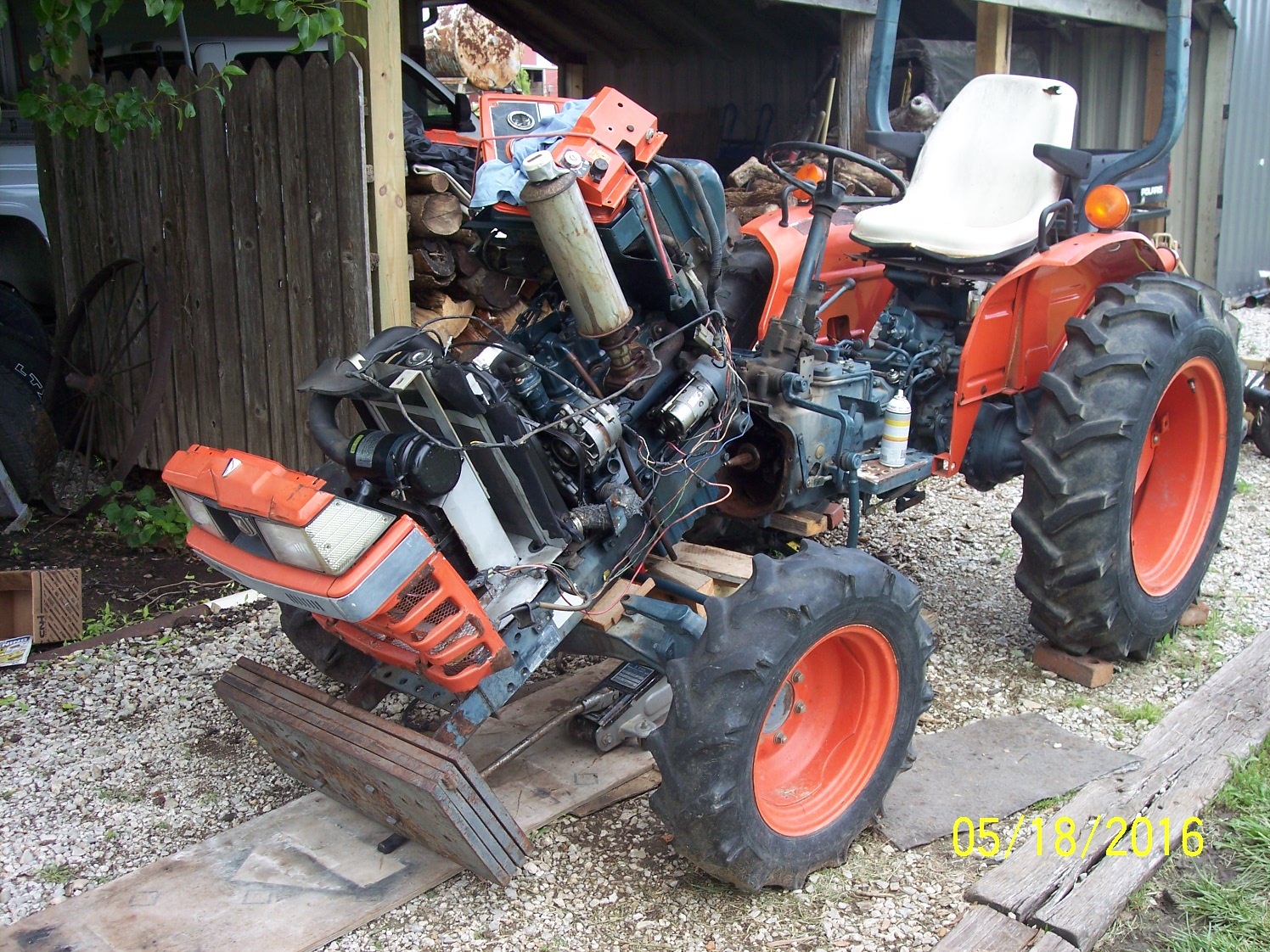

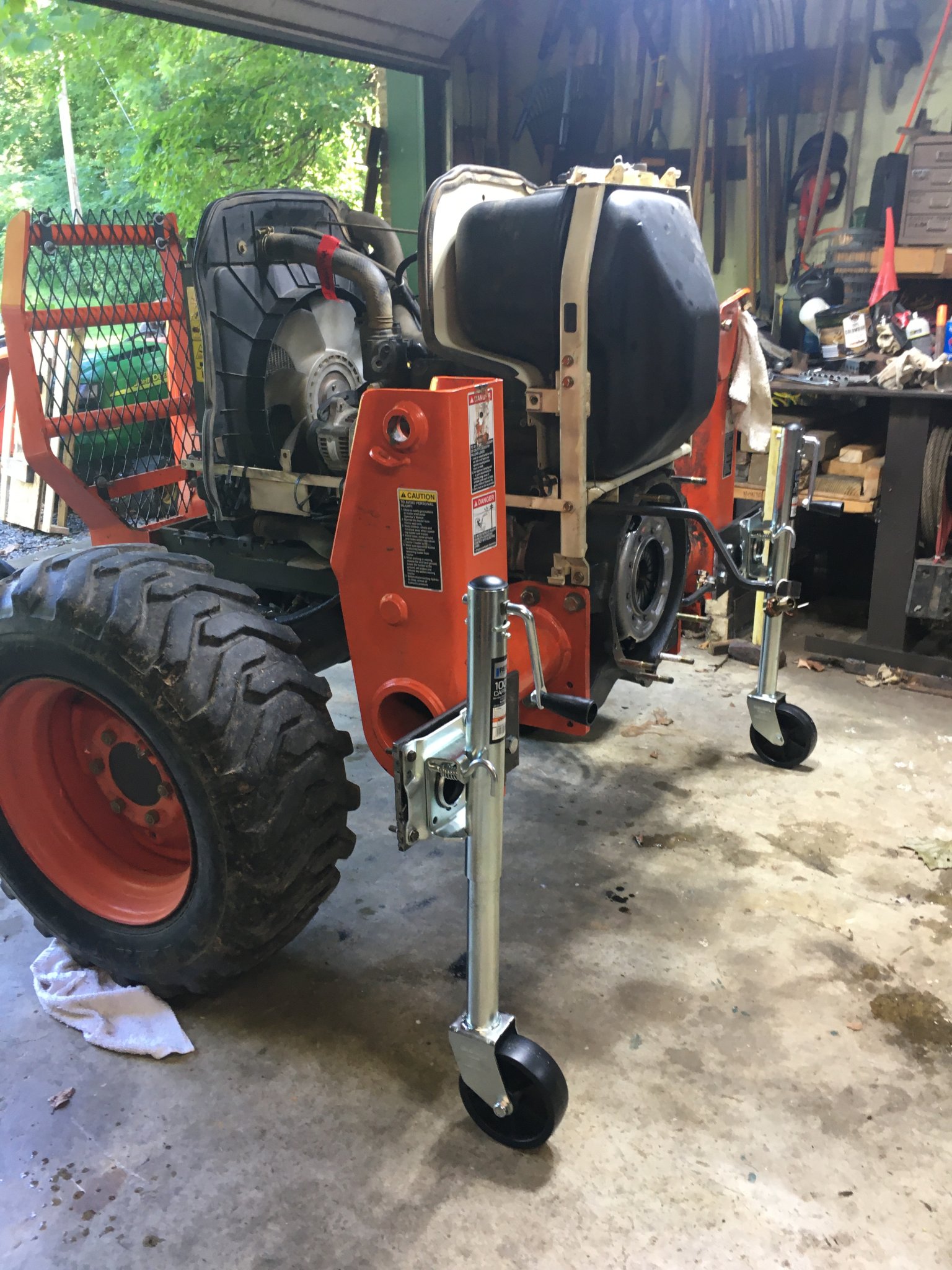

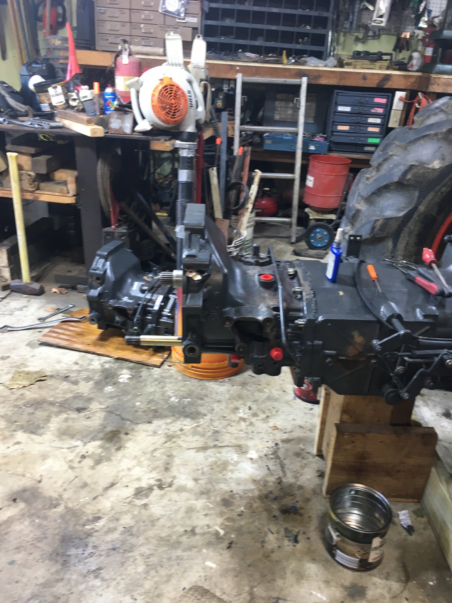

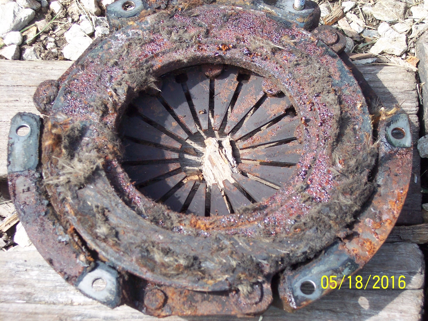

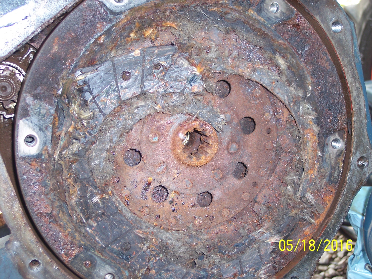

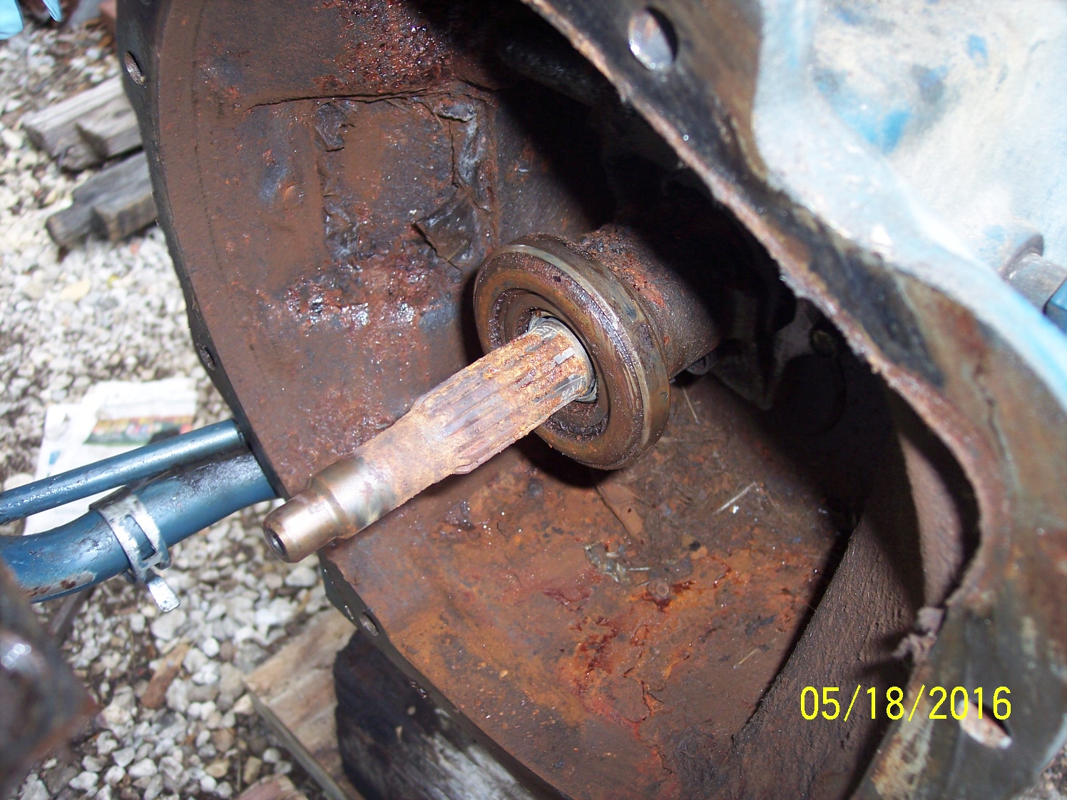

I bought a tractor with a similar problem. It wasn't in a flood, but water leaked from the a couple freeze plugs, got into the oil pan, froze and busted the pan. I split it while setting outside. The tractor had a weight on the front which I did not calculate and when separated it did a nose dive!! Here's what the clutch looked like.
When you separate the tractor have the rear wheels blocked and a support under the transmission. Be sure to have a block of wood wedged on both sides of the engine and the front axle. If you neglect this the engine will flop to one side or the other when unbolted.
