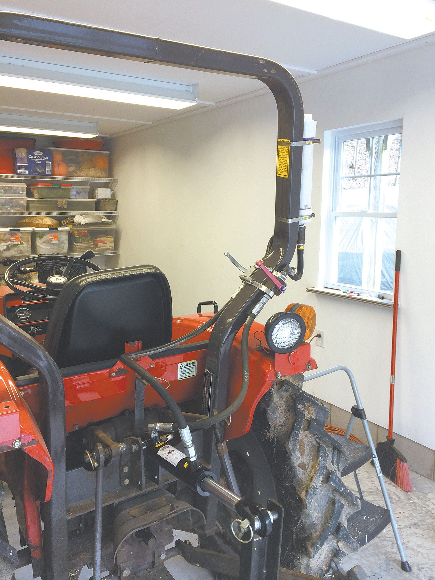

Inexpensive adjustable top link
9,489
4,968
Just an idea.
From my point of view not a particularly compelling idea. The adjustment process is way to limited and cumbersome plus the cost savings are minimal.
Ditch the reservoir and ball valves, mount a cheap directional valve in that spot and run three hoses to the tractor hydraulics. No need for backing up to banks or ledges to reposition the angle and you can do it while sitting still or tooling along in forward or reverse.
