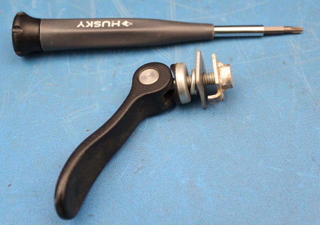

I got a question by PM from somebody who ordered a cam lever and wanted to know what tools they'd need to bring when they go to their property where their L2501HST lives. I just took mine off the tractor without any tools so I could remember how it goes together and post a picture.
The screw in my cam lever can be adjusted with either a small flat bladed screwdriver or a T-15 Torx driver. Different cam levers might require a different tool. The original thumb screw can come out without any tools, and the cam lever can also come back out without tools. The driver is just needed to adjust the cam lever screw when (re)installing it.
The back side of the sheet metal plate that it mounts on is accessible without disassembling anything else. No tool should be needed for the piece that the thumbscrew or cam lever screws into.
