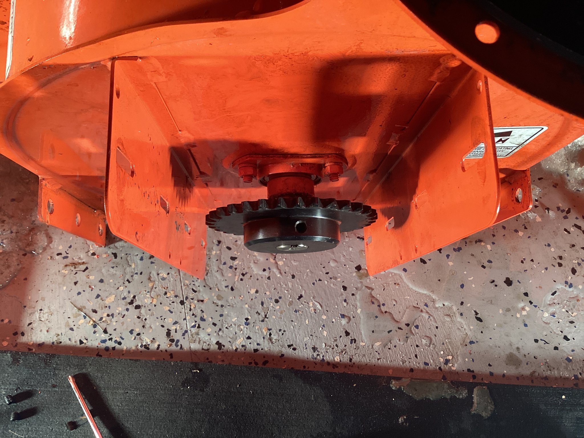

First of all thank you all for all your suggestions, tips and help. I feel like I’m 99% there. I tapped the impeller fan free yesterday and it spins freely back and forth until it contacts the housing. I’ve got the entire back of the blower disassembled and I removed the reduction box and chain. Where I am stuck is in removing the upper sprocket. It pulls out to the end of the shaft and stops. It feels like something is holding it there. Is the 1/4 key holding it in place? Do I perhaps just need to go get a gear puller to pull the sprocket off? I plan to repair the impeller for now. I might eat my own words but the blower vibrating a little is going to be less annoying then paying ~$250 for a new fan, plus whatever the Alaskan markup is on it or the shipping to get one here from the lower 48. Thanks again.

Many times there will be 2 set screws, and I suggest removing them both, not just loosening them. Push the sprocket back on and feel the end of the shaft with your finger for any burs. If so, take a file to the end and round it off a little. As long as the sprocket is sliding on the shaft it should be loose, but if it won't come off easily I would use a gear puller on it. If you have one of the national branded auto parts stores near you they will have a gear puller that you can rent for free. You pay the value of the puller and when you return it, they give you your money back. You can also try to put a piece of wood behind it and use some leverage to see if it will pop off. Possibly even a spray of penetrating oil might help. Time to get creative. Just don't forget to put the key back in when reassembling it.

GREAT you're really,really close and WHY is it so CLEAN ????
Sigh, I never get to work on anything that clean..... :(
Here's what happens.. When the setscrew is rammed TIGHT during the install, it mushes a wee bit of the 'key' that's in the grooves of the shaft and pulley causing the binding that you have. It's no longer square. It's surprising how little 'bent metal' can cause grown men to increase their vocabulary !
The problem with a gear puller is that it HAS to get around the sprocket and close to the hub to pull. If the finger only gran near the teeth, it'll bend the sprocket.
What I found works 99.44% of the time is to place a few large combo wrenches and a 'pickle' fork between the sprocket and the bearing, Tap on the pickle fork and the sprocket comes off,nicely, no damage. This is also how I get pulleys of riding mower engines that have been there for 20-30-40 years... Yes 'fun' holding 2-3 wrenches,fork and tapping the hammer....
When you do get it apart, run the key back and forth on a fine flat file to remove the slight 'burr' and to 'true up' the square sides. Adding a SMALL amount of neverseize will help next time....

I noticed in your pictures that the key seems to be sliding with the sprocKett along the shaft. That indicates that the key is stuck to the sprocket.
I think that the key is bent so that the sprocket doesn’t want to slide off the key. You may have to put more force on the sprocket to get it removed. I would recommend you replace the key during the repair

The setscrew has 'mushed' the top of key, binding it to sprocket.
Use a drift to tap it to the back and sprocket will pull off.
May take 1-2-3 'tappings' but it'll come off, probably quicker than me typing this reply.

It took me a while to have the time to get back to this project but I am happy to report that it is compete and the blower is running great. The punches and gear puller were definitely the items missing from my toolbox to make this successful. I appreciate everyone’s wonderful suggestions and support through this process.
