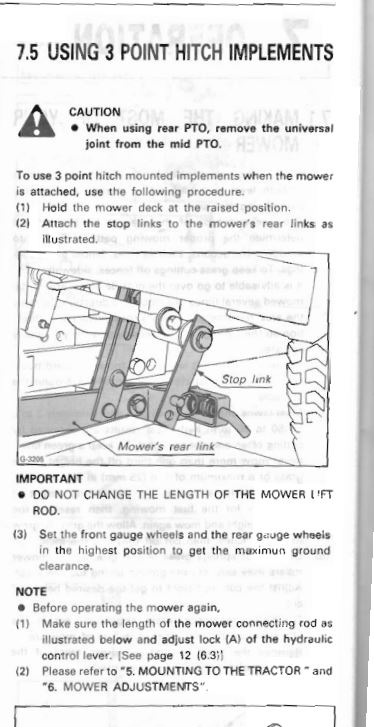

Hello KubotaEd,
Your deck may have "lock up" capability. This holds the deck in a fixed raised position while you raise and lower the three point hitch while using rear mounted implements. I do not know if the following is applicable to you, but it is worth a look.

Thank you for providing this information for me. My deck doesn’t seem to have this option.
