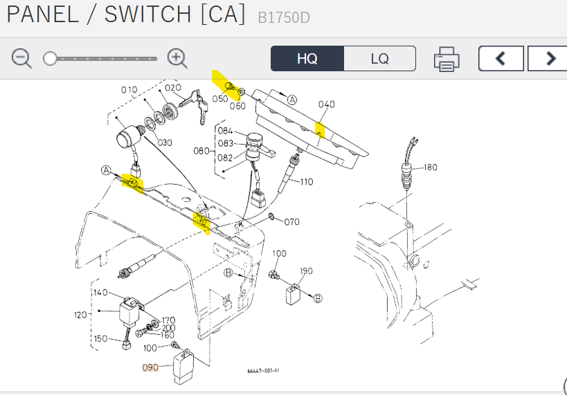

Does anyone have information/advice about how to replace the ignition switch assembly in a B1750HST Diesel Kubota?

You can look at the illustrated parts list and see if that shows you how to get the dash apart to get to the switch.
The switch will probably have a large round nut that will come off the key side of the switch and the switch will go out the back.

Thanks Russell _ I'll find the parts list and see if it provides some info on accessing the wiring assembly. It isn't apparent from looking at the tractor itself.

Pull the dash and you'll be looking right at it.

Disconnect battery cables before you begin.🔥
